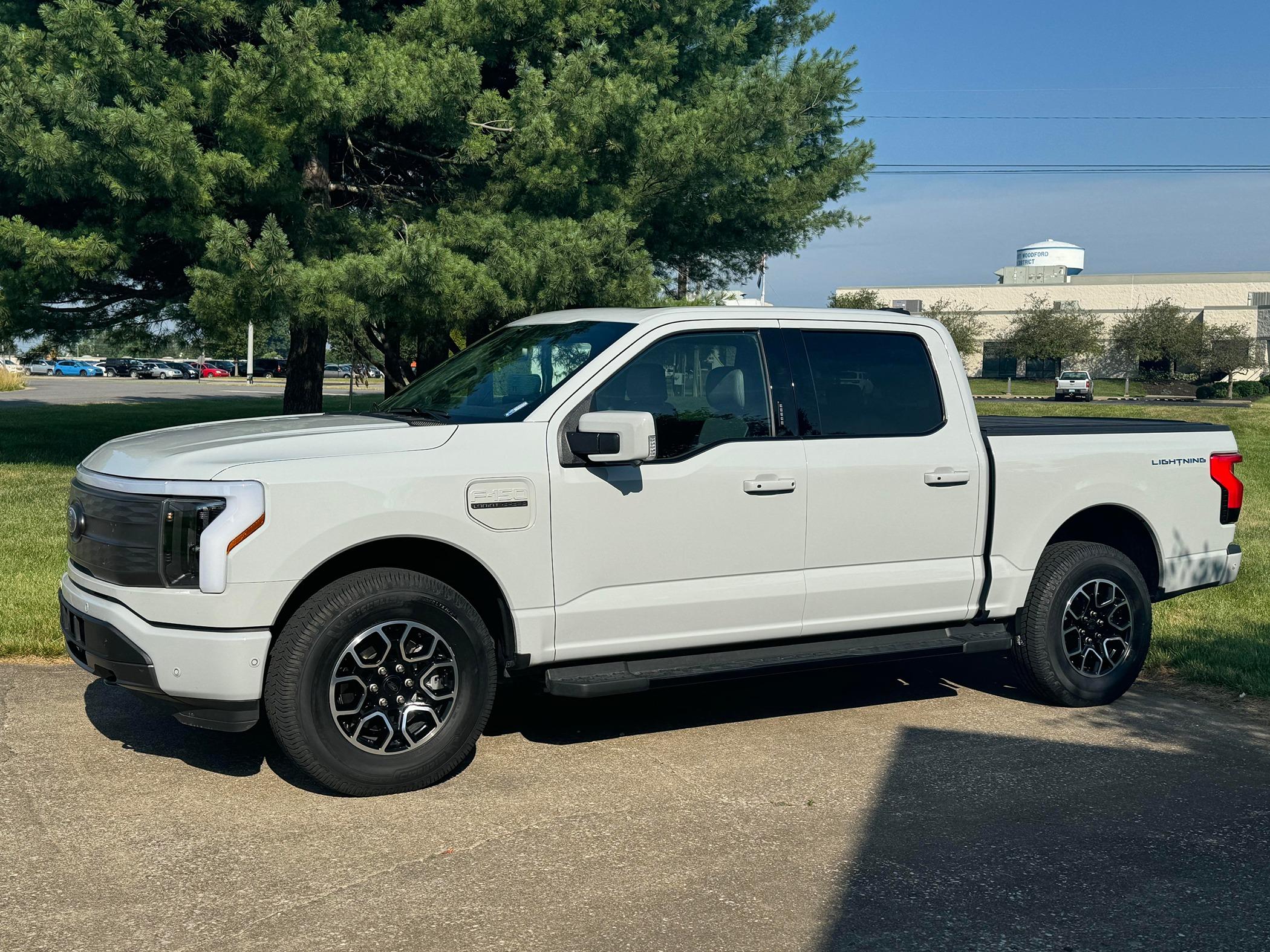

Well I went with the 275/70r18 load range E. I think it looks a lot better. The 275/65r18s looked a little small. Only 50 miles on them so far and ride seems to be the same. Speedo is now dead on. No interstate driving but mi/kwh seem to be about the same.
We love it, Mark! And that is a stunning F-150 Lightning! Thanks for sharing.
