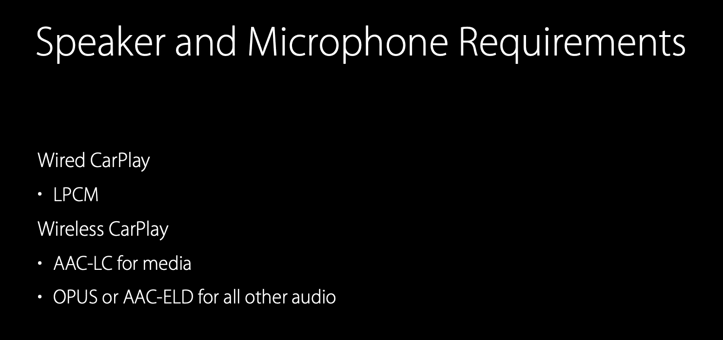

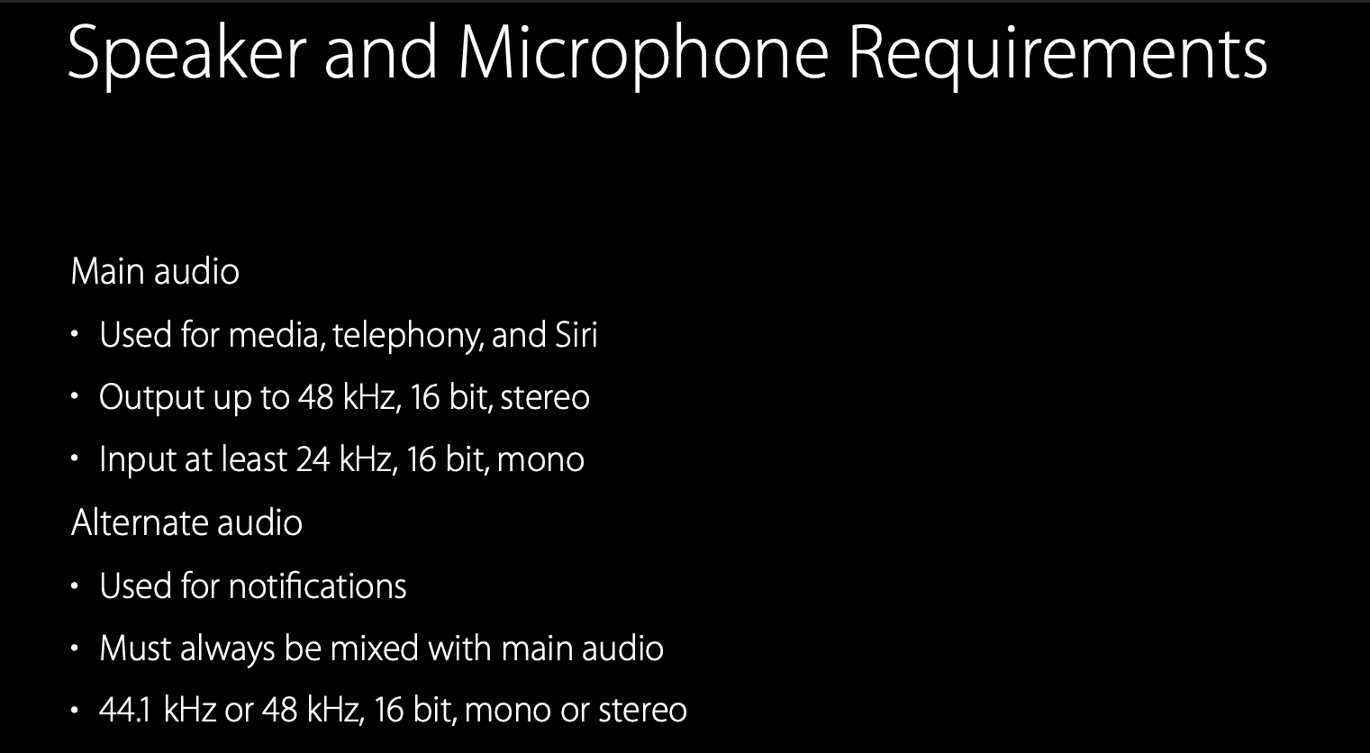

I found a presentation dating back to 2016 and wired CarPlay uses LCPM at 16/48 but Wireless CarPlay uses AAC. So in theory using Wired CarPlay will max out your trucks capability.
Ford F-150 Lightning No 3.5mm Aux In for Hi-res music? 1622072741975
Ford F-150 Lightning No 3.5mm Aux In for Hi-res music? 1622072756992

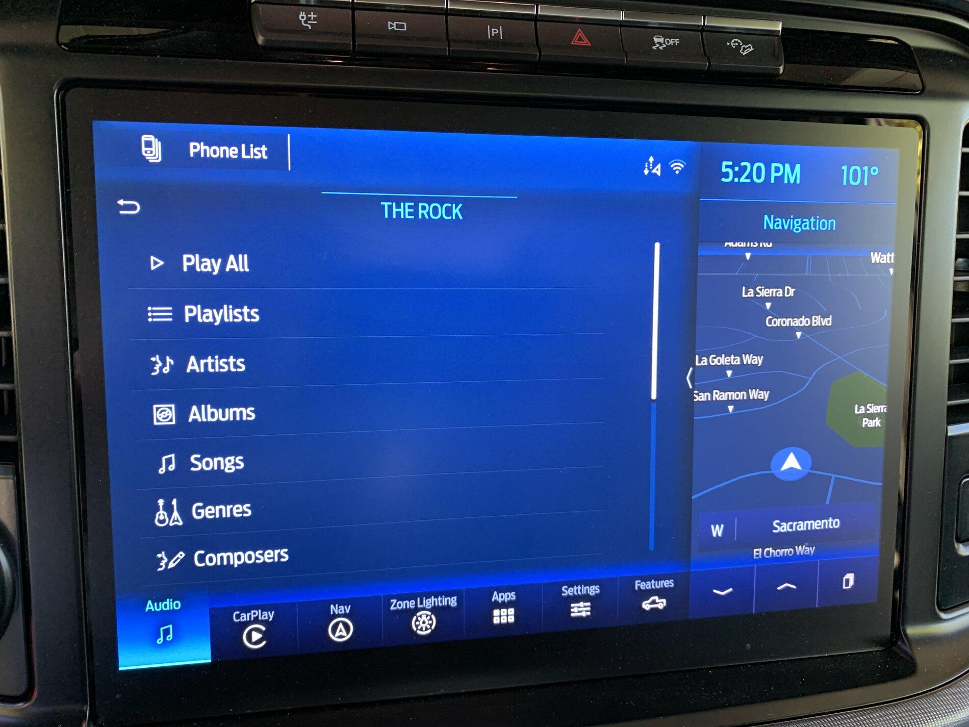

I thought this at first too. Seemed like just a jumble of songs. Then I read a review on MacRumors that talked about the nice file system. The key is, after selecting your USB source, to click on browse. That brings up this menu:

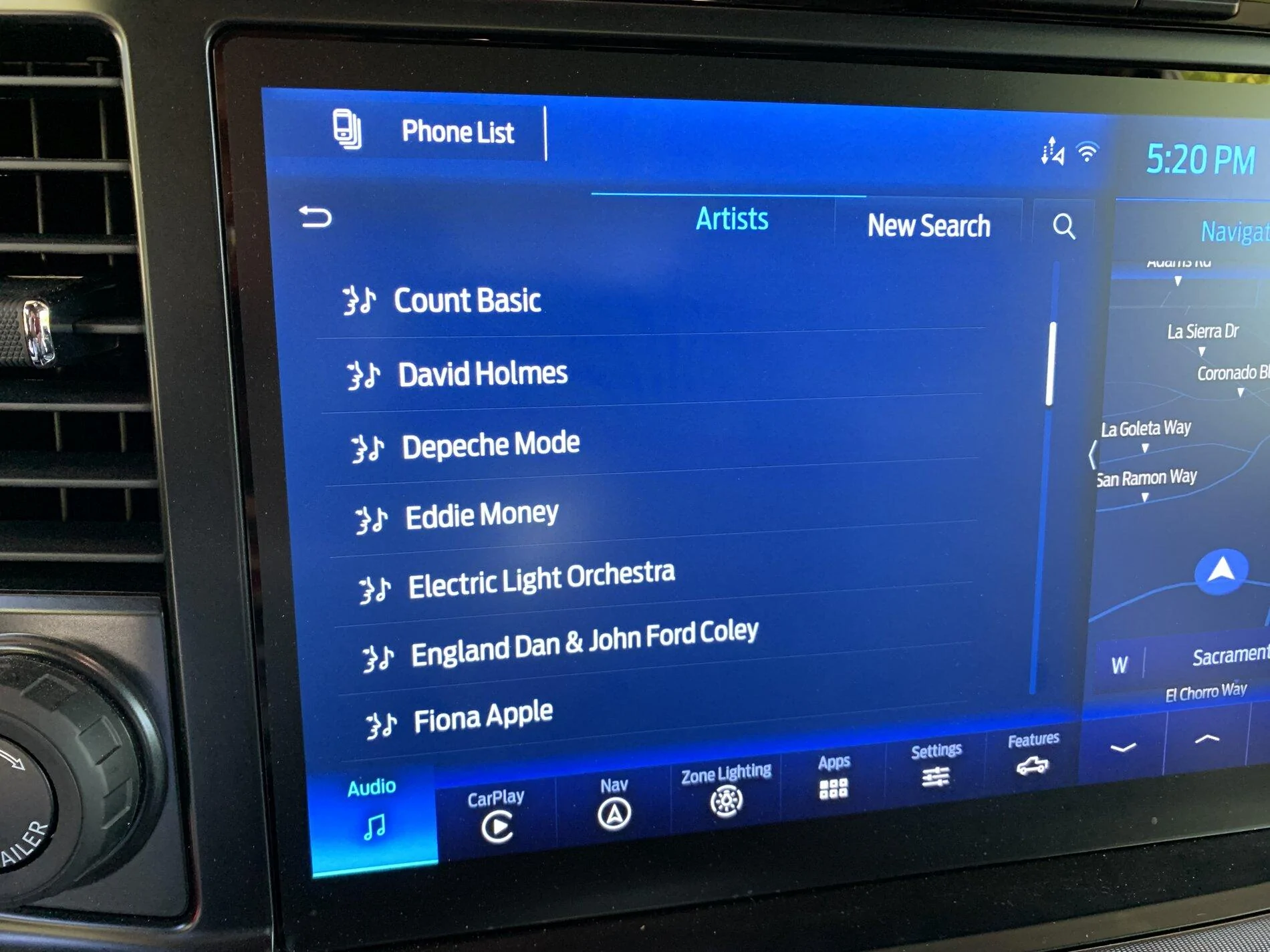

you can then for example. select Artists and get this:

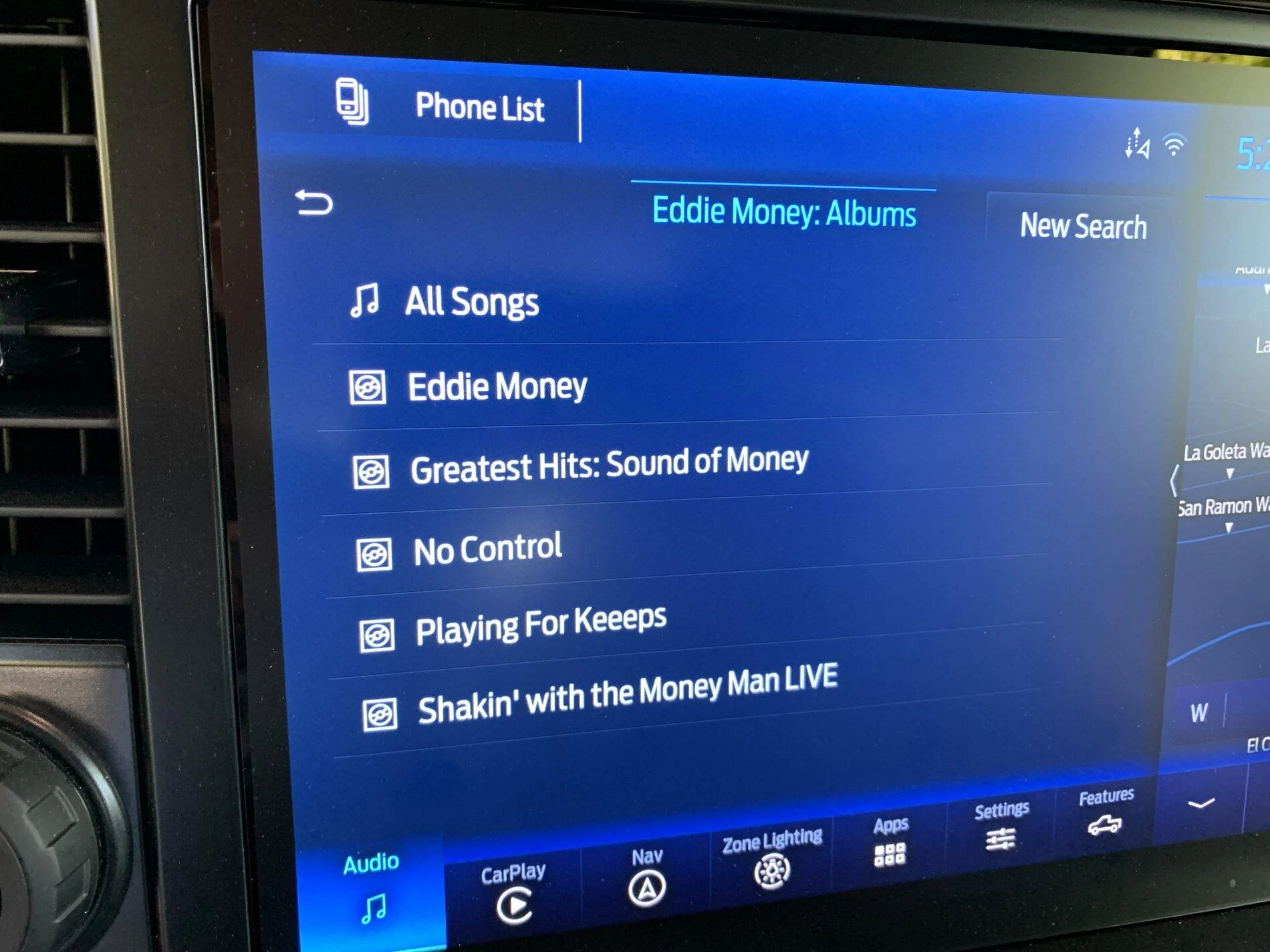

Click on the Artist and get the list of albums.
