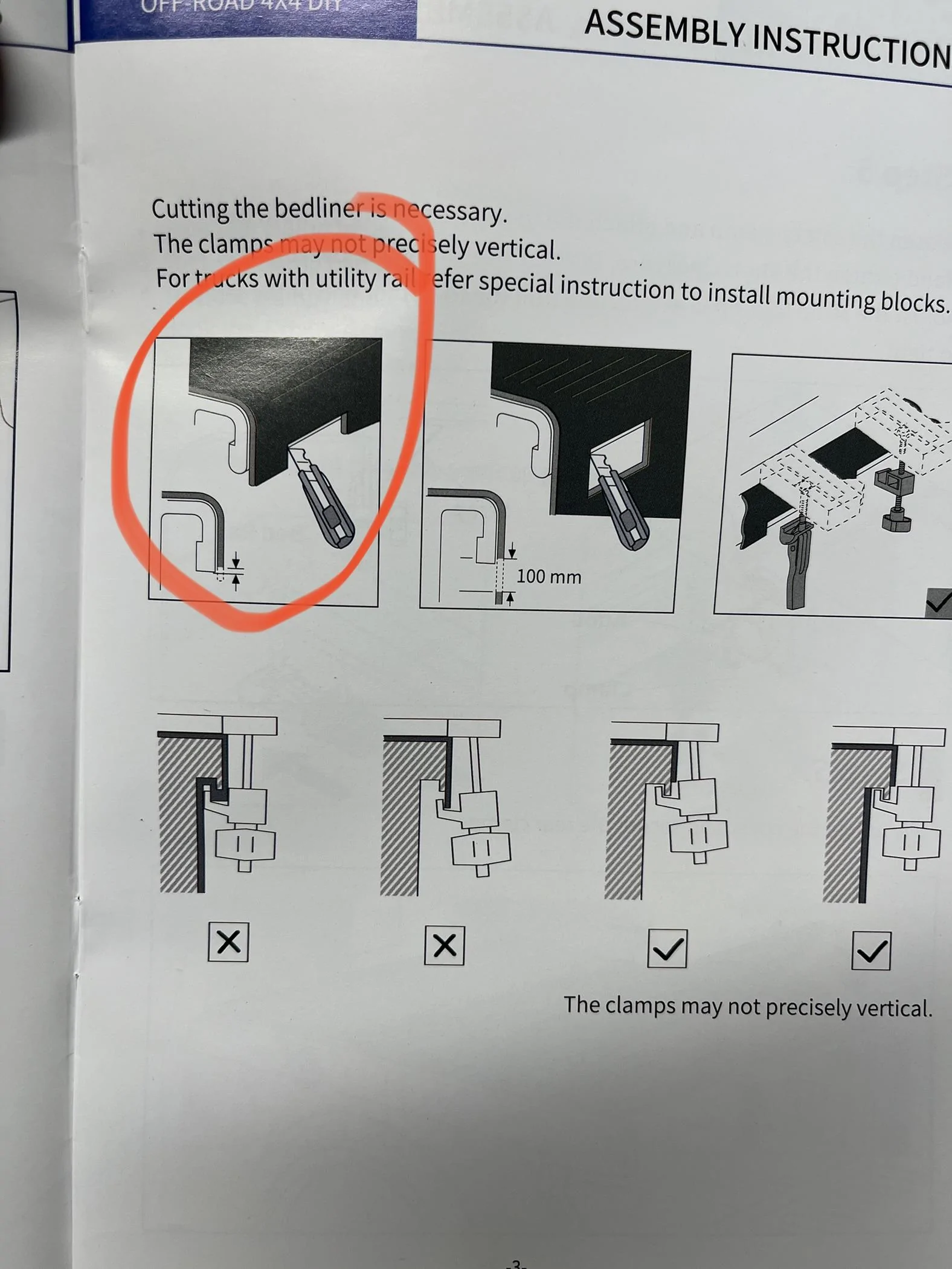

So I bought a Oedro trifold vinyl bed cover from Amazon.
I was going to install it today but I found in the directions that it would require me to cut the bed cap.
So that it would grab metal instead of the plastic. Has anyone found one that you don’t need to modify the bed caps?

I don’t have a lightning but installed similar cover on an older f-150 and don’t have to cut it even though the instructions indicate otherwise. Check how much the bed cap overhangs before cutting.
It overhangs maybe 1/8 to 3/16ths. So it would be that plastic rail cap that the clamp holds onto.
The clamp arm isn’t long enough to reach under the rail to the metal at the top of the bed.
Having never put one of these on, that may just be they way these things go but I just can’t cut a new truck for that.
