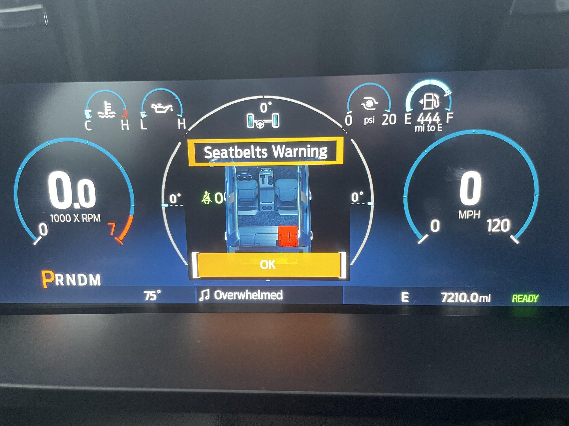

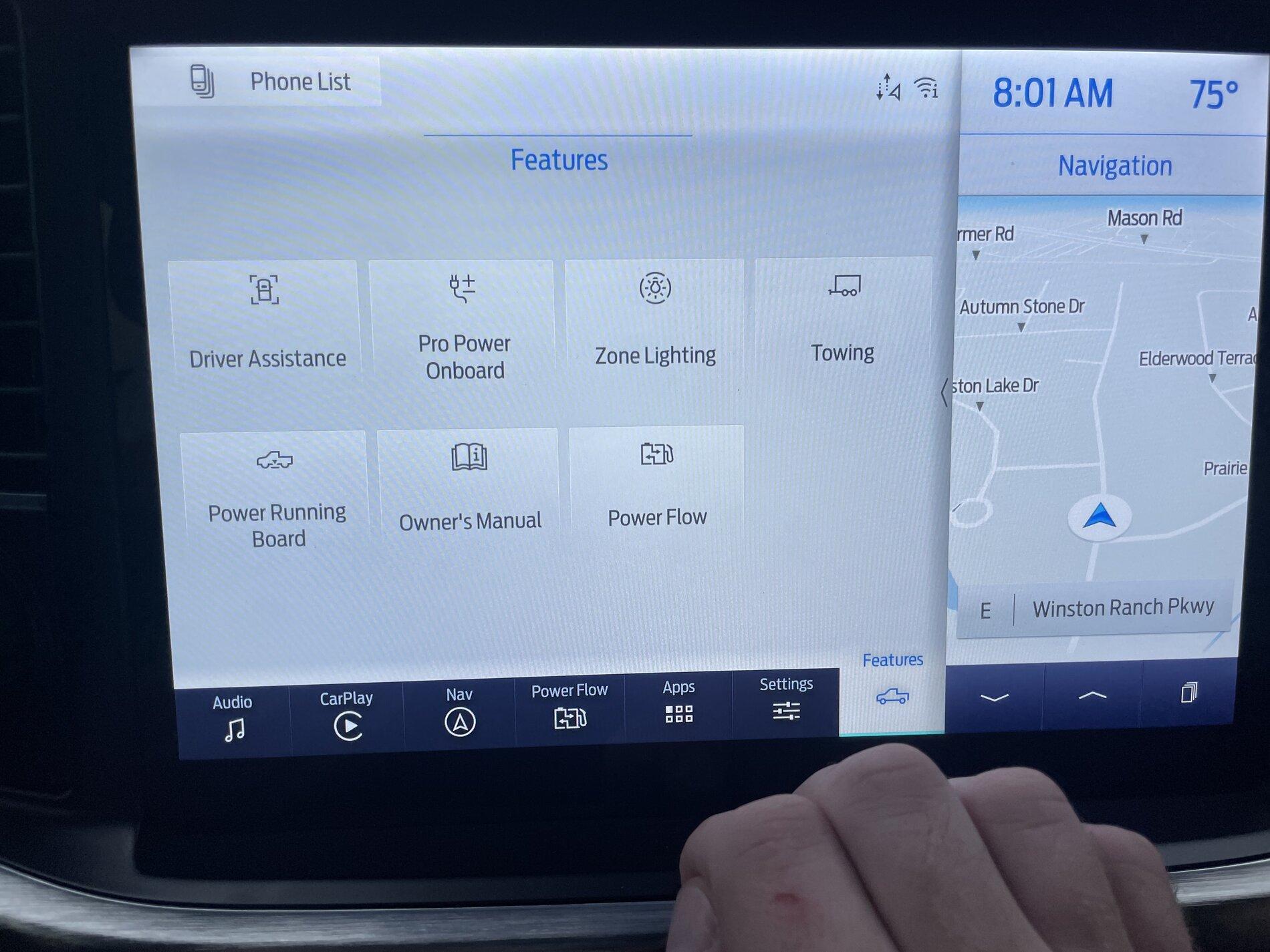

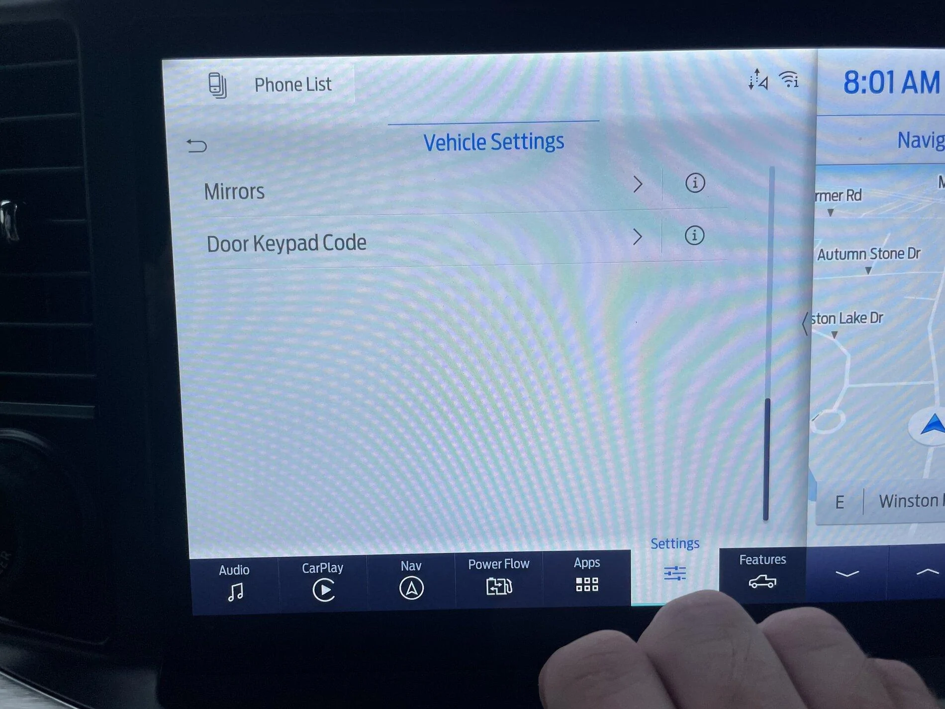

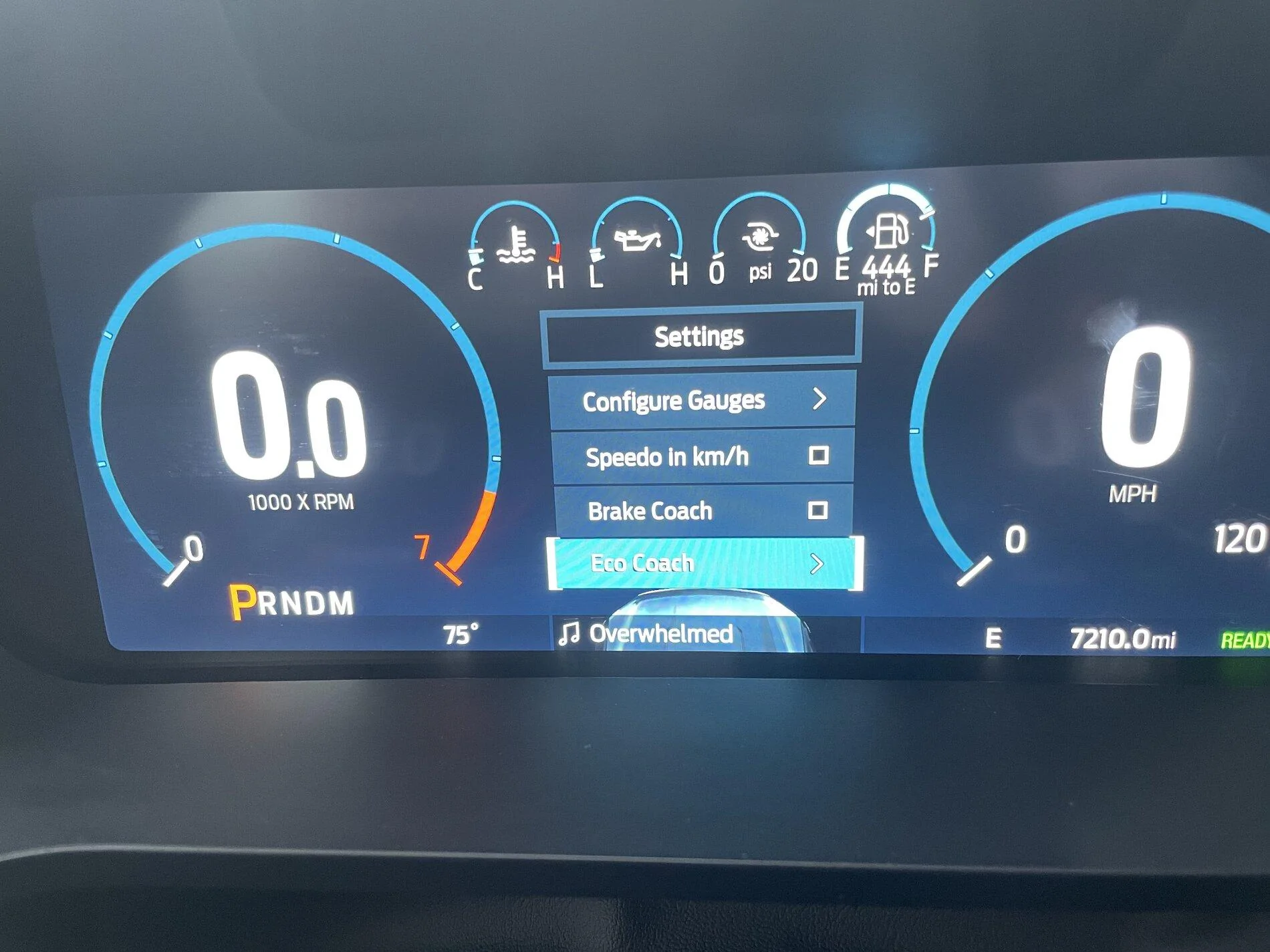

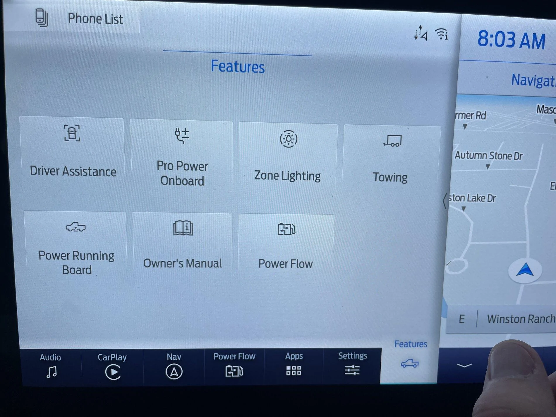

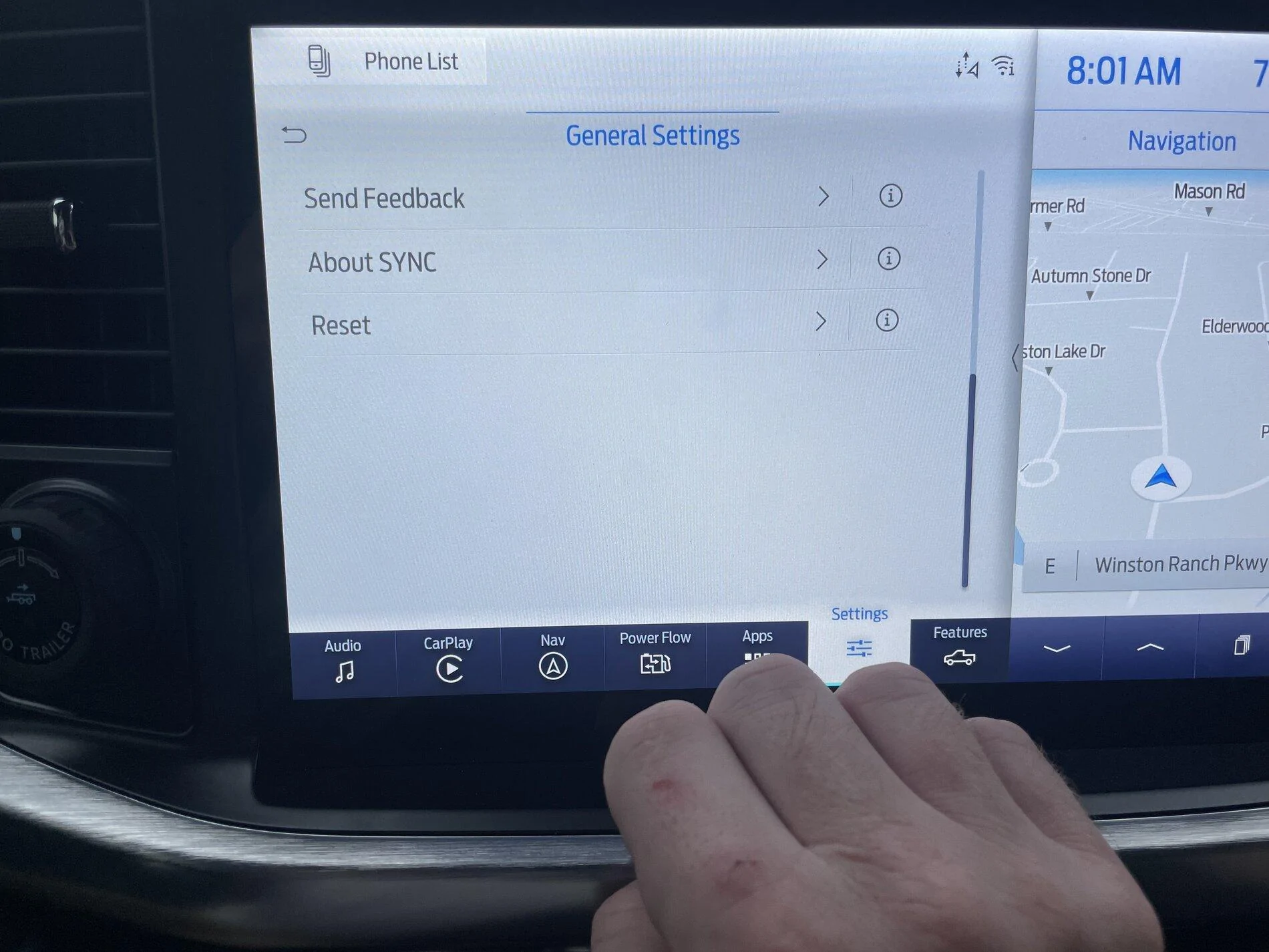

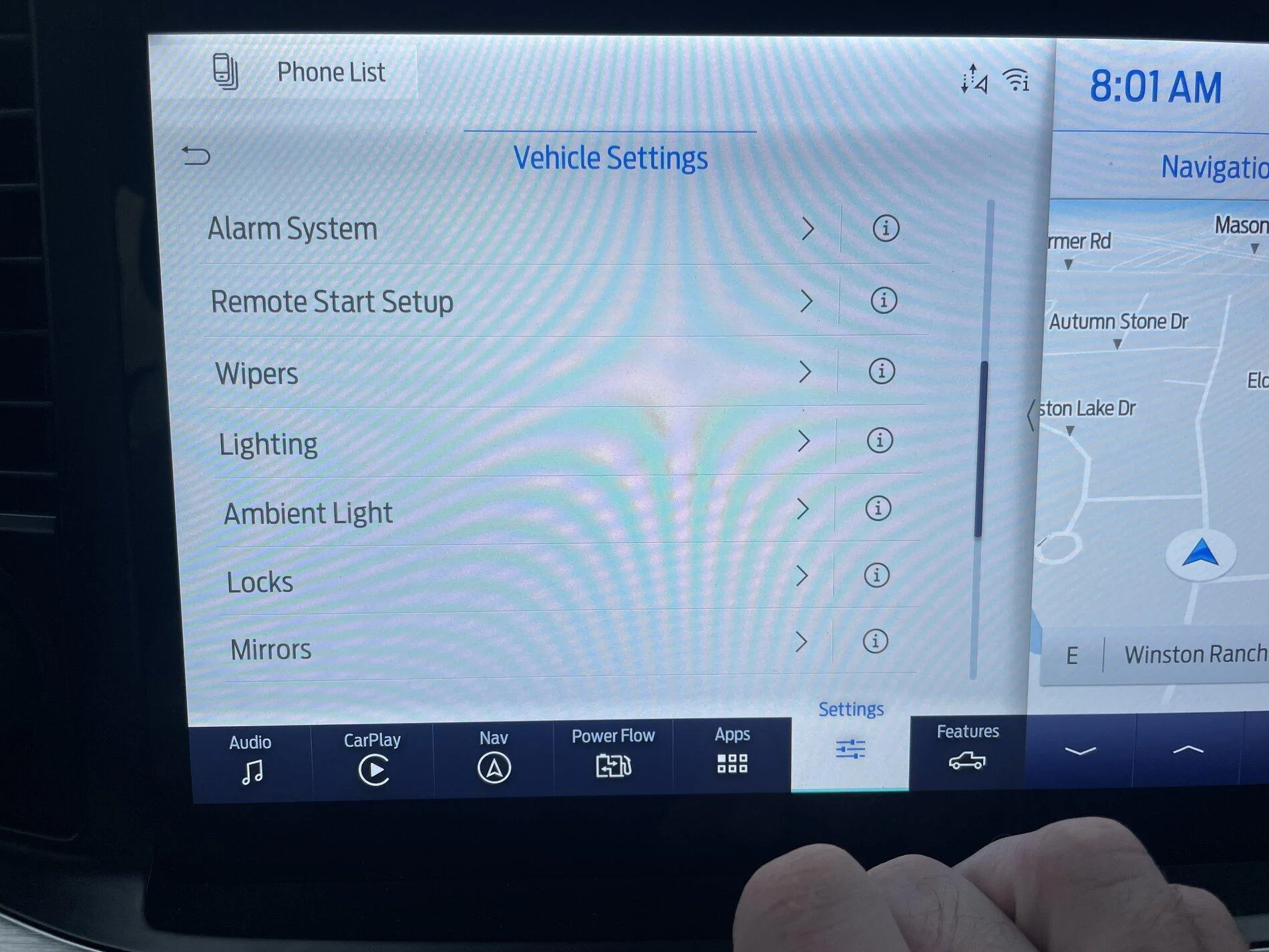

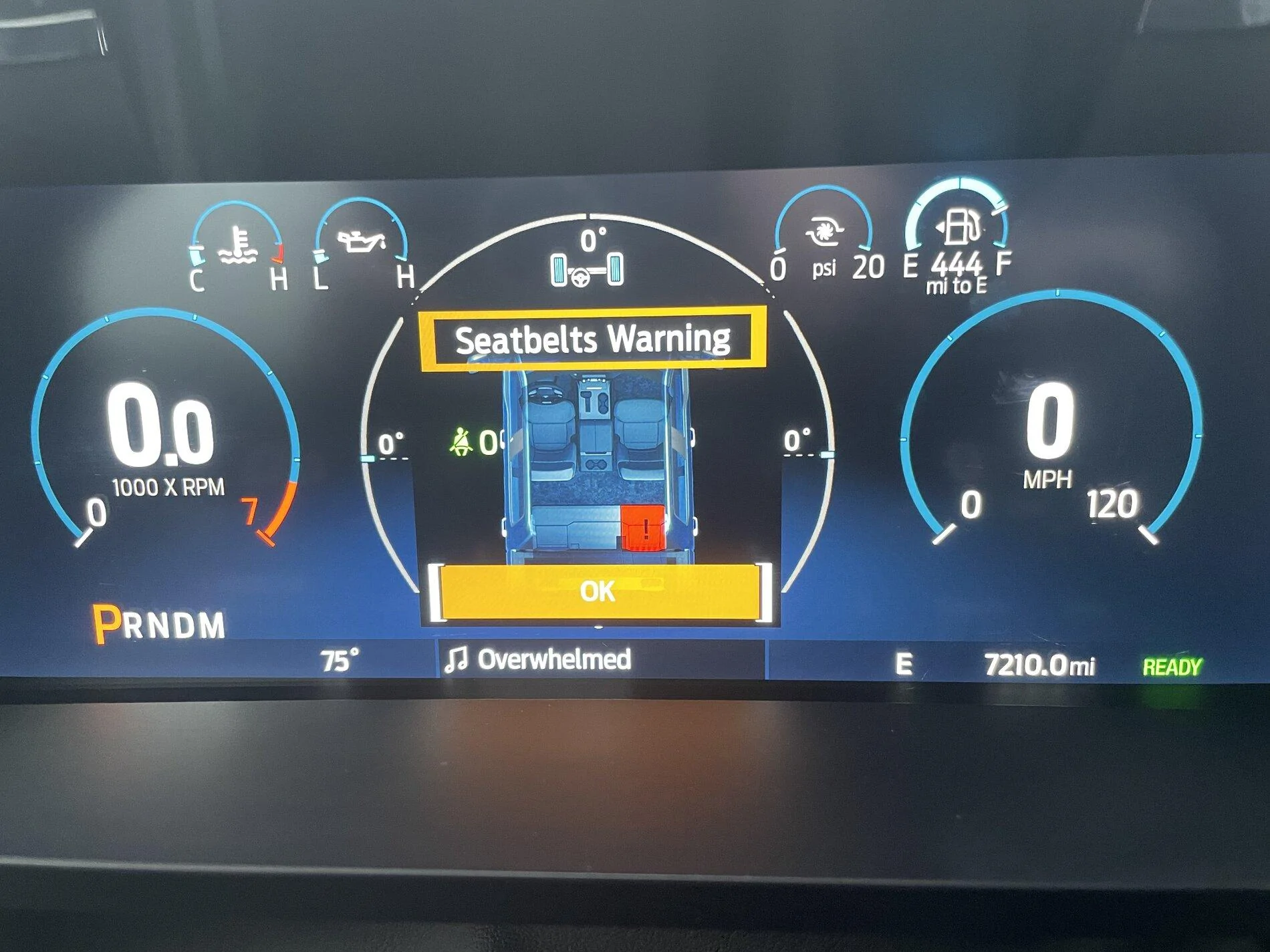

Starting a new thread forking off from the Forscan thread. I'm looking to eliminate the seatbelt monitoring system. This is the system that gives you a popup on the gauge cluster when someone in the backseat unbuckles their seatbelt. I drop off kids 3-4 times per day, and this pop up is stupid because it isn't paired with a weight sensor to determine if someone is actually in the seat, and it never goes away until you click OK, it will cover your gauge cluster for miles and hours if you leave it there. Someone in the forscan forum stated this could be turned off in settings, but I've been unable to find it. All of my screens are pictured below.
This is the pop up to eliminate:

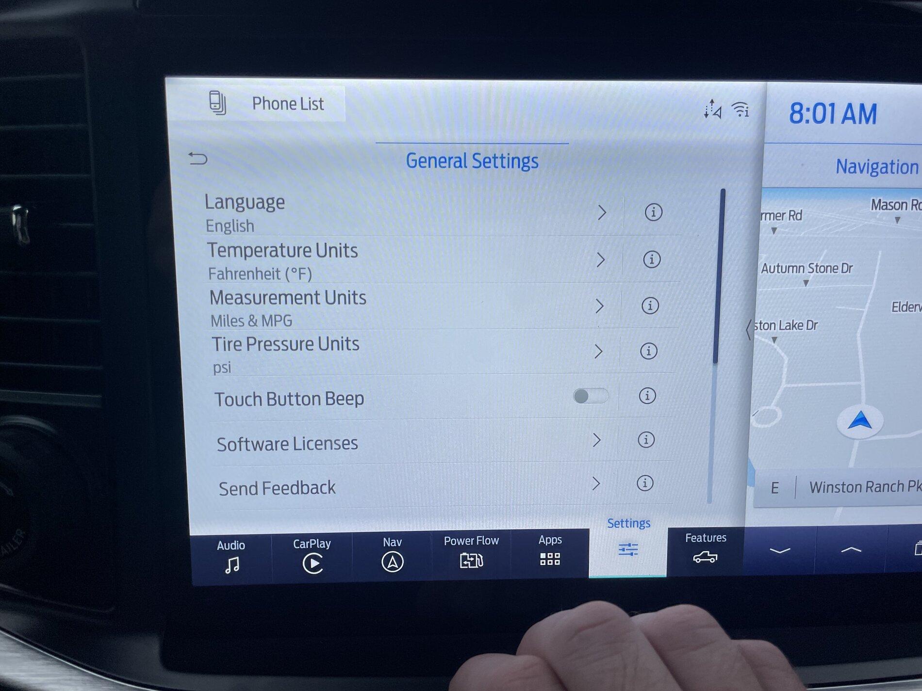

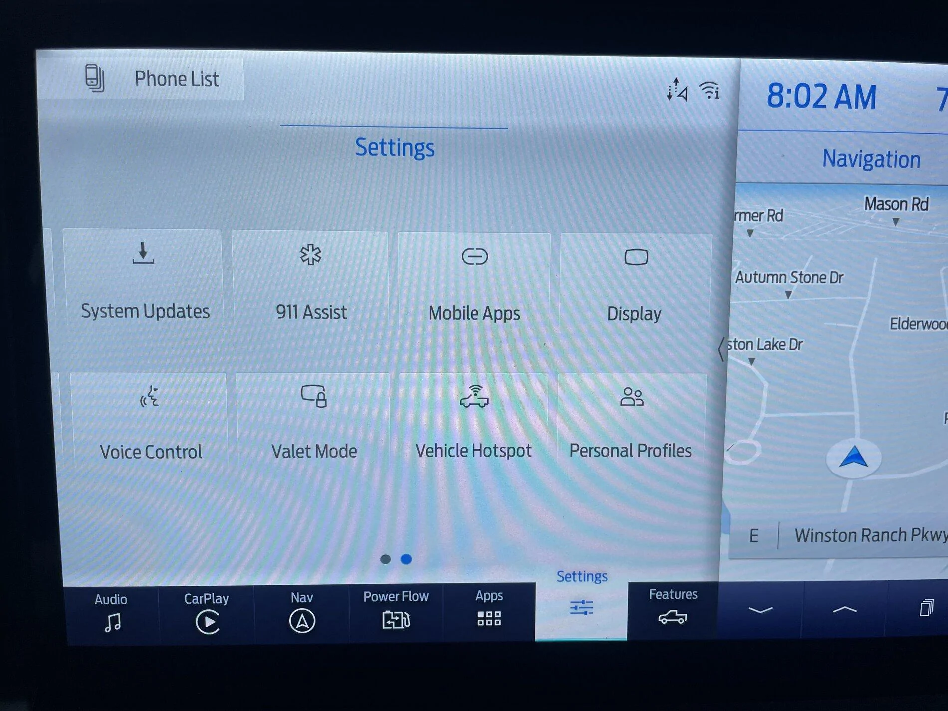

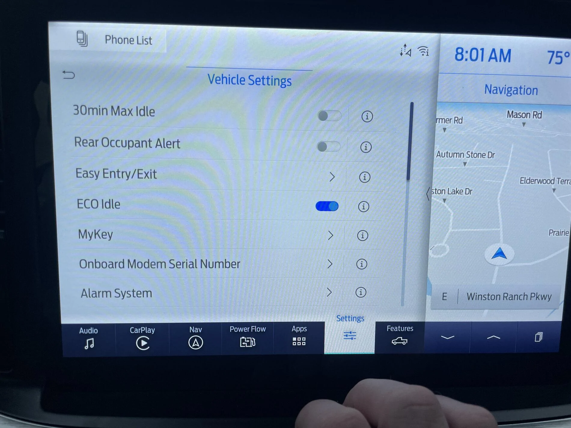

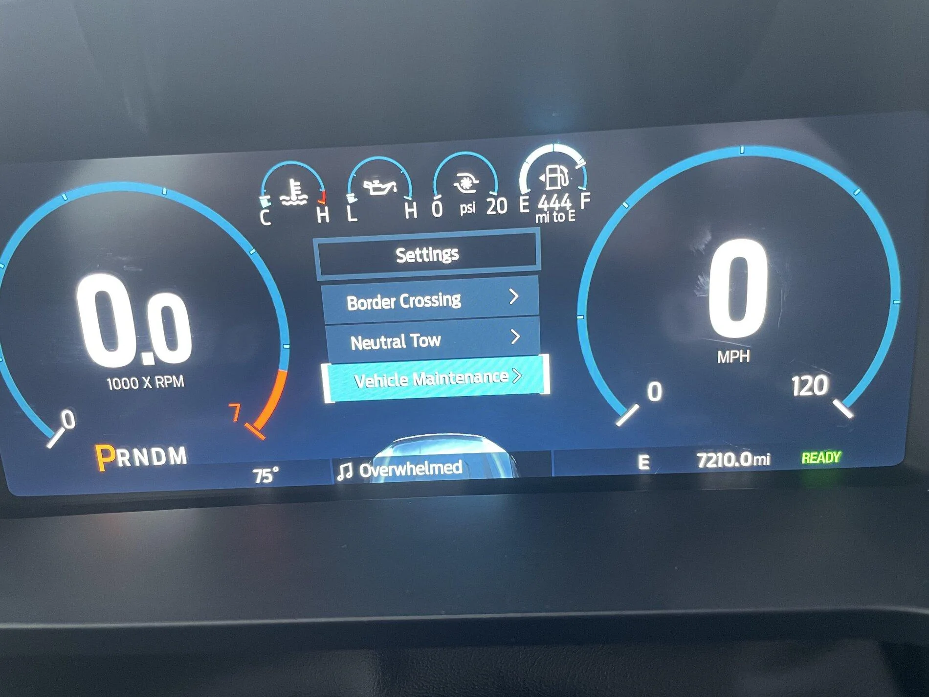

here are all my settings. If I’m overlooking the toggle for this please point it out.
Ford F-150 Lightning Disable Passenger Seatbelt Monitor System D1C463CA-8EF6-459A-8F0B-CC9E4EEC2C73
