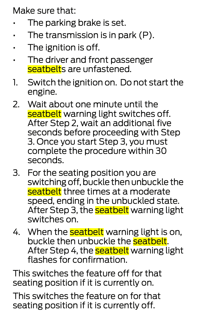

There is a toggle in the center screen for the horn honk and the seatbelt chime defeat procedure is detailed in the manual. I did both.
Folks should be aware that the seatbelt chime disable only stops the persistent, ongoing chiming. AFAIK, the seatbelt chime on startup can’t be disabled.

I tried this with no luck today. I could not get the seatbelt light to switch back on to indicate step 3 was complete. Is there some trick to this? "Moderate" is such a subjective term I'm wondering if I was going to fast, but I tried doing it slower and slower, but got frustrated and quit.

Were you sitting in the seat while performing the procedure?

I was in the opposite seat. Kinda facepalming that I didn't consider that might be part of the equation.

I went the same route you did, then I tried sitting in the seat in question, right passenger and right rear passenger, it was a bit tricky reaching forward to actuate the start button while planted in the rear, but I got these seats configured to the off mode.

Seatbelt chime disabling has to be done for each position. I only disabled the driver’s position.

I'm trying to do this right now and having no luck. I push the button to turn the accessory mode on without starting it but the seat belt light never goes out so that I can continue with the process.

No wieght in that seat, and its 4 clicks not 3.
I was sitting in the seat and I'm 224 lbs. Should have been enough.
The instructions say the seatbelt reminder light on the dash will go off after "approximately 1 minute". Mine never does. I've tried it with the truck in accessory mode (blinking green light on PTS button) and with the truck on (solid green light on the PTS button). The light never goes off. And I assume since the light never goes off, it's not going to recognize the rest of the process of buckling/unbuckling, etc...
