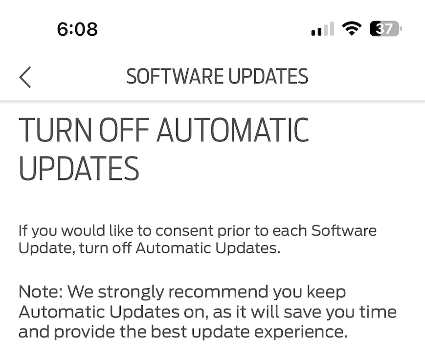

I wouldn't bet my lunch on it however, I believe the automatic update switch is for all updates.
Ford F-150 Lightning OTA update confusion 1700089812667
It states "each Software Update". We know the schedule for updates is only for updates that require immobilization during the update. I believe you will get no updates if you turn automatic updates off.
Turning off your 4G/WIFI modem will also kill FordPass functionality.

I can tell you with 100% confidence that auto updates only applies to updates that require the vehicle to be inhibited.
The only way to "turn off" the 4G modem on our vehicles is to unplug it. There is no toggle button to turn the connectivity off in the settings. At least not on the ICE trucks, but I don't think you guys have that option, either.

Matter of fact, even with auto updates off, your truck will still get updates sent to it. However, it will just sit in queue until the OTA trigger expires 30 days later. Updates that do not require the vehicle to be parked only have a 14 day timer to install before the OTA expires. "Consent" for these types of updates is given automatically to the OTA the second you turn the ignition on your truck for the first time after the OTA trigger was created in the servers for the vehicle.
