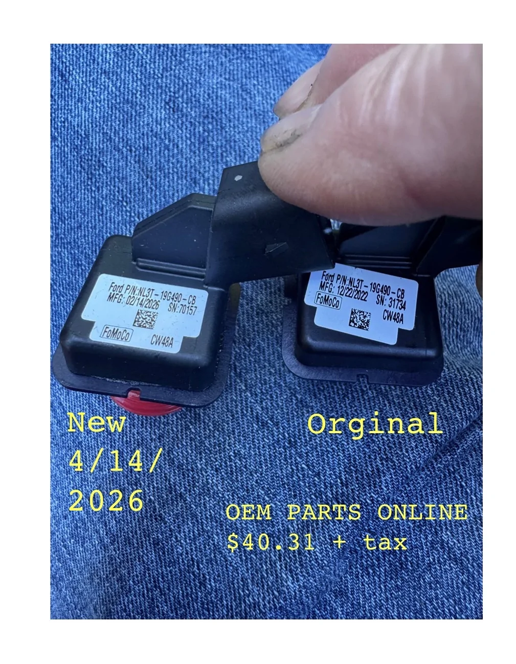

I have the B152E:55-2F DTC after DIY replacing the cargo bed camera with same OEM part. Camera works correctly even with DTC. Does anyone have any experience in FORScan running “IPMA rear camera calibration” for a successful fix given Stevie Wonder (6/11/24 this thread) said his ford repair order said “Ran camera calibration road test."

Clarifying above question about B152E:55-2F & FORScan IPMA rear camera calibration procedures.
