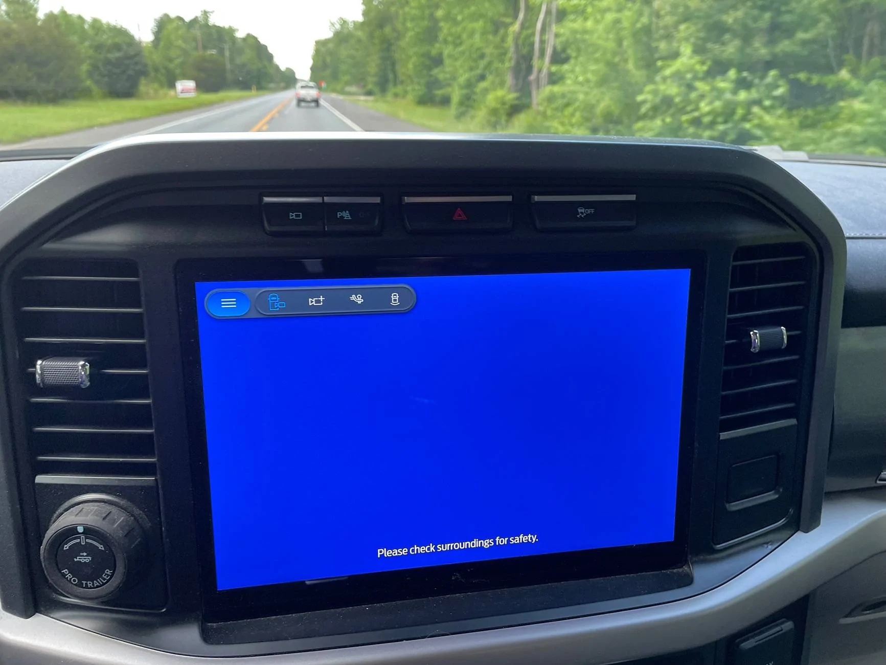

Bed camera quit working yesterday, now only blue screen. Other cameras work fine.
Tried rebooting IPMA, no good.
Any other thoughts besides take it to the dealer?

Looks like a warranty claim to me.

I had the same issue with my camera. Took into the dealer and they replaced same day. In my case the service tech told me the soldering on the wiring failed due to the high heat recieved on the roof from sitting out in the sunshine.
Seems to be a known issue but unfortunately a poor design from Ford.

It is the heat. I had similar situation. Dealer could not do any repairs, because at the time I took it in , it was working.

The replacement part has been superceeded 8 times, looks like it's used in many ford's since 2021.
Mines out now too, going to troubleshoot it next week when I've got a few spare minutes.

Mine is doing the same thing. I noticed it a couple weeks ago when I had a load in it. It started working and then stopped again. I scheduled it for service on 7/11. Also, asking for 500 amp charging update and front sensor CSP.
