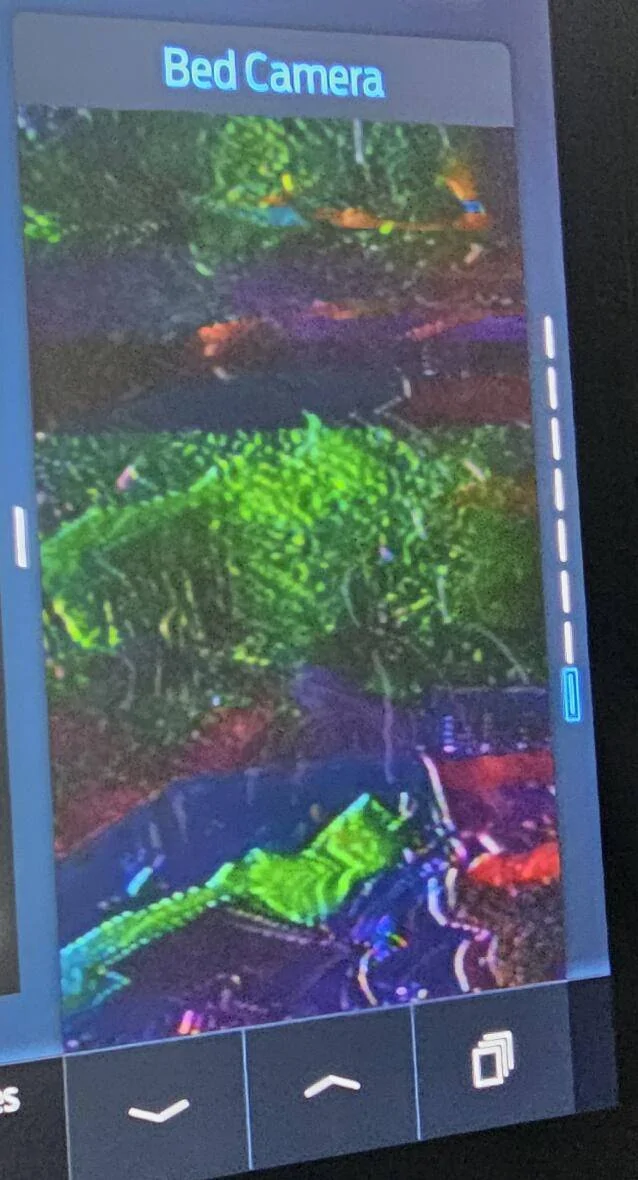

Overheated bed camera

Does anyone know if the replacement camera is actually different? Was there a bad lot of cameras or are all of our cameras subject to heat exhaustion? I park under cover in PA, so have not experienced this issue. I’m also well out of the factory warranty, so is my camera going to fail during a summer trip to New Mexico? This seems like it should be a CSP if it effects all of the cameras.

Any updates on you guys that got these cameras replaced, how have they held up? Mine has started doing it consistently when hot, wanted to make sure that the replacement does actually fix it.

I had mine replaced by the dealer about 6 weeks ago and it has been flawless since. On top of that we have had 90 plus degree days straight in the the south east. I was told my wife harness has melted in the heat prior and that was the reason mine failed. But I still park it outside in the sun. Seems to me Ford should have designed the roof compartment with some heat sheilding or some better connector to prevent this.
But if your under warranty they will fix it just depends on how long it takes them to get the part.

September will be a year since camera replacement. Parked ours in the sun for several hours today. Camera temperature 133 degrees, roof sheet metal 177 degrees, and the bed camera is working fine.

Same Issue here. The hot weather here in AZ causes these cameras to go out. I called the dealer today and they want me to drop off the truck and leave it.

Dropped mine off at the dealer this morning. Ironically now that the temperature dropped it started working but I submitted photos of it not work just last week.

Finally had a chance to try to get his resolved. Dealer refused mobile service as they weren't sure they could perform the repair in the field. They picked up my truck this morning and of course can't replicate now that the weather has cooled down. The numerous videos and pictures I have apparently aren't satisfactory and they now want to hold it until the weather is hot enough to replicate themselves. Why is this such a difficult process @Ford Motor Company?
UPDATE: Service advisor called and now will be ordering a camera for install tomorrow. Why it wasn't just ordered when the service was scheduled...

Should be plug and play. Believe it's the NL3Z-13A613-A which is going for over $500 on ebay. The more I look at the price of these parts the more interested I become in the extended warranty, would suck to lose the trailer assist because these keep dying.
