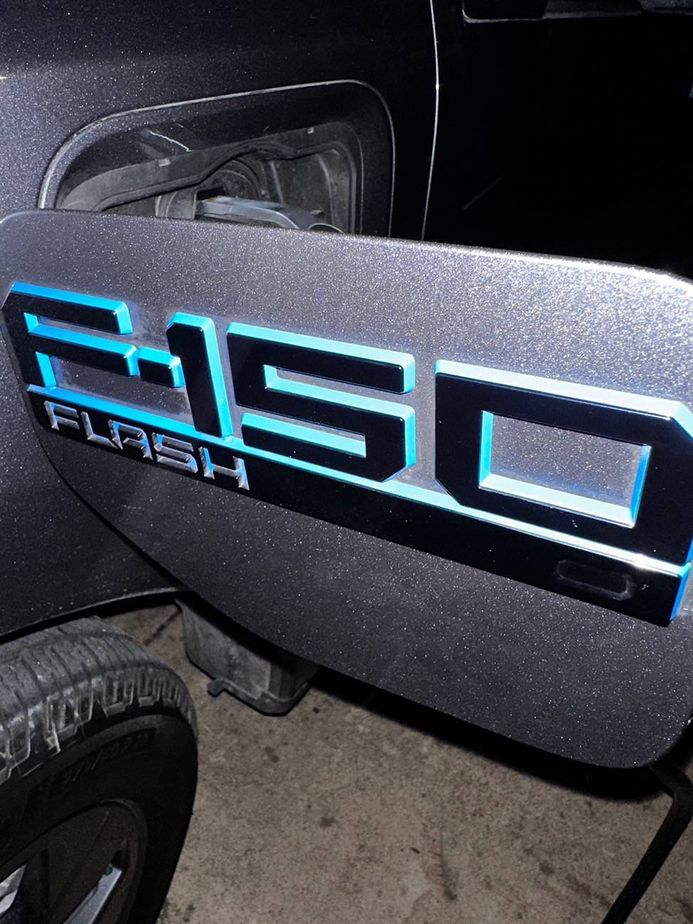

Does anyone have any experience painting, swapping, wrapping or otherwise modifying the flash logo that’s on the charge port door and the opposite side? tried to remove the one on the passenger side when I debadged and learned the hard way they’re anchored in

Yes. Mask off the area around the logo and start with a dust coat. Build it up with multiple coats, the more the better. After the last coat, simply peel the excess off and it will leave a blacked out logo??

I have done this on several cars. I have not on my lightning, mainly because I updated my ford emblems with the black versions. the results are great and last for years in my case. My 21 Tesla MYP still has the one I did when I first got the car.
As previous poster stated, dust with many coats and wait about 15 minutes in between. I typically do 7-10 coats without issue. Pealing away is easier than it looks, but I would say ensure you pull away, not up or you have to start all over.
