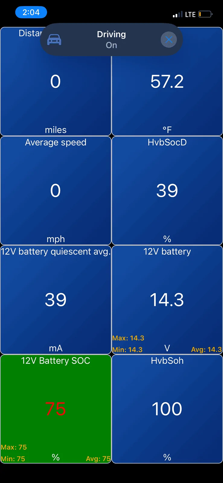

What I use. Takes a bit of getting used to. Offers over a dozen pre-organized dashboards. I’m follow HVB battery State of Health and LVB state of charge. I also use HVB state of charge to estimate range based on HVB % of charge as it’s accurate to .5%.
you can create your own dashboard though that takes practice. Best to pick one you like, then modify.
What I use-
Ford F-150 Lightning Use of VeePeak OBD-II Scan Tool (OBDCheck BLE) and the Car Scanner ELM OBD2 iPhone App IMG_4070

thank you very much.
