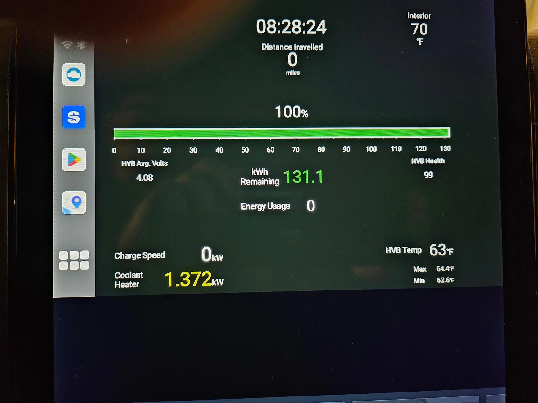

and (the Biggie that I cannot believe Ford doesn't provide anywhere) the Actual HVB kWh Remaining.
Yup, that seems to be the real gas gauge. Ford must be thinking they are doing a great job estimating the miles remaining and once we know that, displaying numbers with kWh units may make our pretty little heads explode. I have noticed SOC displayed does not correspond to energy remaining linearly, especially from 99% SOC to 100%.
what is the name of the parameter showing as “charge speed”?
p.s. The visual of your post is extremely helpful.

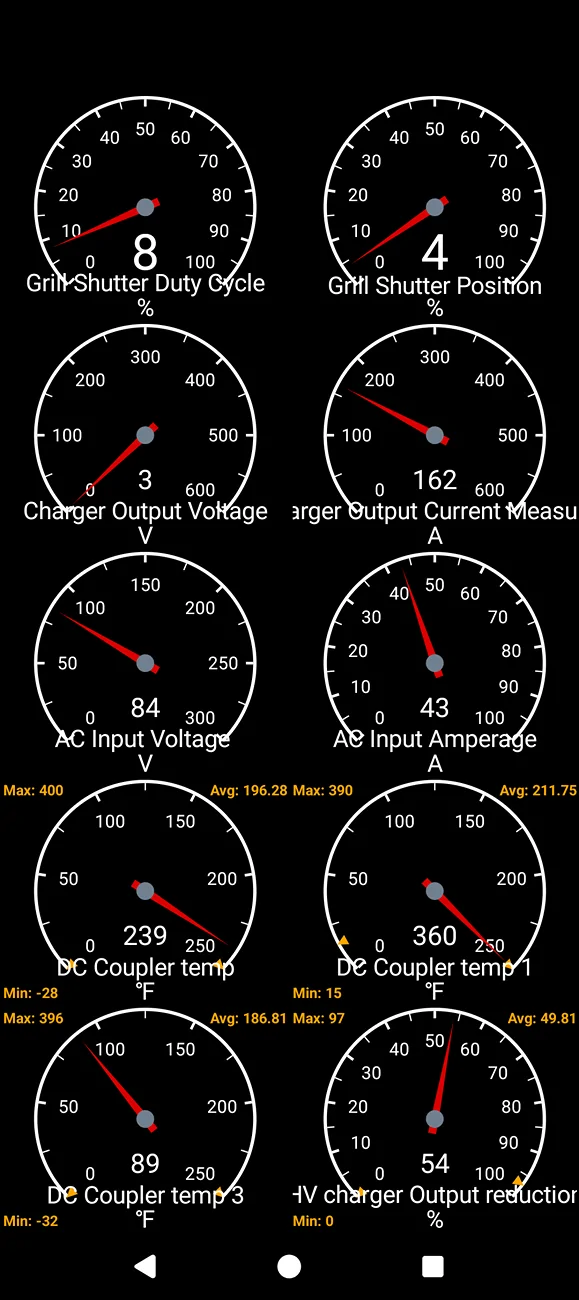

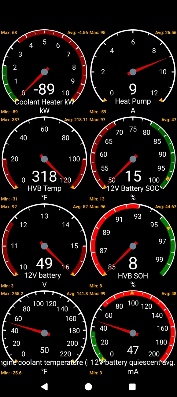

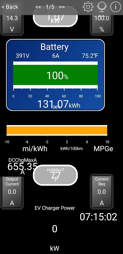

I use Android Auto to see Carscanner on the 12" screen. It only shows text, no gauges or pictures. I heard that is due to Android Auto safety requirements.
I found the app and as you said it only shows text. @Bandit216 screen looks sweet. Graphic is less distracting than text to me. I am not sure he is using iPhone or 15 in screen guys Sync does something differently.
Adding insult to injury, each page can only display 10 parameters.
I do have another question. Have you ever been able to measure your acceleration? It does not like the truck to move. I can see it start showing the acceleration as soon as I start moving but replace it with the message before I can get any meaningful information.
Ford F-150 Lightning How do you use your OBD-II, Car Scanner? 20250910_164730
Ford F-150 Lightning How do you use your OBD-II, Car Scanner? 20250910_161805
Ford F-150 Lightning How do you use your OBD-II, Car Scanner? 20250910_163329

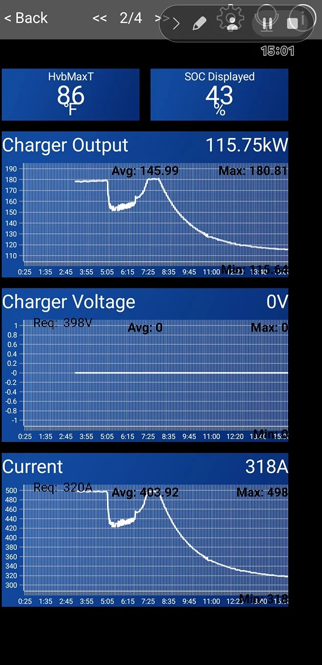

Does anyone know why battery temp increases is not shown linearly? Or at least with a smoother line?
Ford F-150 Lightning How do you use your OBD-II, Car Scanner? Screenshot_20250911_095808

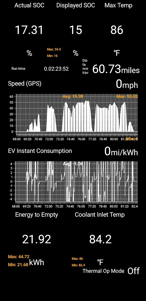

I haven't ever tried to get the acceleration. Have you tried using that on the phone only (not connected to AA)?
I tried it while I was connected to AA and could see the results on the phone but not on truck display. I had a lot of heavy stuff in the frunk, steel running board and bed rack, some junk in the back and tires slipped when I did this which may explain why it is not anywhere near the 3.9 sec I saw on one of the Pro reviews. But even at sub 5 seconds, I felt like I was about to pass out. I may try this again with less weight.
Ford F-150 Lightning How do you use your OBD-II, Car Scanner? Screenshot_20250911_162430
