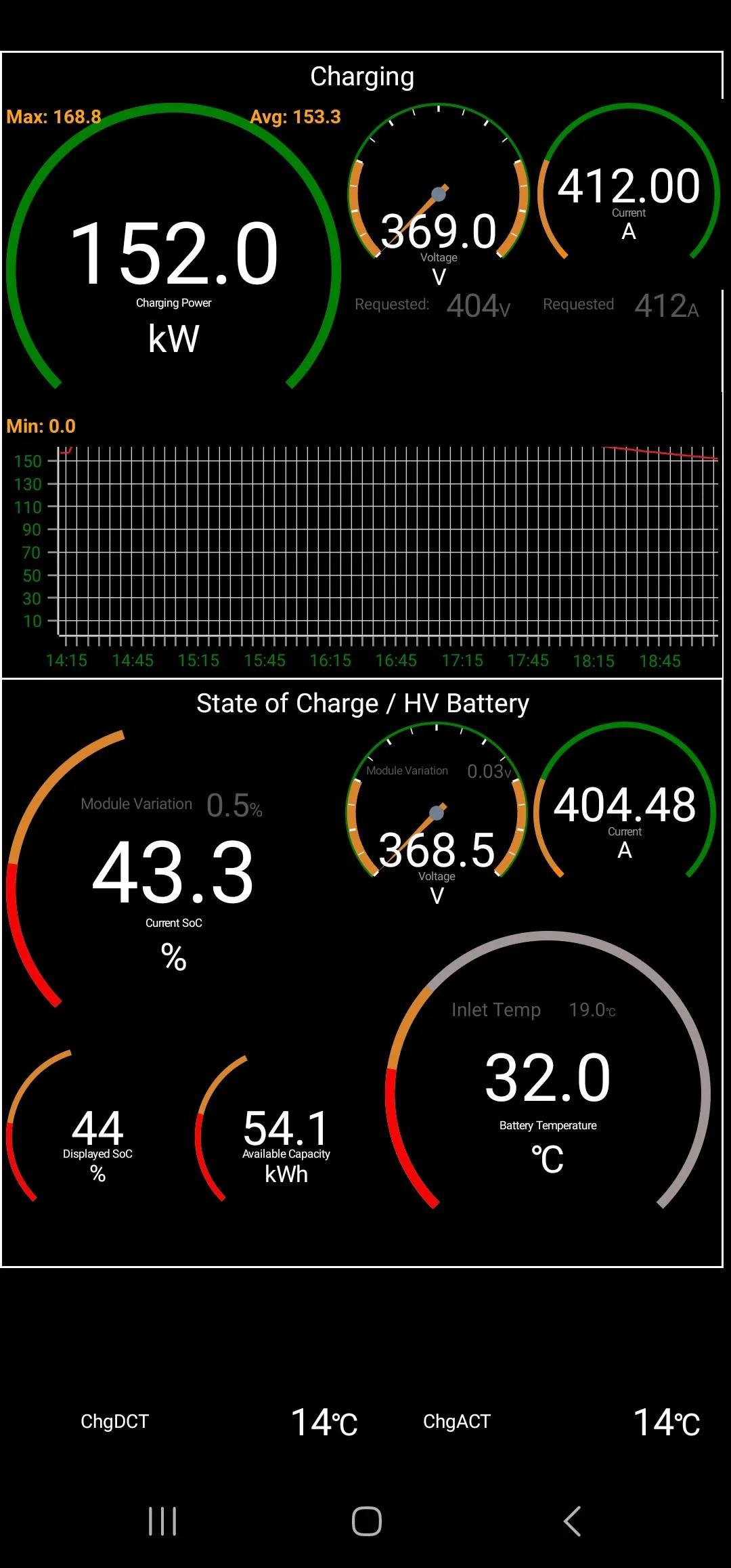

I've played around with CarScanner which has a pretty good interface with better ways of creating a clean "dashboard" with the relevant information. The downside is that any logging kind of sucks, you get a CSV file (not bad, formatting isn't ideal) and that's it.
The good thing here is that it contains all ? (most of them anyway) the usable PIDs out of the box.
So I tried Torque (Pro) and it's horrible from every angle possible - except, logging.
I set up a Raspberry PI with Node-Red, Influx DB and Grafana and Torque logs via HTTP requests to the database and can be used at a later stage.
I'm contemplating writing my own OBD interface to eliminate the need for Torque, since I only use it for the logging portion, but I'm not sure how much work that would entail.
The screenshots below are from Grafana, logging a charging session at EA from ~8% to 90%
and the second one is my charging "dashboard" in CarScanner (note the darker gray "sub" information)

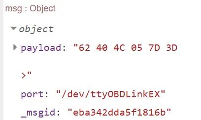

Probably the easiest way to extract PIDs is to use ForScan (free version will do) and a serial port sniffer, for example https://freeserialanalyzer.com/ (not as sketchy as you'd might think by the name/link, it's OK)
Pick one PID at a time and log/sniff each one separately and you'll get the PID and response in the logger. At that point you just have to figure out which format the response is in.

Mr. Magoo, thank you for actually posting this idea. I've suspected this to be true and a method to easily find out every PID one might be interested in.
Is there some reason why someone hasn't data logged the full "initial scan"
It all depends on what you're trying to accomplish.
The downside of doing them one by one is that, obviously, it'll take a LOOOONG time to get 'em all if that's your end goal.
The OBD "protocol" is pretty well defined and straight forward, there's many publications out there showing how it works and what commands to use (if you're creating your own app).
What you need to know is which module it's from and what the PID# is, that's it.
You then issue the ATSH command "ATSH0007E4" to swap / activate the module, followed by the PID request command "224845" and in response you'll get the "handshake" information plus the data.
FORScan does this for you and if you log each module as you switch them you'll see/get the module number / address as well, plus at this point you'll see what FORScan thinks the value is which will make your conversion easier as the formula to convert the HEX response to an actual number isn't published by the module / initial scan itself, so you'll still have to go through them one by one and trying to figure out what's going on.
Many PIDs exist across multiple modules, and a lot of PIDs have status bits in them utilizing the same PID# for multiple "sensors", so your list of 3000 PIDs will boil down to about 800 unique addresses.
