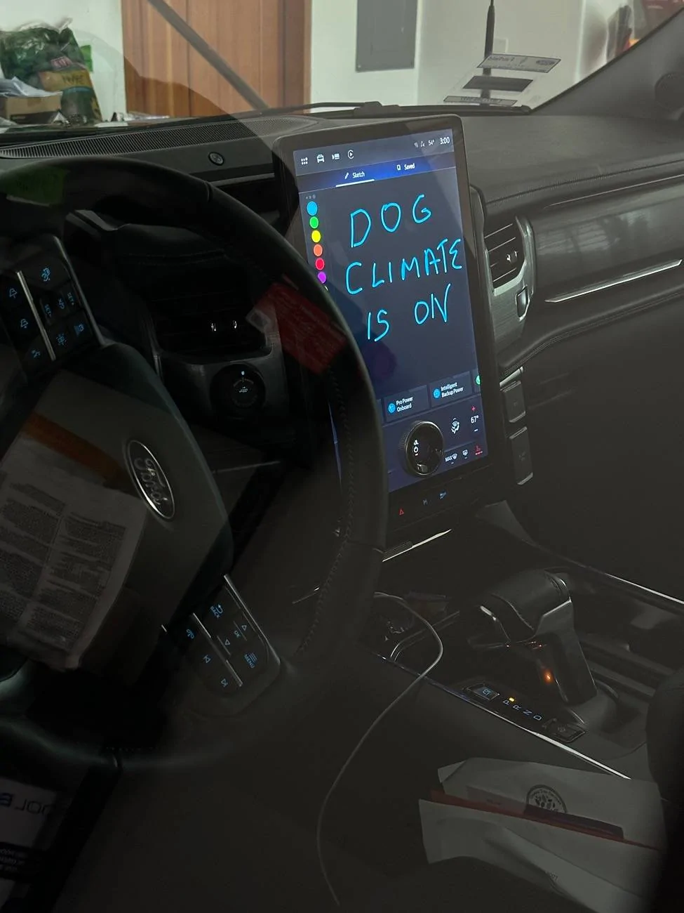

Leave the truck running, set the parking brake, turn off the exterior lights
Switch off the 30 minute automatic shutdown timer, which kicks in if the key-fob or PAAK devices are not present.
Use the paint app to write custom message on the center display regarding the healthy cabin condition.
Ford F-150 Lightning Pet Mode for Climate Control? IMG_9886

I just leave the truck "running" with all the accessories off and lock the door. It will run that way as long as you need without attention, with little range impact.
If someone breaks in, the shifter will not come out of park without a "key" present.
I like the Tesla sign on the screen tho....
I do the same thing, but one needs to remember that there is a "power down" timer I think at 30 minutes, but you can turn it off. Also to prevent idiots from breaking a window to save a dog, I pull up the etch a sketch and write a message "dog is fine, AC is on, be back in 20 minutes"
