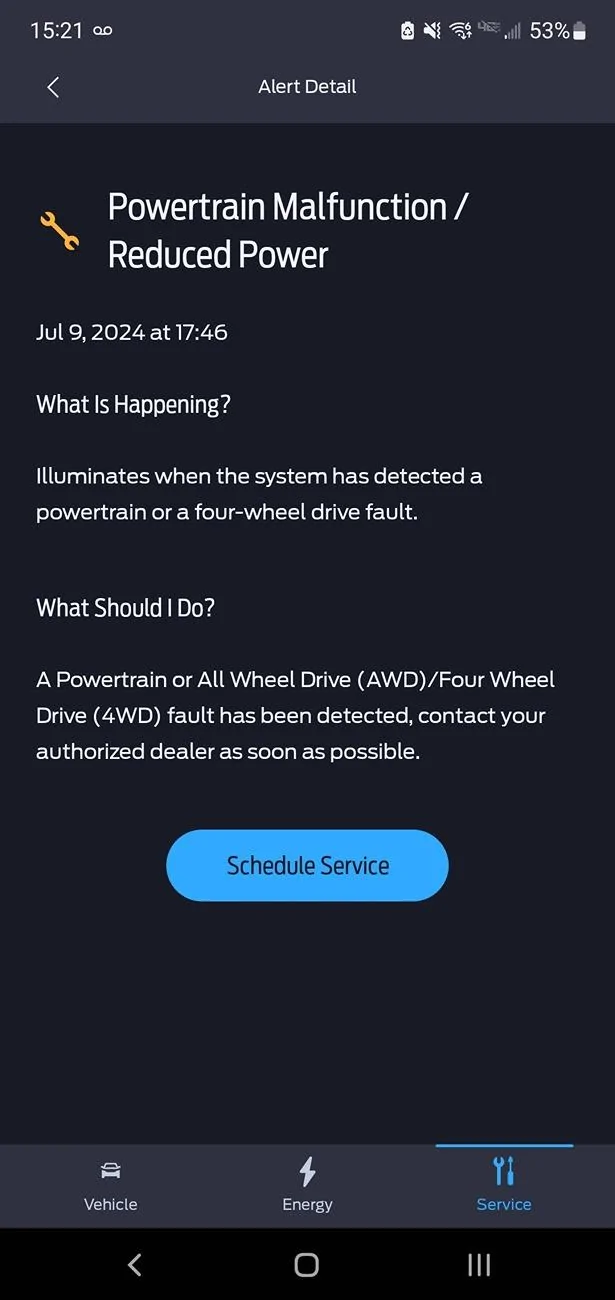

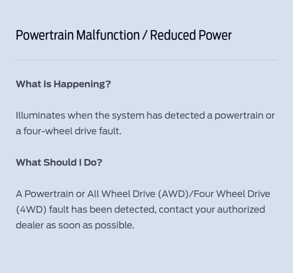

Hey all,
Purchased F150 Lightning xlt ER about three months ago. About two weeks ago, a warning light popped up on the dash with a wrench indicating I need to schedule service. Inside the Ford Pass it showed the following description:
I scheduled service in which the dealership had my truck for several days. I just got a phone call from dealer saying it's a non issue and they were able to clear the warning. On the way home, the same exact warning light and description in Ford Pass appeared.
Anyone experience this? It's a bit frustrating only having put 2500 miles on the truck.
Thank you
