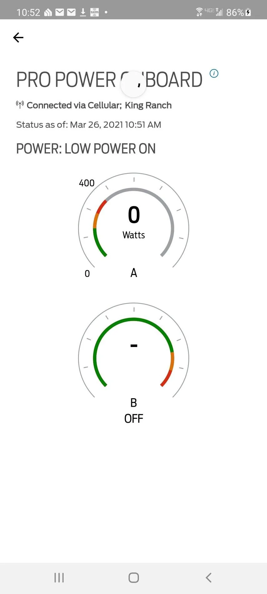

Well, I have the 5.0 with 2kw pro power that doesn't work at all anymore. 1800 miles. Hit the green reset and nothing. Only ever had a cell phone charger plugged in cab. No AC 120 v plugs work in cab or out now. The error message says 'pro power onboard is currently unavailable. See owners manual for details'. I have already had the truck back to dealer for windows not opening or closing- flashed, a new oil cooler as the original leaked motor oil all over my driveway, trailer alert faults that are incorrect, alarm system going off for no reason...more time in the shop then out. I am calling dealer now about 'pro power' issue. Not impressed.

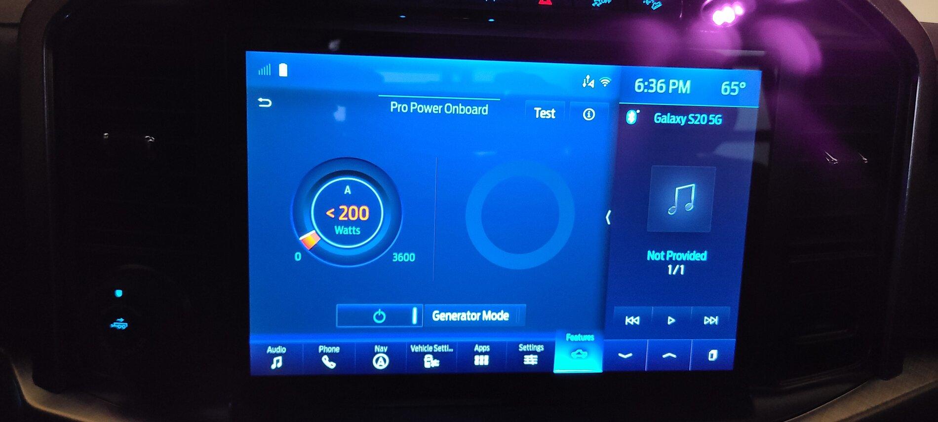

The Pro Power button? What 3 modes does it do? I've only noticed on and off.
It shows Off,,Lowpower mode and generator mode these cycle through with the button at the top left on the dash board ...next to the parking push button. Mine is red all the time in low power mode too

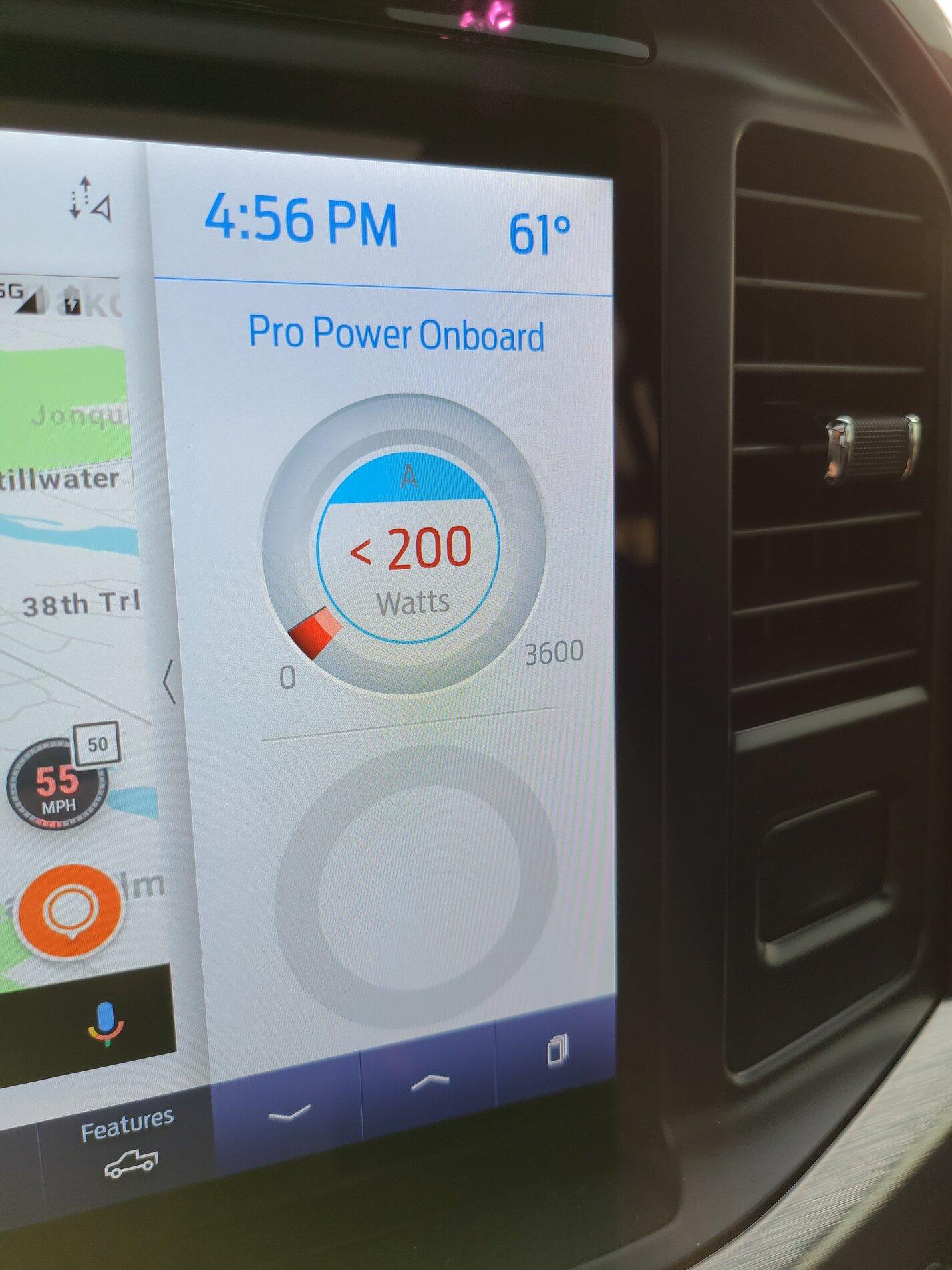

Ford F-150 Lightning Pro Power comes on automatically at startup? IMG_1269
jfdube999
Jean-Francois
Nov 11, 2020
302
Montreal, Qc
2021 F-150 Platinum 4x4 FX4, 2020 Edge Titanium, 2019 Escape Ti, 2019 Mustang GT PP2
I found a lariat in dealer inventory that has the 3.5L EB w/2k power in Feb and it seems odd to say the least that every time I start the car the fans in the back start whirring away when I am not, and don't intend to, use the generator at the time. At the very least it should remember that I had turned it off. Why it doesn't default to "off" is beyond me. How many of us even use it once every month or two? Unless I'm missing something fundamental, there's no power being used at that moment and no need to cool an inverter.

If you have a phase A and B, you have a 7.2kW powerboost. The interior outlets ALL run on phase A. The regular 400W inverter under the 40% rear seat handles this, it's the same inverter we've had for years on these trucks, inverting from the 12V battery. So propower isn't so much "on" as it is "available". (at least, that is my interpretation of the behavior I've seen and what I've read)
If you have a 2kW propower then you do not have a hybrid you have an EB or 5.0. You have a giant inverter under the 60% rear seat in addition to the same old 400W inverter under the 40% rear seat. I don't have experience playing with one of these but I have seen complaints that it starts as "on" and is very loud, and you have to turn it off. Seems like it should default to off and is an oversight by Ford.
I have a KR EB with Pro Power on Board 2kW. You are correct that the 2kW inverter is under the 60% seat. Under the 40%, however, are the two 12V batteries wired in parallel for the 24V system that feeds the inverter and is charged by a separate alternator.
My PPoB comes on in low power mode (Generator off) whenever I start the truck to power the 120v sockets in the cab. You can quickly turn it off by hitting the button on the dash twice as it cycles through the modes (LP, GEN ON, OFF).

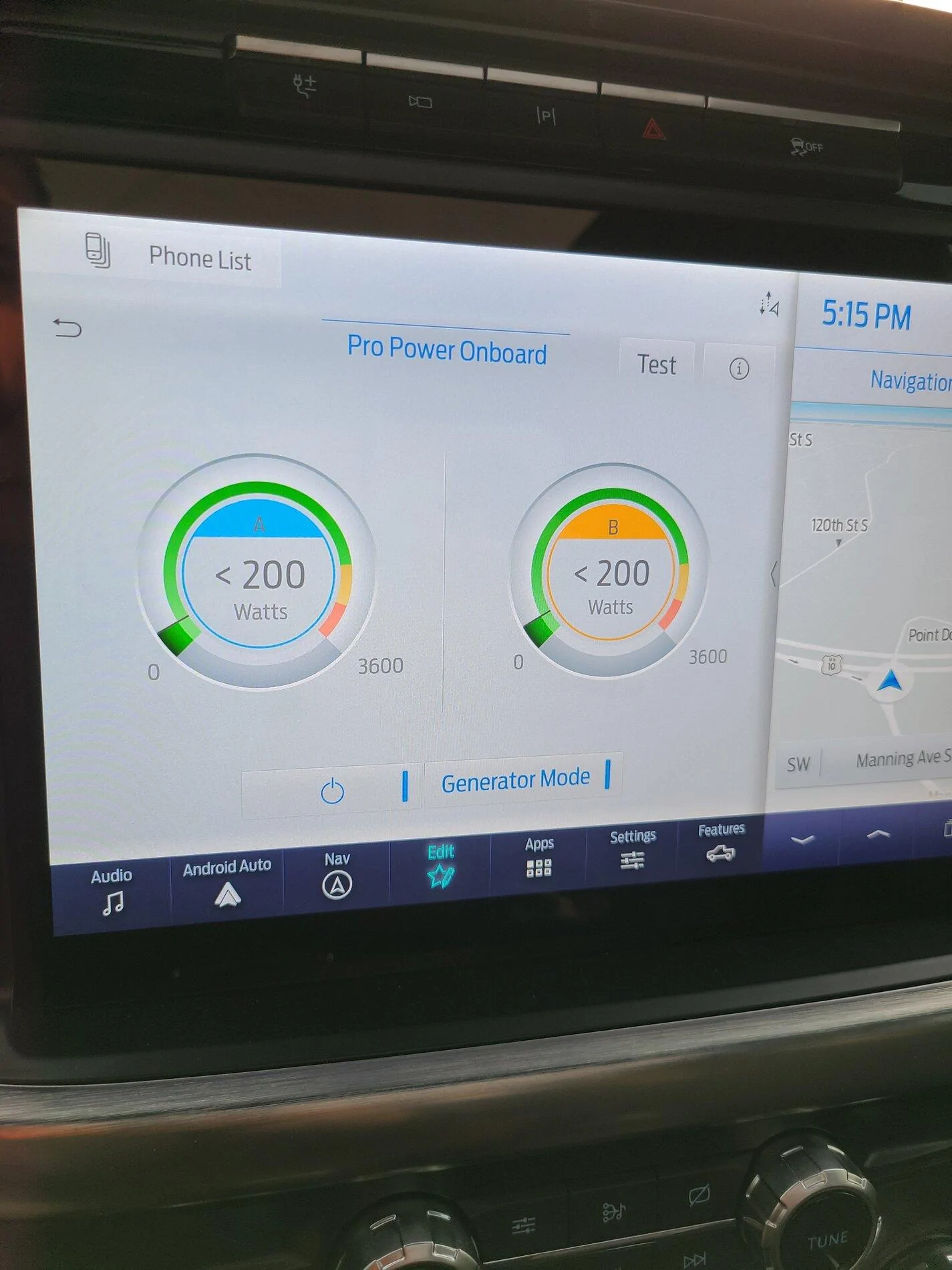

I have the 7.2kw PB and mine always defaults to on as well, like OP's photo. Is this how it is supposed to be? Could it be the cause of lower MPG?

Not sure if you guys have looked but under the 40% seat in the back isn’t an inverter it’s actually a small 12 volt lithium battery. I believe All inverter functionality actually comes from under the truck now. Also if you ever disconnect your battery you also have to disconnect the small 12 volt battery under the seat and pull the disconnect for the high voltage system under the hood on the drivers side for all power to be disconnected. It’s a small green plug close to the drivers side fender.
FWIW, low power mode (Leg A only) is always on when you first start, you can turn on high power (7.2kw leg B), generator mode or all outlets off optionally.
