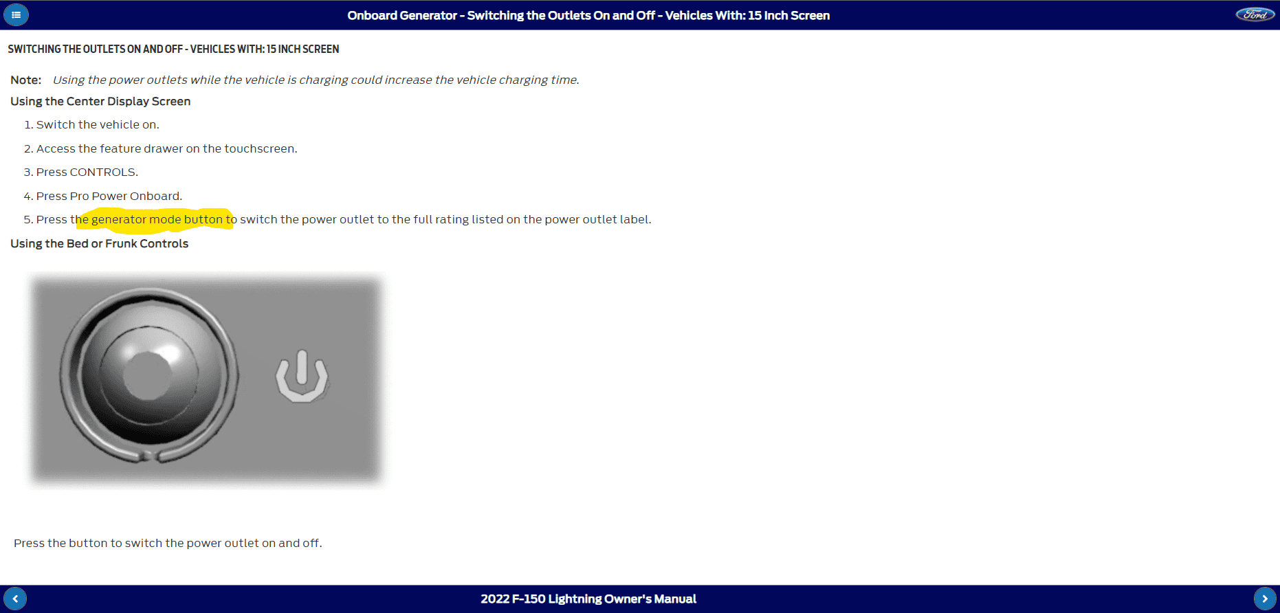

I'm using the Pro Power Onboard to power my house during this great storm we're having. The 30A outlet is working great at powering our house which is perfect since PG&E just told us we will be out of power for 2 more days.
Here's my gripe. The truck has to be fully on! Even the manual for the truck says "5. Press the generator mode button to switch the power outlet to the full rating listed on the power outlet label." But there is no button! I hate having to leave all of the screens on. Also, I forgot about shutting off the lights, and the HVAC and heated steering wheel. When sunset came, all the exterior lights turned on, so I jumped in to shut them off. I was unpleasantly surprised to find my steering wheel and cabin nice and warm. Those have only been running for ~9 hours...
@Ford Motor Company - I really love the truck and this power outlet is amazing but give us the button that the manual says should be there.

That isn't the button for "generator mode". That is the circuit breaker reset button. Generator mode, IIRC, is on the Pro Power screen.

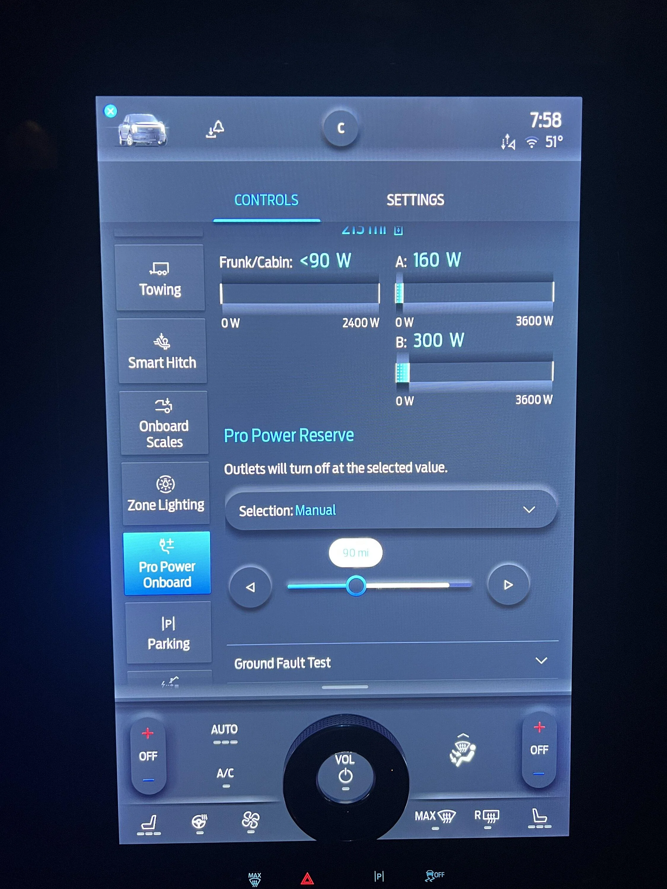

I’ve got nothing! I went through every menu and couldn’t find the generator mode button.
Ford F-150 Lightning Pro Power Onboard - Generator Mode?! *Rant* 5A5266D4-9BCA-46D5-9653-300EC829E3E6
Ford F-150 Lightning Pro Power Onboard - Generator Mode?! *Rant* 5ED32FAD-2DDB-413B-9AD5-827AEB333306

I’m doing the same thing. Power outage for the second night in a row. I tried shutting off the lightning and go to power on button, but the pro power onboard will not stay on, and advises that the vehicle has to be started. I couldn’t find how to shut off or turn down the screens either, but I did shut off all the other controls that are possible. I believed the on/off button you are referring is on the bed to the right of the outlets. I ran extension cords to the frig,water heater,coffee maker, microwave and several lights. Working great so far. Power back hopefully Friday afternoon.
Yep! I tried all the same stuff, no dice. I think the manual is wrong and it’s a copy paste from the ICE F-150 with Pro Power. They do have a button on the screen to turn on generator mode.

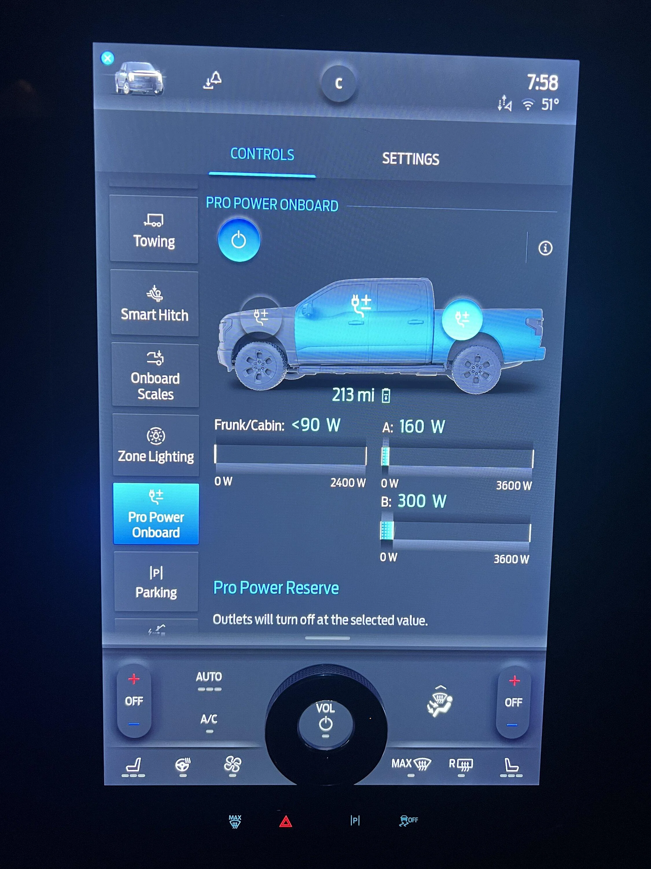

Yeah in the Lightning you have to turn on the ignition. What I do is turn on the ignition, turn off the climate control, and then press and hold the knob to put on the “calm screen” so it’s not drawing CarPlay from my house. In this mode the extra power usage is negligible but it’s not convenient.

Thanks, center button did the trick.
Yeah someone on a MachE Reddit taught me the calm screen trick! It’s still a workaround for something that should be more elegant but hopefully one day — it’s just software.
