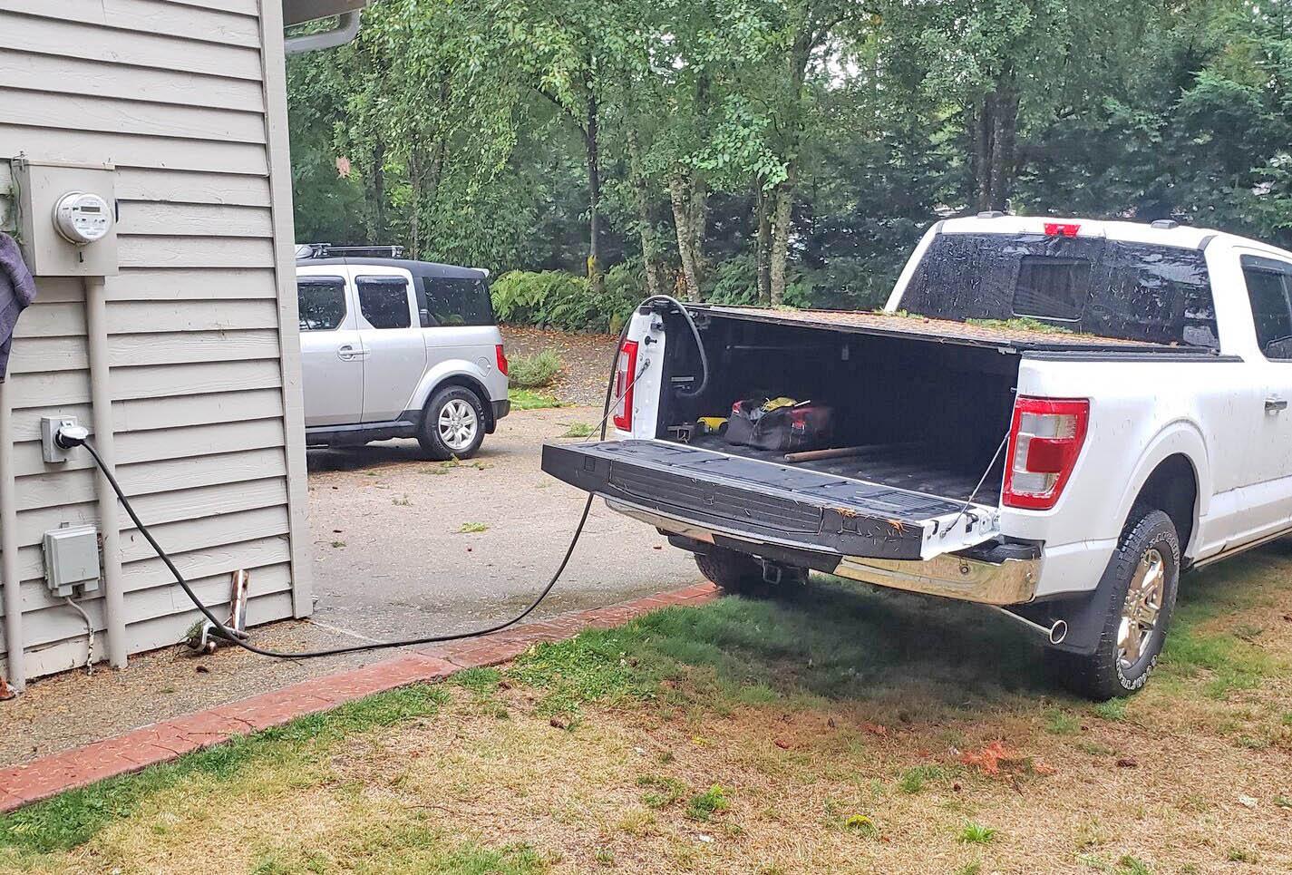

Shout out the 2021 f150 power boost. Had power outage for 2 days and ran the whole house with no problem.
Ford F-150 Lightning PowerBoost Pro Power Onboard Generator  VS Power outage! 20210918_084344
