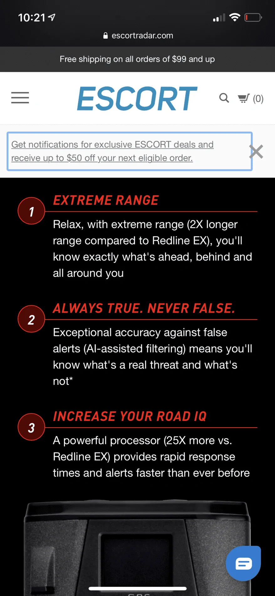

Oh look. It’s basically the #2 feature of the new $750.00 detector by escort.
AI Filtering - I need this in my life
