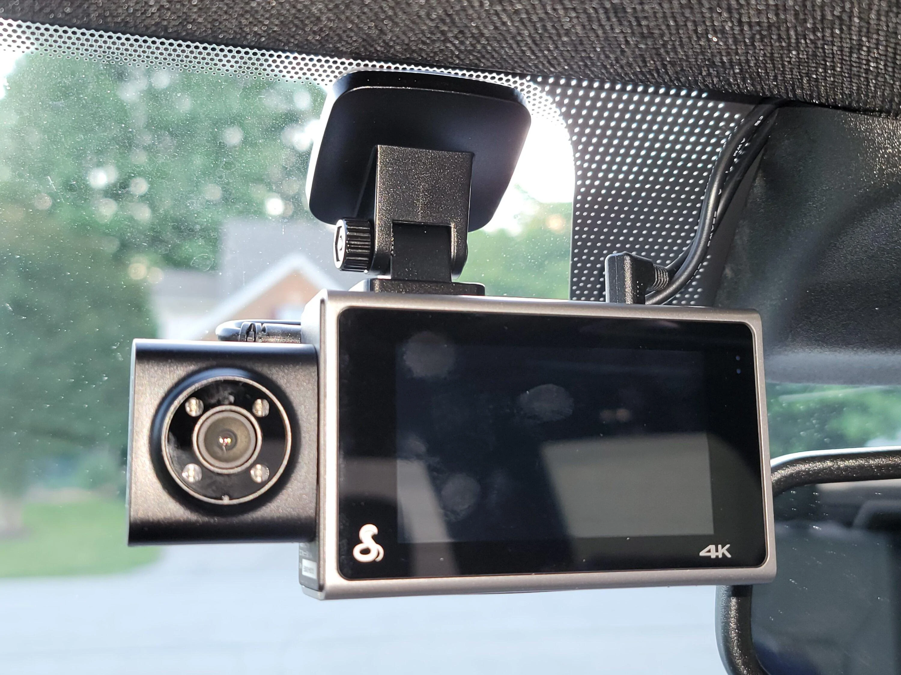

I ran my dash cam power wiring to the fuse box. It tucks up nicely under the headliner, then the door weather stripping and there is a fuse box behind the passenger kick panel. Ran the rear camera cord along the same route and then along the headliner to the back window on the passenger side. I am not sure that you would see any less exposed wiring if you were to tap into any mirror wiring.

I installed a Cobra SC400D (4K) that I picked up from Best Buy. It includes a front and rear camera with GPS built into the mount. I purchased their separate IR camera directly from Cobra for inside the cab that plugs into the side of front camera. I really liked that the front camera had an adjustment to reduce glare from the inside of the windshield.
There are some cheaper models on Amazon, etc., but a little difficult to find the three camera setup with decent quality resolution. I have run one of the cheaper models in my Fusion for a couple of years...you can tell the difference in build and resolution quality.

Here is a pick of my install. Not much exposed wiring and I used the fuse box behind the passenger kick panel for power.

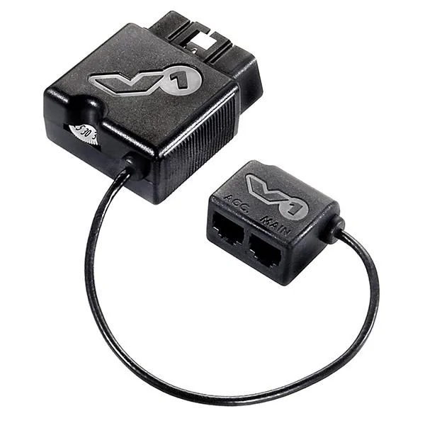

I put my Valentine 1 radar detector away after selling my torquey BMW diesel as I didn't need to worry about speeding with my current vehicles (PHEV & 528 BMW).
Now I have to dig it out because the Lightning may turn out to be speed freak.
I used the OBD-II adapter from Valentine to provide power and set the minimum detection speed.
No cutting wires, splicing, etc...
I plan on doing the same with the V1 - run the telco cable up the side of the window moulding.
