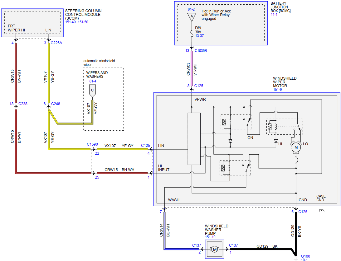

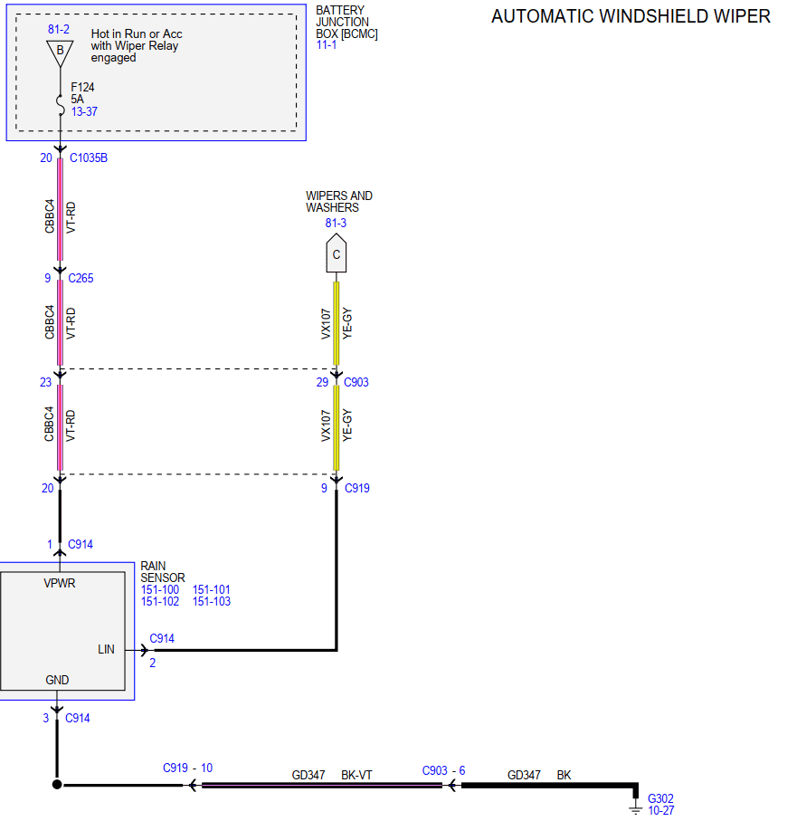

Sorry for the late response - yes that's the kit. It's the same for the Lightning. But really all you need to do is get three wires up to that connector that plugs into the rain sensor. My truck already had ground on the connector to the rain sensor (probably because it's used for the other modules up there.) I ran the LIN bus wire from the sensor connector back to the steering column control module (That would be PIN 2 of the rain sensor to pin 3 of the steering column control module connector - see below.) I picked up accessory switched power from a project I was doing to add the rear heated seats, but I would think you'd be fine grabbing this from one of the 12V power outlets in the truck.
I am not totally sure where the premade harness gets 12V power from. The steering column control module connector I believe only has a constant power feed, so maybe their T harness is just keeping the rain sensor on all of the time. Doesn't make the most sense to me so I may have missed something there, or maybe it has very low draw or something. I wasn't sure so I hooked mine to the switched to be safe and there have been no issues.
Anyways I hope this helps.
