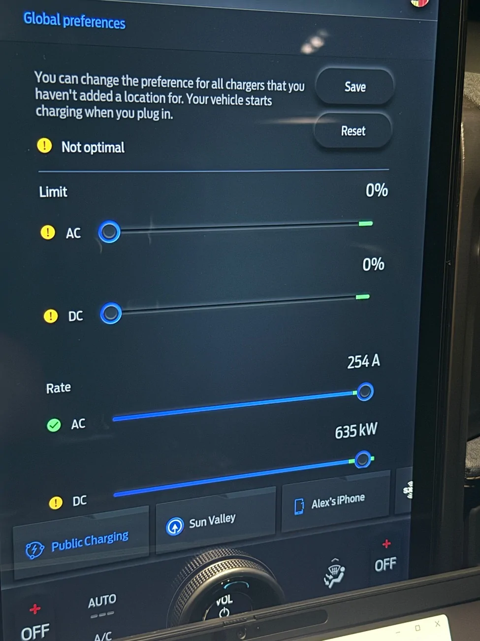

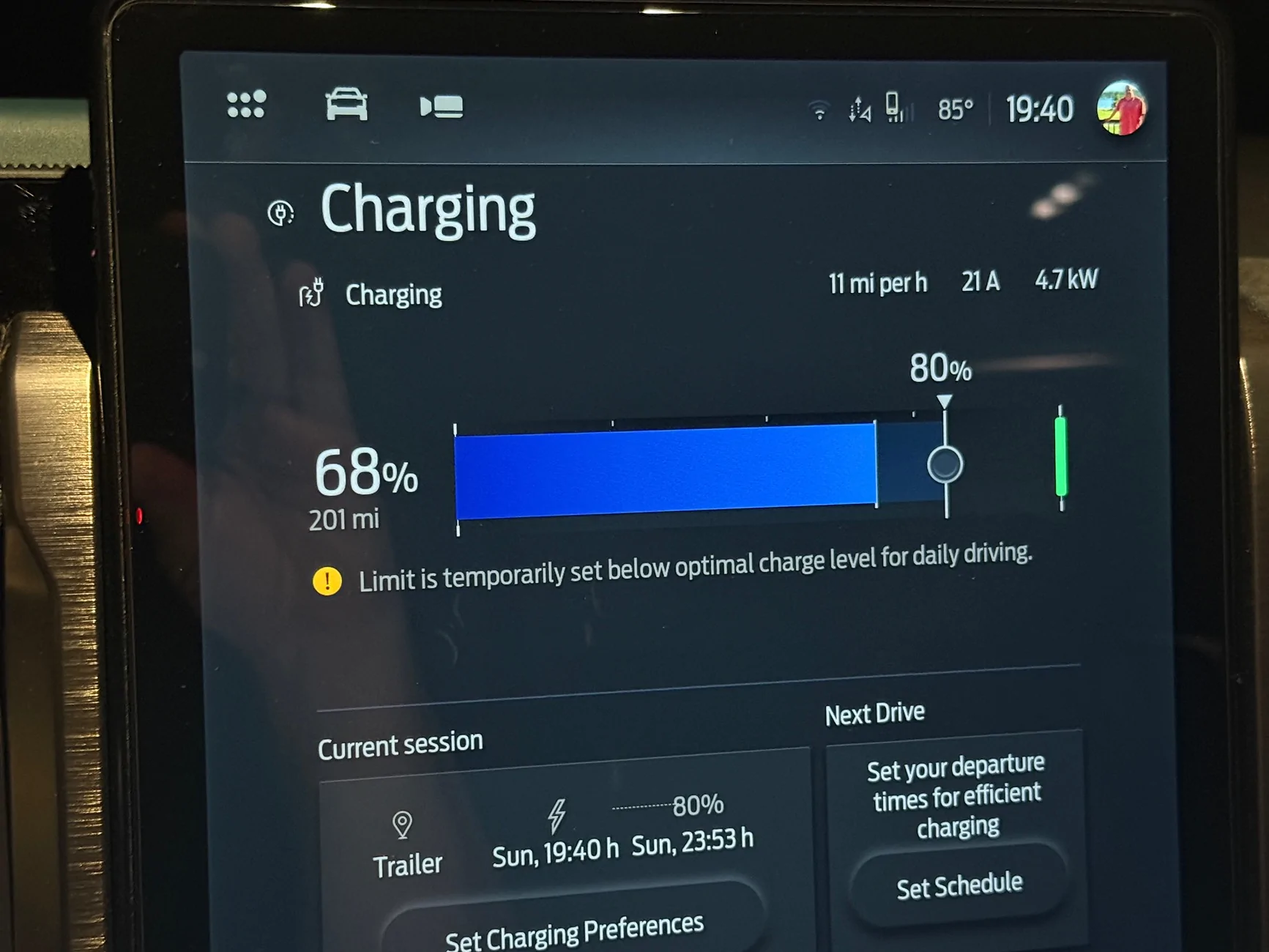

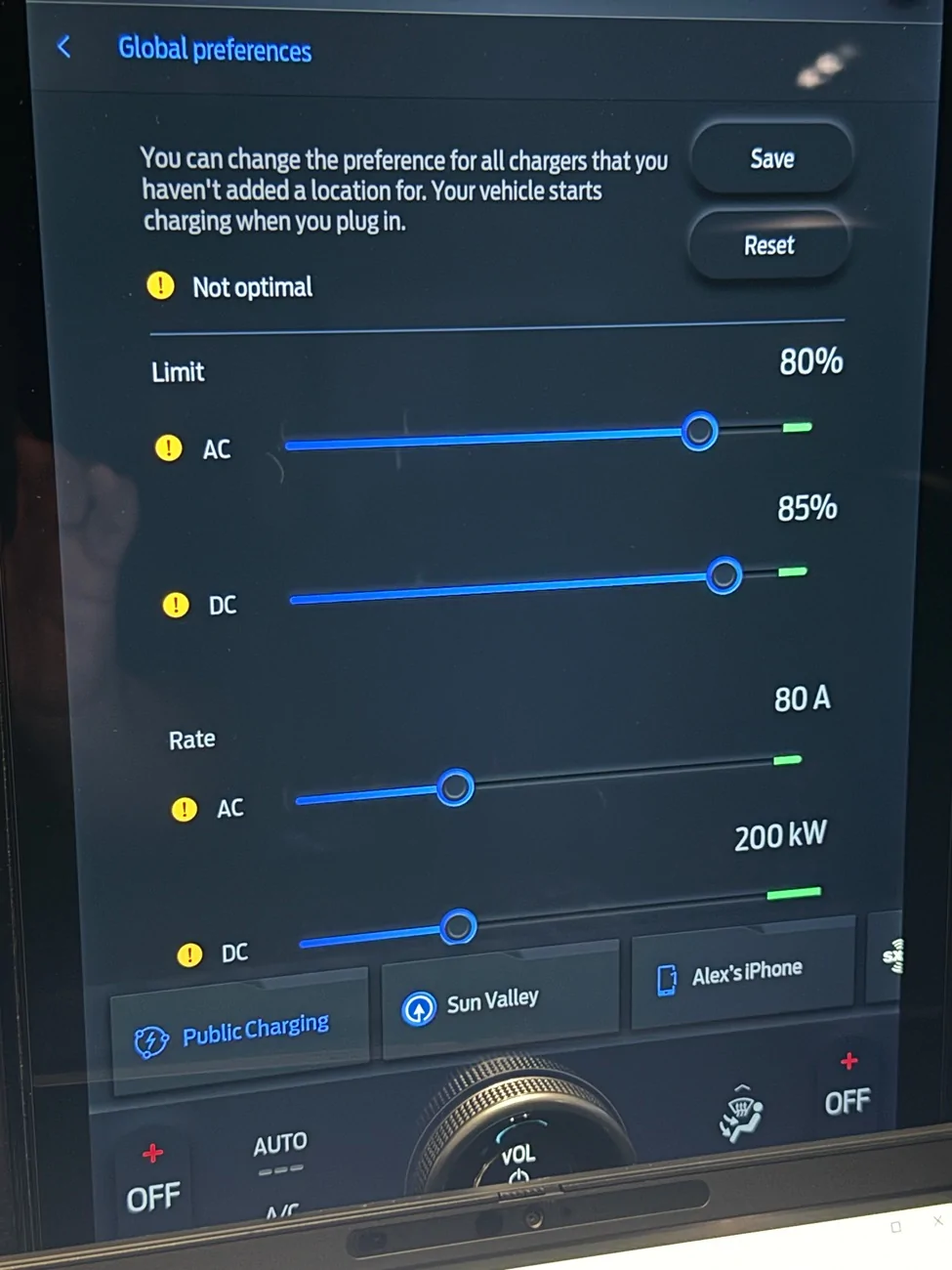

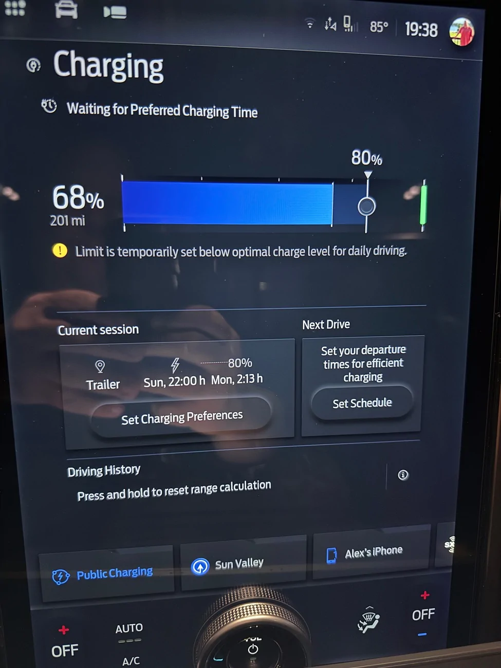

Going to revive this thread a bit. Just made the change to the APIM. Here are some pictures of what I’m getting now. The charge rate does now show up on the screen but weird things like the charge limit going up to like 600kw etc. lol

I get the same. The charge rate seems a little ambitious, about 1kW higher than Fordpass says, yet the amperage is lower than what is set on the FCSP by 4A.
I was hoping we could set the charging targets to something other than the presets, (70%, 80%, 85%, 90% etc) Also the one time charge limit option is gone.

I put the change into place today but reverted it due to inconsistencies. I already have the rate in IPC on my 2023 so I guess I don’t really need this on the Sync screen.
I would like to know if there are some other changes needed to make these settings a little less odd. I.e, like the 100% suggested charge limit, 600+ kW limits.
