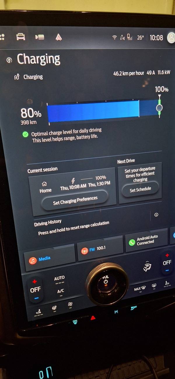

Okay I tried this out. 23 Lariat ER that just had two battery modules replaced a week ago and the EV Tech told me that he updated every module and everthing that could be updated was. Made the zero a two in Forscan. It appeared on my screen and I like the look! I think you could use it daily but it is buggy when it comes to the global charge settings. Any changes to amperage etc will not stick. The best thing to do is press reset in that screen exit and save. Everything will be saved to max even though it doesn't look like it on the main screen. The charge location scheduling and percentage saved just fine. Another bug is that it recommends 100% as the optimal charge level.
Thank You for testing it. That sounds how mine behaved. I played with it some last night
I could turn the location off in the truck and it was off in Fordpass as well. The issue was I couldnt turn the charging location back on in Fordpass only the truck.

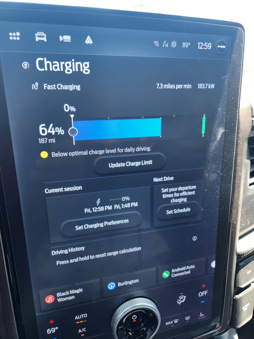

I made the change noted for 7D0-10-4 I had a 4 and changed it to a 6. New menus showed up. Have not played with the settings much. I'm only plugged in to 110. I'll plug in to the 48 amp Tesla charger tomorrow and see if I have any other results, likely not.
I did this a couple weeks ago on my ‘23 Lariat ER. Everything worked out fine, I thought, but the charge rate data fields don’t work. ?

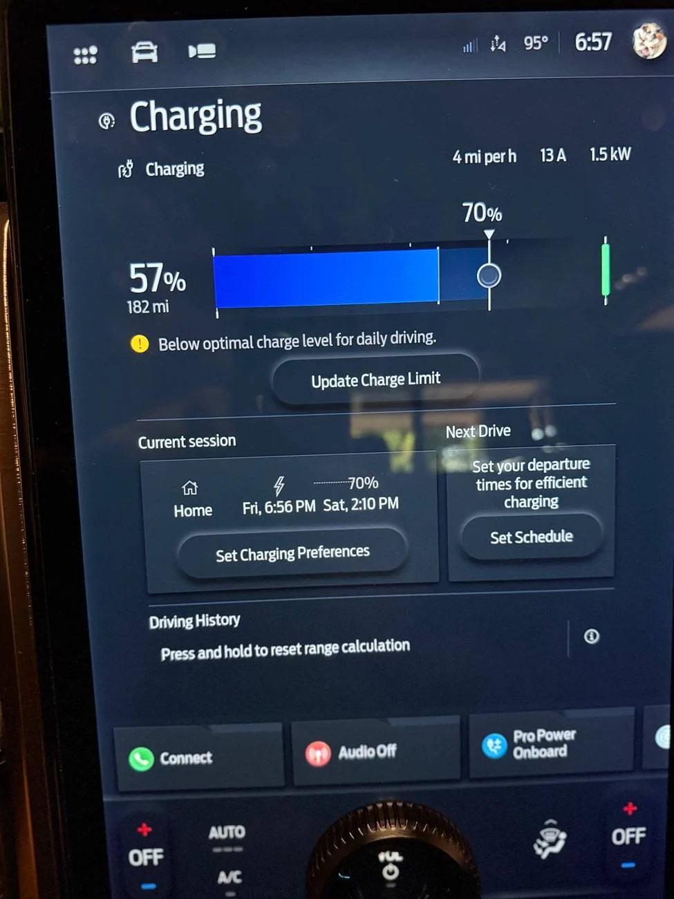

Stopped and verified that it also showed speed when dc charging. Would be nice if it showed amperage and if station limited but will tide me over for now without jumping through hoops to get charging speed on the IPC.
