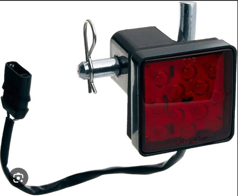

Probably goes without saying, but don’t hook up something like this:
Ford F-150 Lightning Range Projection stuck on towing. IMG_1120
