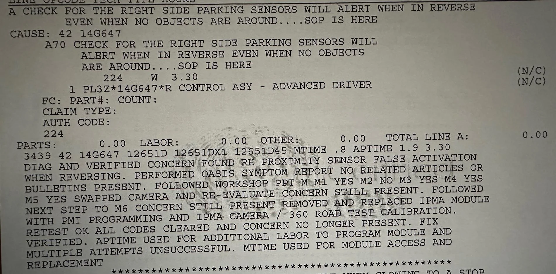

Good thing I kept my service receipt, hope it helps…. Said it was a faulty part (sensor module or something like that), they replaced it and haven’t had any issues since.
Thanks so much for posting. I have this issue, glad to know I won't be wasting my time. I will copy this so that the service can hustle getting it done.
Thank you very much. I will take this to my dealership on Monday.
