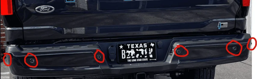

During parking and backing up right side gives a object detection alert when nothing is there. I've looked but try to see whwre the sensor is located. Is it part of the blis I the taillight or does it use the cameras for detection? I can't find a real clear answer on the diffence between the blindspot notice you see in the mirrors and the alert that shows on the 360 view.
I believe the sensors are these guys:
Ford F-150 Lightning Side alerting but nothing there 1703382891874
