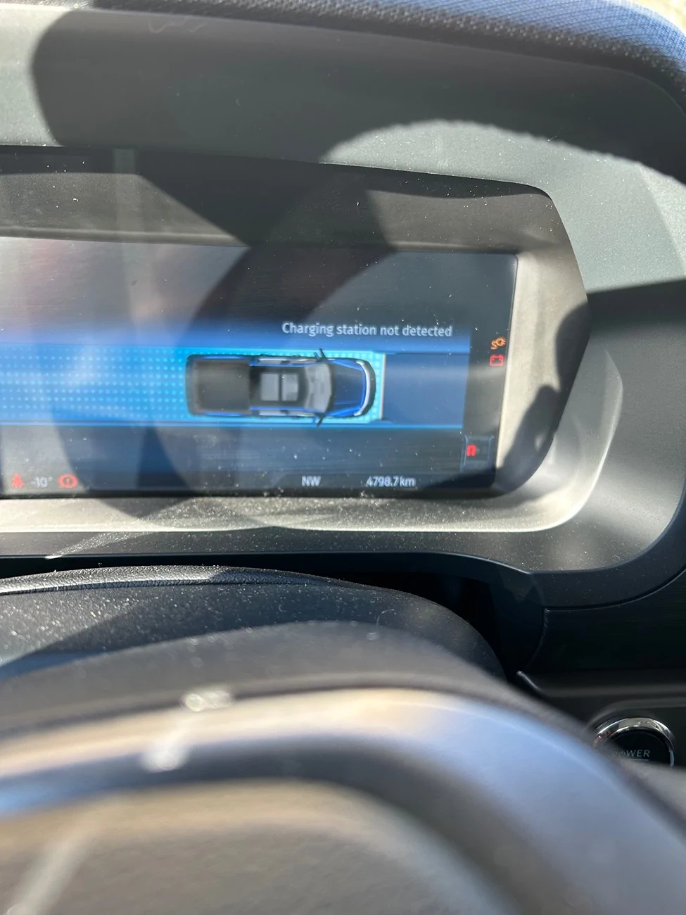

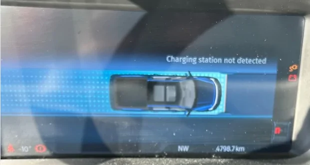

Hey all — new Lightning owner and first-time EV owner as well.
2025 XLT
I’ve had the truck for about two months now and absolutely love it.
I’m hoping to get some insight on a charging / preconditioning error I’ve been experiencing with my home charger and on the dash. The issue seems to occur when the truck tries to prepare for scheduled departure times, and also occasionally after the truck has been sitting plugged in for a day or two without moving.
This started around the time outside temperatures dropped well below freezing (currently around −10 °C). Not sure if that’s causing the problem, though.
When I set a scheduled departure time in either the app or the truck, the next day when it attempts to precondition, I can hear the charger click on and the blower start — but then it shuts off abruptly. I then get:
  • A charging error on the charge station (solid yellow light)
  • “Charger Not Recognized” on the dash
  • Sometimes the red charge-ring-of-death on the truck
What’s interesting is that the truck still charges normally after driving. This problem seems to only happen after it has sat overnight (or longer) while plugged in.
Some additional details:
  • Truck is usually set to stop charging at 80%. The issue seems to occur after it has completed an overnight charge.
  • It’s winter here — consistently below freezing.
  • Charger is inside my garage, but the truck is parked outside. The cord runs under the garage door.
  • Charger is the Ford Home Charging Station.
  • This is intermittent — sometimes it works fine. During a few above-freezing days last week, the issue seemed to happen less often.
My current theory is that once the truck finishes charging and the battery becomes cold-soaked overnight, the reduced capacity is causing the issue. I’m wondering if the truck is preventing preconditioning because it believes it has already reached its charge limit and doesn’t want to take on more power — but I’m not sure.
Has anyone else experienced something similar?
Merry Christmas!
Cheers,
Nathan

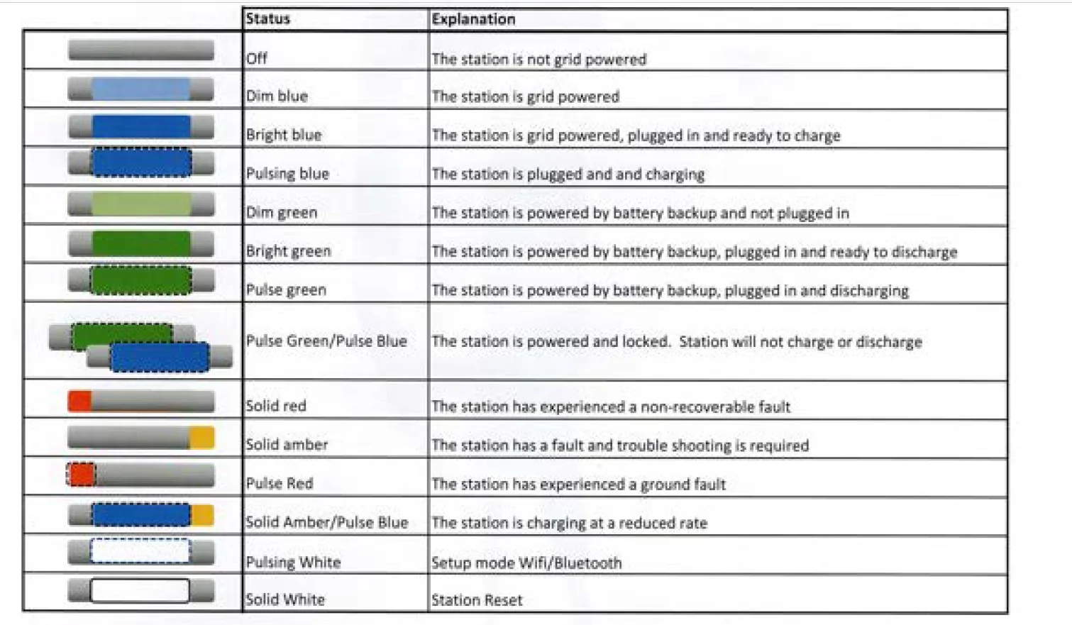

That looks like a Ford Charge Station Pro?
On mine a red status light indicates an unrecoverable fault, and a solid amber a fault, but solid white indicates a reset and pulsing white setup mode wifi/bluetooth.
