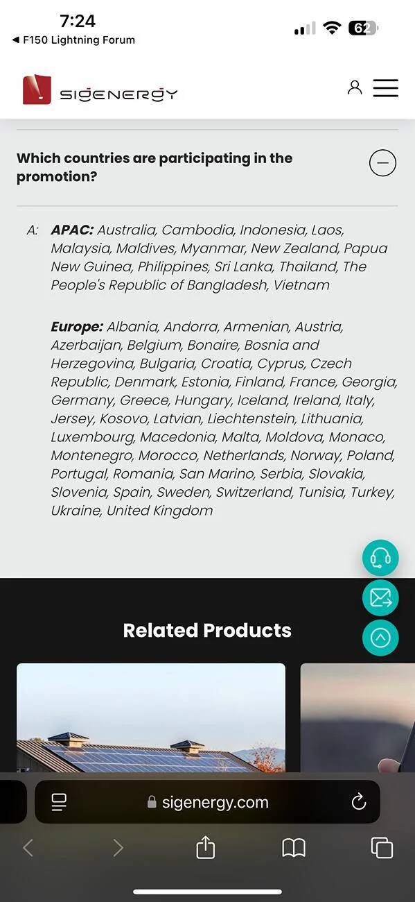

Ford F-150 Lightning Sigenergy (PointGuard) bi-directional system IMG_1399
not available in the US…. Yet.
At least this gives some hope between Nema standards being finally released and many companies chomping at the bit to sell stuff to us!
They have specifically stated there will be a lot more info in 2 weeks and the release for sale is April in the US. It’s already released overseas.
