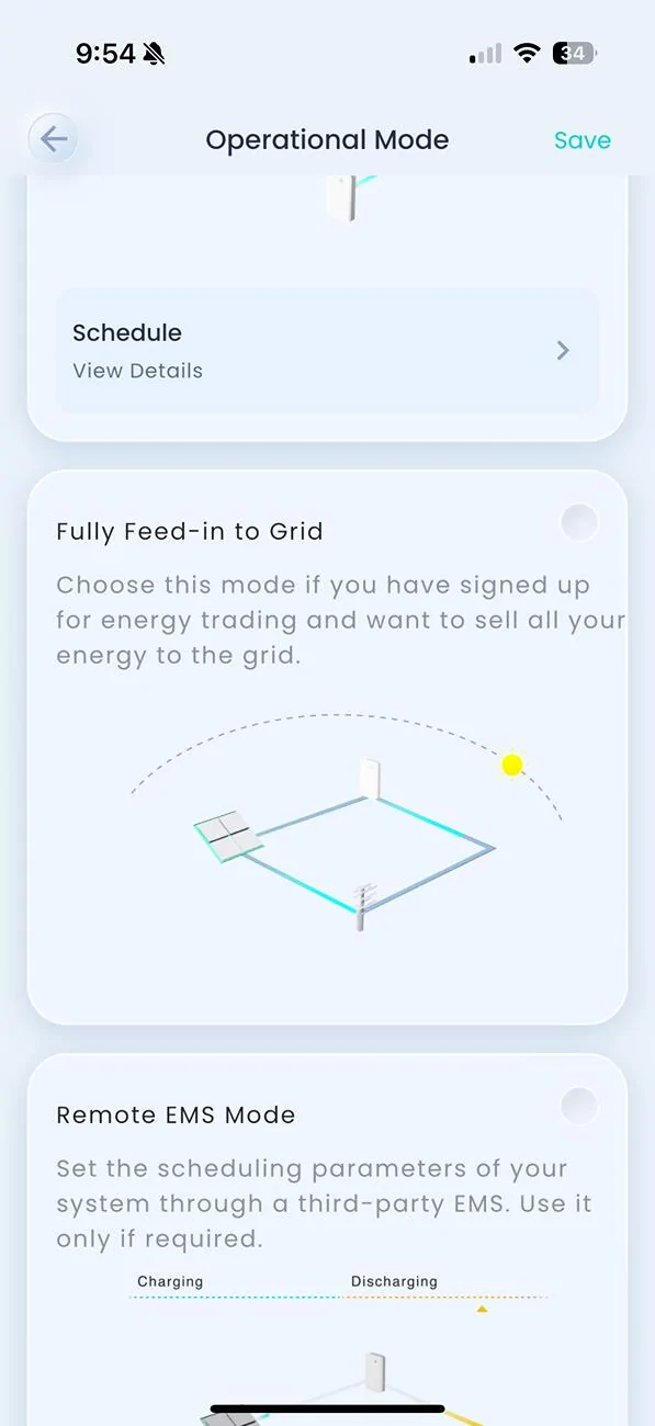

Does PG allow you to back-feed the grid with a bi-directional meter so you can take advantage of a utilities surge demand payment with the battery? (ie PGE has a program were they'll pay you to supply power back to the grid during high demand times)
Yes I believe it can. I have never tried it as I use only self consumption based on time of use but it does have an export mode for utilities that will pay you for exported power.
