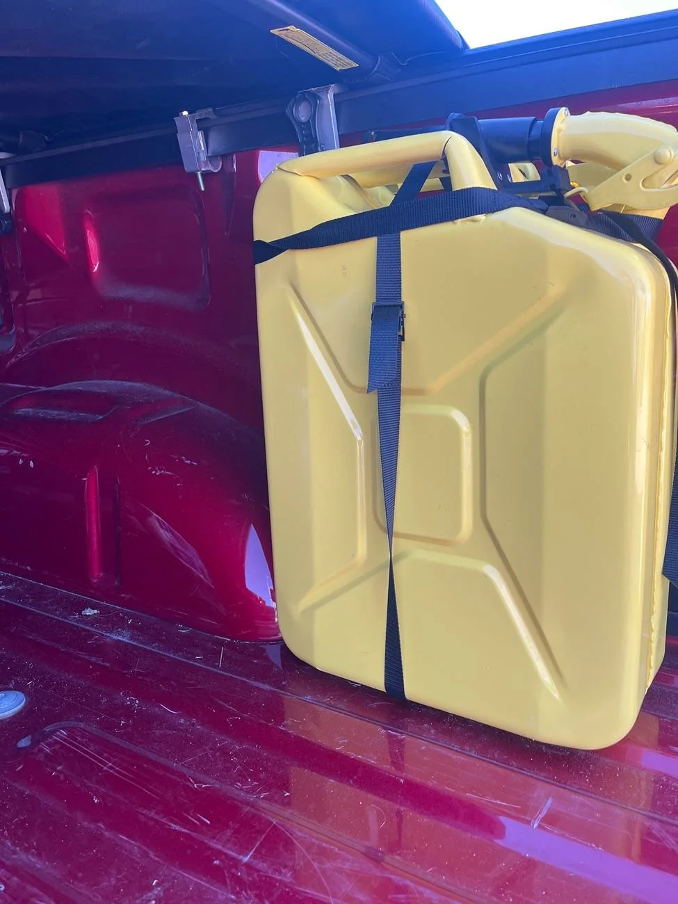

This is probably a bit of an odd question for an EV forum, but we are looking to occasionally transport a 20L / 5 gallon Wavian gasoline jerry can in our truck bed on smooth highway pavement (so no off-road securing needed).
Not looking to install a permanent heavy duty metal bracket with lock of molle system. Just something inexpensive and quick to add/remove so that I know the can is not gonna bang around / tip over under our tonneau cover.
Was wondering if there was something that might work well with the box link attachment? Maybe a couple short cinch straps: one to go horizontally around the body, and another through the handles.?
Other suggestions?
Thanks ?

In the past I have run a ratchet strap around the can to hold it upright against the box link point. I also like running a 2x6 across the back of the bed in the slot close to the rear edge of the wheel wells to keep things from sliding forward.

I pretty much do the same as Broncoaz when I pick up diesel for the tractor. One strap at the top and one at the bottom.
I also stole one of my wife's yoga mats that I lay across the back of the bed to prevent the container, and any other items from sliding.

i ordered this set in 48“ to secure horizontally via a box link anchor, with another strap going through the box link and the handle of the can. I also like the yoga mat idea. Will report back on how it goes.
https://www.amazon.com/gp/product/B09DCB6QC7/ref=ppx_yo_dt_b_asin_title_o00_s00?ie=UTF8&th=1

Strap or bungie through the can handle to the upper anchor point or stake pocket to hold it up and keep it from sliding around.
