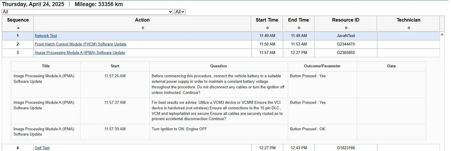

For what it's worth, here is the final report from the Ford rep. Never got anything from the dealer. Doesn't tell me a whole lot but I'm sure many of you will understand it better than me. At any rate, the truck is running fine

@htobin I got your message. It seems like the mobile tech tried to update the IPMA and FDRS crashed in the process. Hard to tell exactly what happened from what I can see, but for sure the IPMA is bricked. Now at the dealer, they have tried to update the IPMA, but that isn't going to work. If what I am seeing is correct (which is difficult without being able to plug into the truck directly), all they need to do is PMI the IPMA and it will recover it and update it at the same.
In the screenshot below, you an see he started the IPMA update, turned the ignition on and hit the OK button to allow FDRS to proceed with the module update. When a module is updated, there is very specific process that gets recorded in FDRS, and in this case, the update process seems to have been interrupted (laptop or software crashed perhaps, or the voltage dropped too low if he did not hook up the battery to a power supply) and the next thing you see is a self test being done. I can tell you with 100% confidence that this is not what a successful module update process looks like in FDRS. If the IPMA is bricked, the truck would still be drivable, but you would get all kinds of driver assist faults on your dash.
When my dealer did the front sensor update, there was an issue with the IPMA that took a few weeks to resolve. My understanding is that it was bricked and the dealer had to work with Ford to come up with a solution. The good news is that the truck was successfully fixed. The bad news . . . I missed having her.
Chances are it is the same issue and it could have been fixed right away with a PMI procedure.
