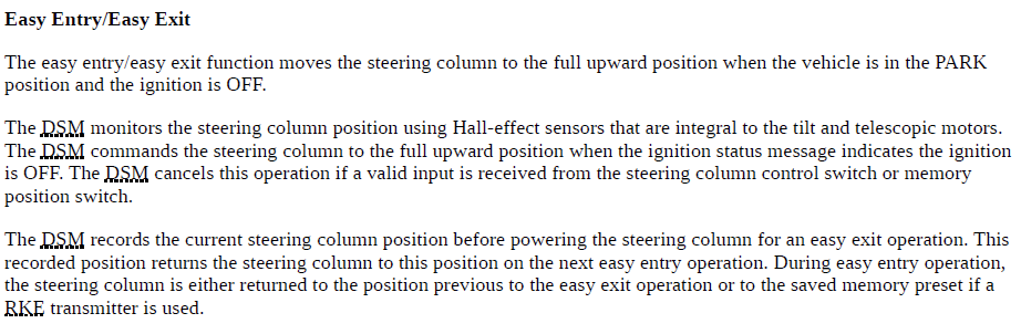

Steering Column System Operation excerpt:
Ford F-150 Lightning Steering wheel with Easy Exit 1754529276005-o7
