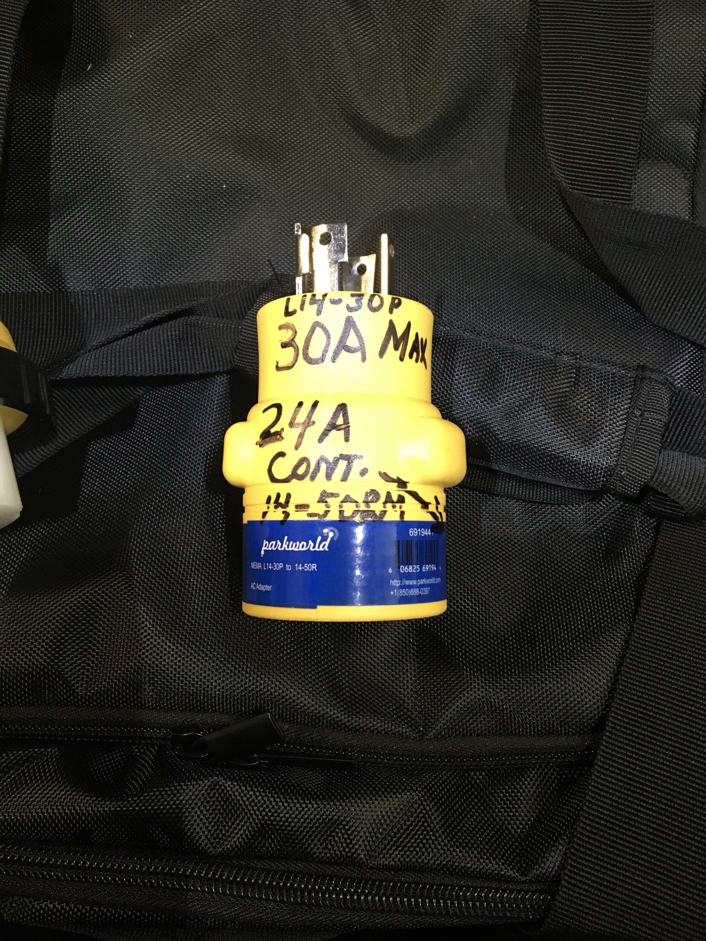

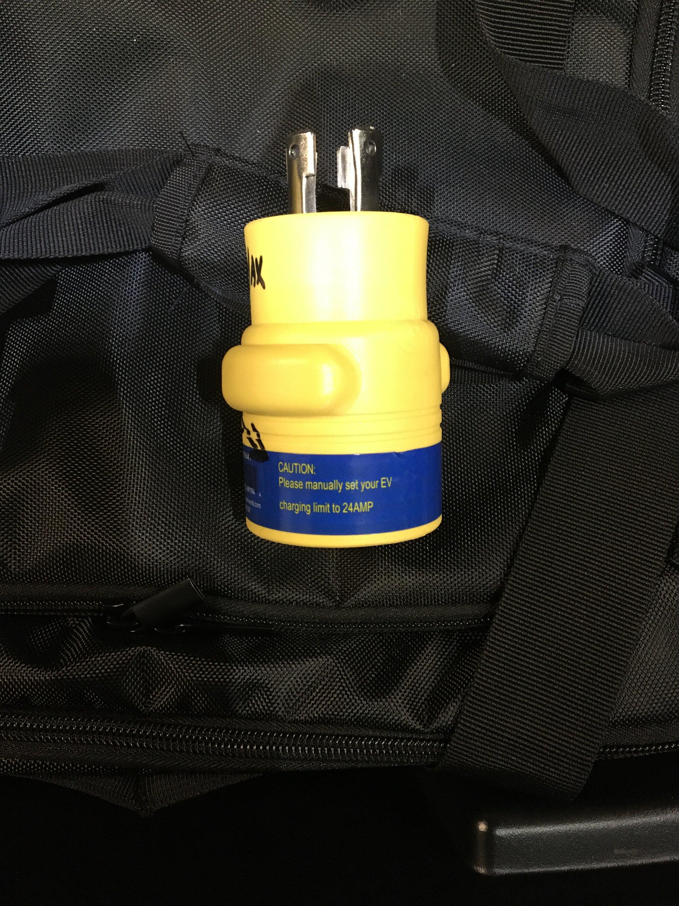

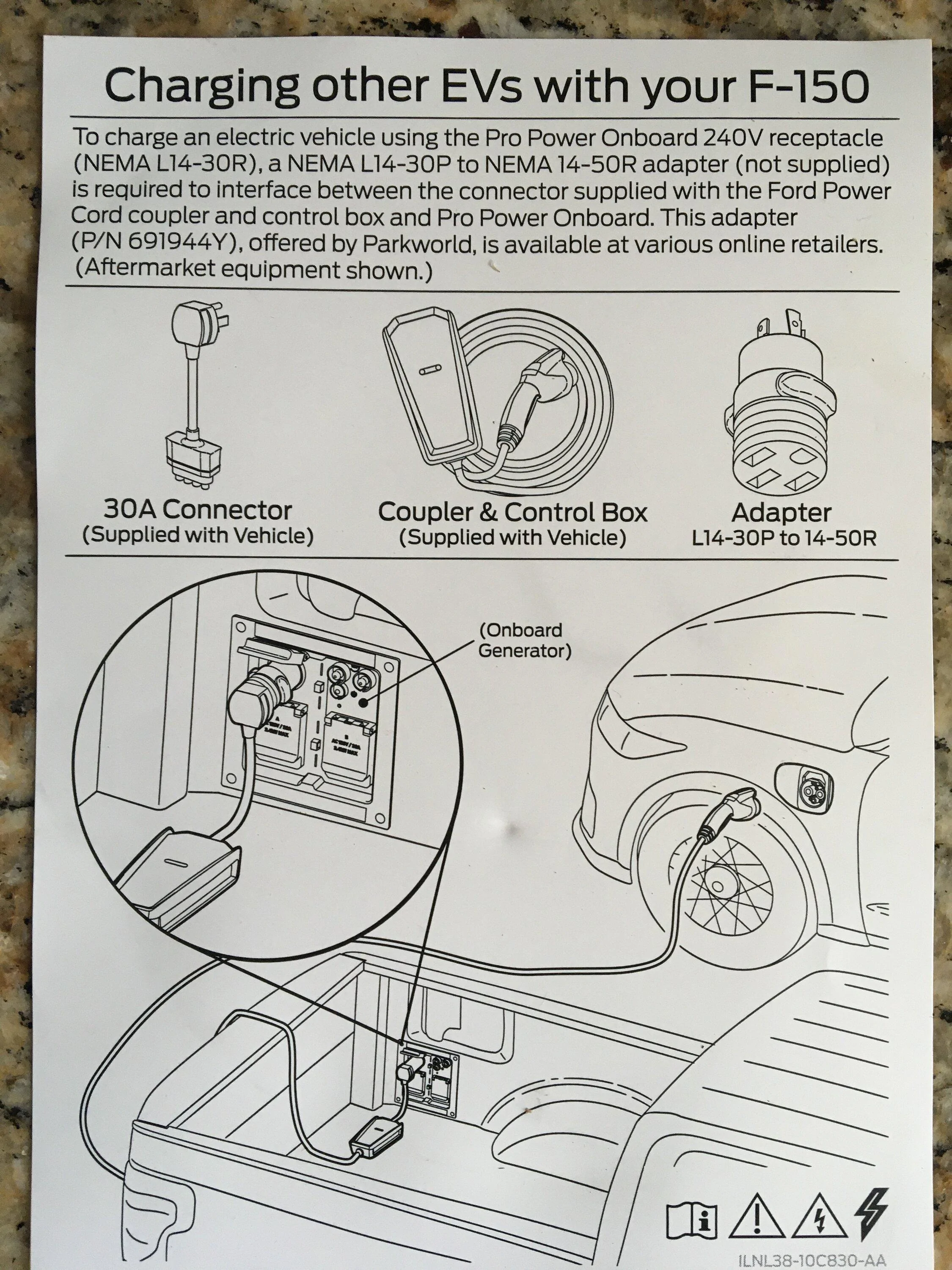

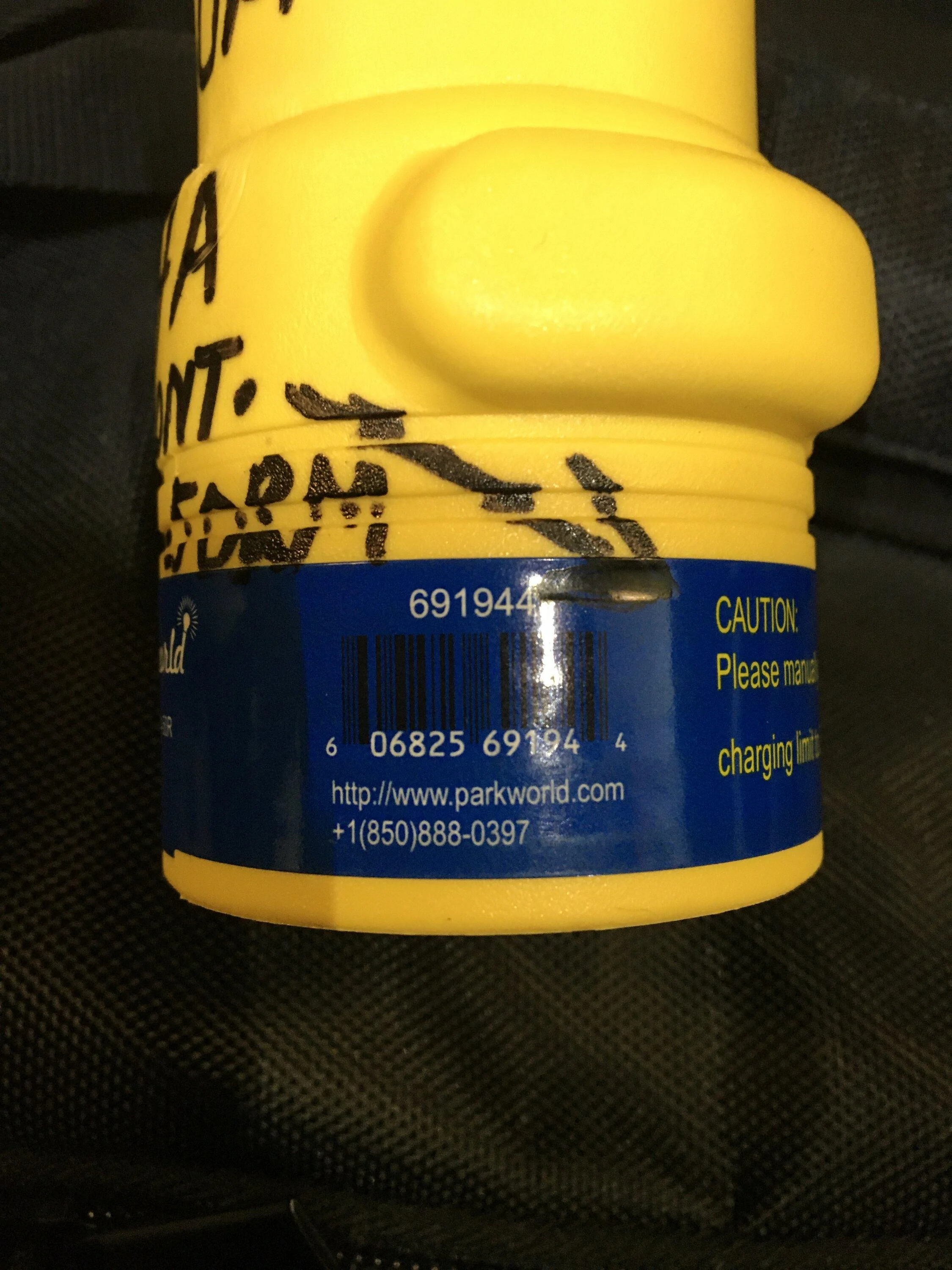

Easy man on calling BS on @FlasherZ …. He’s giving you facts.
I’ve posted on this issue before…..Ford Marketing forgot to talk to Ford Engineering on the ProPower’s capabilities, and Ford’s own written documentation that comes with the truck indirectly backs up what @FlasherZ is telling you (see attached photos).
I agree with the BS, but you’re throwing it in the wrong direction. The Parkworld NEMA L14-30P to NEMA 14-50 R adapter accessory that @Ford Motor Company recommended for the use of ProPower for EV charging specifically calls out the 24A limitation/warning when using the charging an EV (I marked mine up to remind me of this)…but, everyone will do what they want…and can afford to take risks to do………

Isn't also just a little bit of an oxymoron that neither the Ford chargers, nor app, nor vehicle allow you to dial that draw down to the 24 amps, so good luck with that.
Oh yea, good point….I forgot to mention that very important issue!!!
Hmm, add this to 120V charging fixed to ~11A regardless of circuit amps provided….a few practical charging scenarios not considered….or, well thought out.
Over promised….undelivered on L1 and L2 charging …….
In the OP’s case, he was charging a Tesla, which can be dialed down.
So the Lightning can safely charge a Tesla, but not a Mach-E! ?

Points taken from both of you EXCEPT that Ford and some others provide no mechanism for setting charge rate, so booyah, checkmate. Great advice with no practical application. You want to give your buddy with a Lightning a charge? Take your chances is what you are saying, because Ford's engineering and marketing are f'd up. No surprise, but my point was that Ford DOES say you can charge EVs with our trucks. Flasher says the supplied 30 AMP outlet isn't safe under code specs and the outlet manufacturer's specs for doing a continuous charge. And yet there's no way to de-rate a charge on many chargers, including the supplied Ford mobile charger, which IS 30 AMPS.
Many of us now have the needed adapter to supply a charge to either our truck from someone else, or to someone else. Flasher says that's out of spec. Ford very specifically says it isn't, except perhaps in very obscure contradictory fine print that you'd have to be an electrician to either find or understand. Meanwhile there's a big color brochure showing continuous charging with that very outlet, again with no provision for setting rate. So yeah, I gotta call BS unless or until Ford sends out an alert or provides a recall notice with a bold yellow sticker, or alternate outlet format that is compatible with safe continuous charging at the provided amperage. Because what Flasher is alleging is that Ford has sold us a product that is likely to cause fires as demonstrated in its marketing, and is unsuited for purpose, a serious legal conundrum for them if true.
True, but it is sad that Ford shows the rendition of their portable charger in their instructions that come with that charger that can’t be used with the adapter they recommend ?…….
