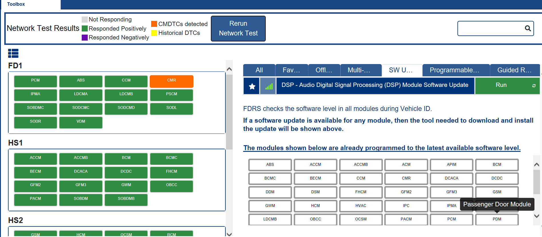

Purchased a 2 day FDRS pass and Mongoose to get the latest SW interface and PAAK. Did all the modules last night and did not have any issues, however I still do not have the interface . Some updates did go through as it looks like I am on 4.0.22294 and I know have PAAK.
Only visible issue I see is the CMR (CMDTc detected; whatever this means) and the DSP module will not update. (did this several times).

The CMR DTC can be cleared using the "Clear and retest" button (after you've already chosen "View CMDTCs" first.
The DSP update package is not clearing off the available software list for anybody. I did it yesterday and even after "Rerunning the network test" (button on the toolbox menu) it didn't clear. Neither did shutting down FDRS and then re-launching (which has been known to do the trick). So this is a lot like the TRM module the F-150 folks had problems with a while ago. It just stayed in the list. If you've run it already and it was successful, don't keep re-running it. Just ignore it.

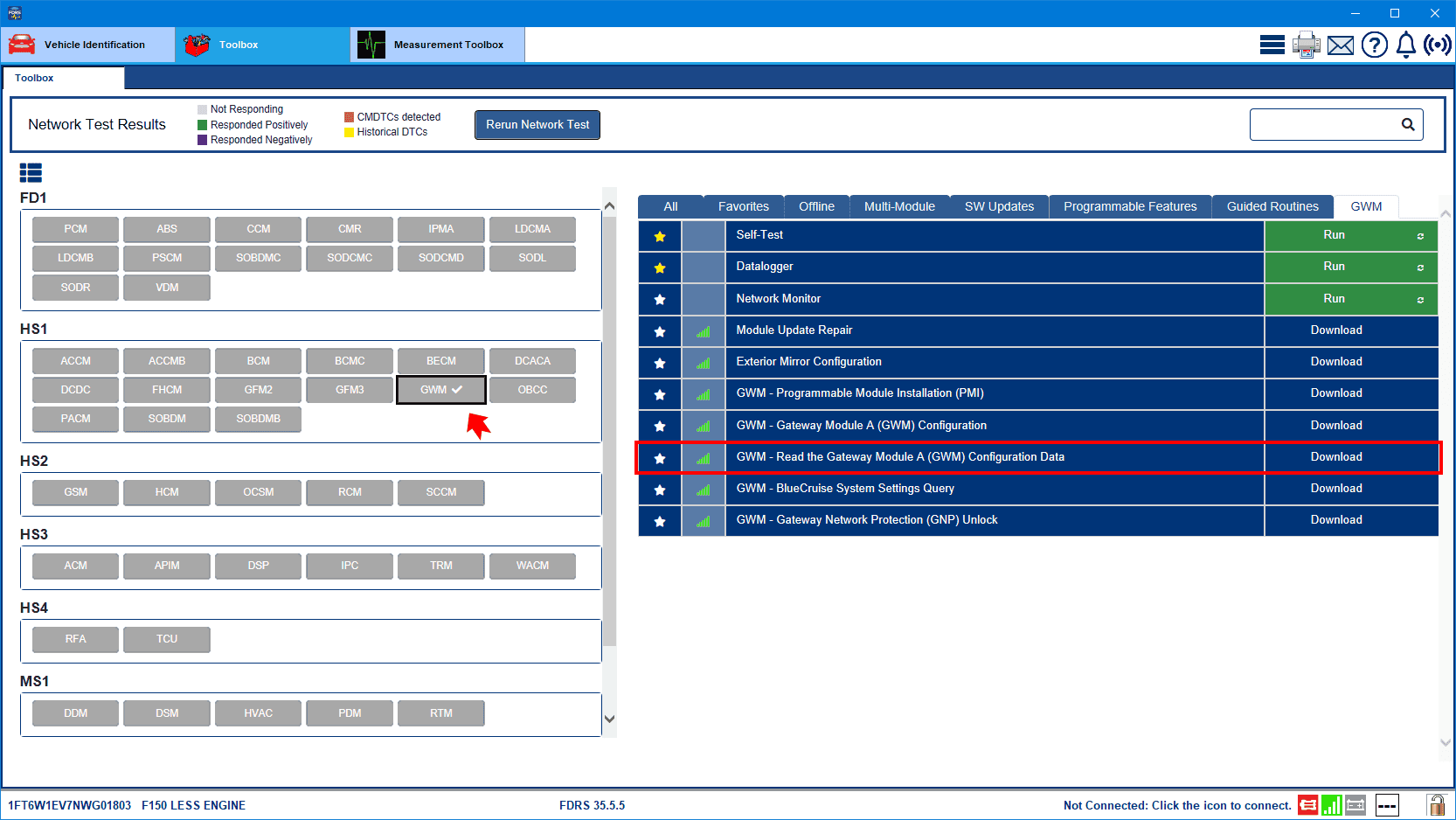

On the Sync update issue....
You might try reading the gateway config first and then re-running the network test button after that to see if that brings anything up on the list.
First go to the toolbox screen and find and select the GWM, and then that filters the tools in the right side panel from which you select the "Read the Gateway Module A (GWM) Configuration Data" tool. Select Download and then Run.
Ford F-150 Lightning Sync Update / FDRS Help Read_GWM_Confi
And then after that finishes you'd click the "Rerun the Network Test" button to see if that brings up anything new (GWM, APIM, hopefully).
