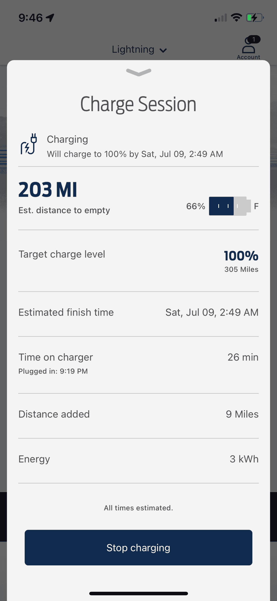

After issues yesterday I tried it again tonight. Currently at 26 min no issues. Fingers crossed it was just a fluke. Would still appreciate feedback if anyone sees something wrong with my in the meantime set. Thanks

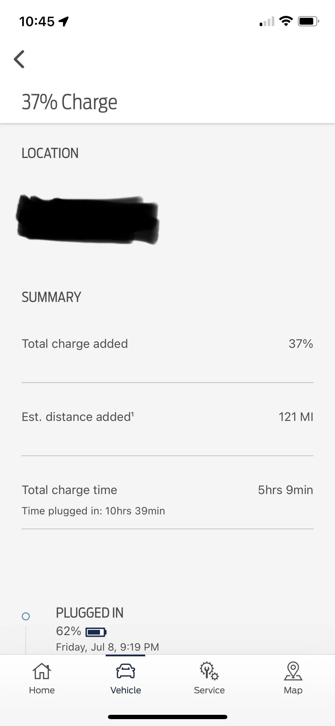

Thanks for all the information. This forum has been a great resource.
Im not sure what the problem was on my first attempt but since then I have charged with zero issues. Attached photo shows last charging stats.

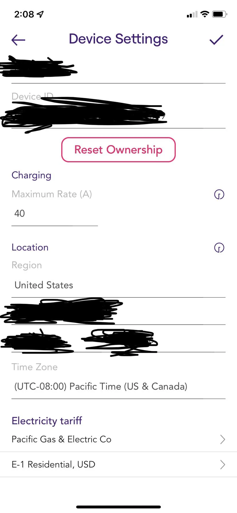

I also have a juicebox 40 amp charger on a 60 amp circuit breaker to charger my lightning. Since charging is the least expensive for me during 12am-3pm everyday, that’s when I charge my lightning. My circuit breaker has not pop yet since charging the lightning.
I suggest that you go to the juicebox setting and set it to 40 amp and then go to your lightning setting screen and also set that also at 40 amp. Do that and see if that will work for you when charging the lightning.
Here is a screen shot of the device setting for the juicebox.
