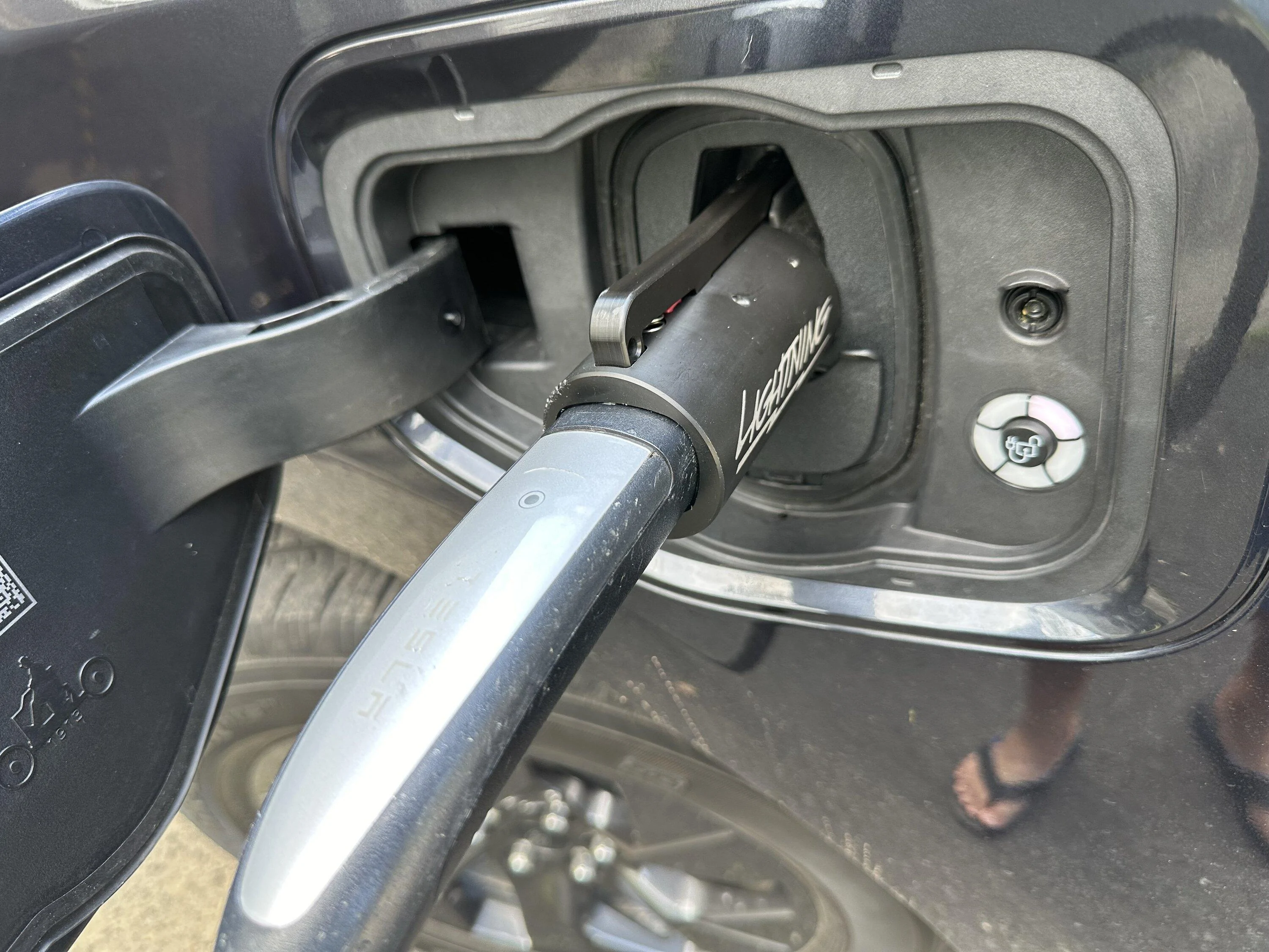

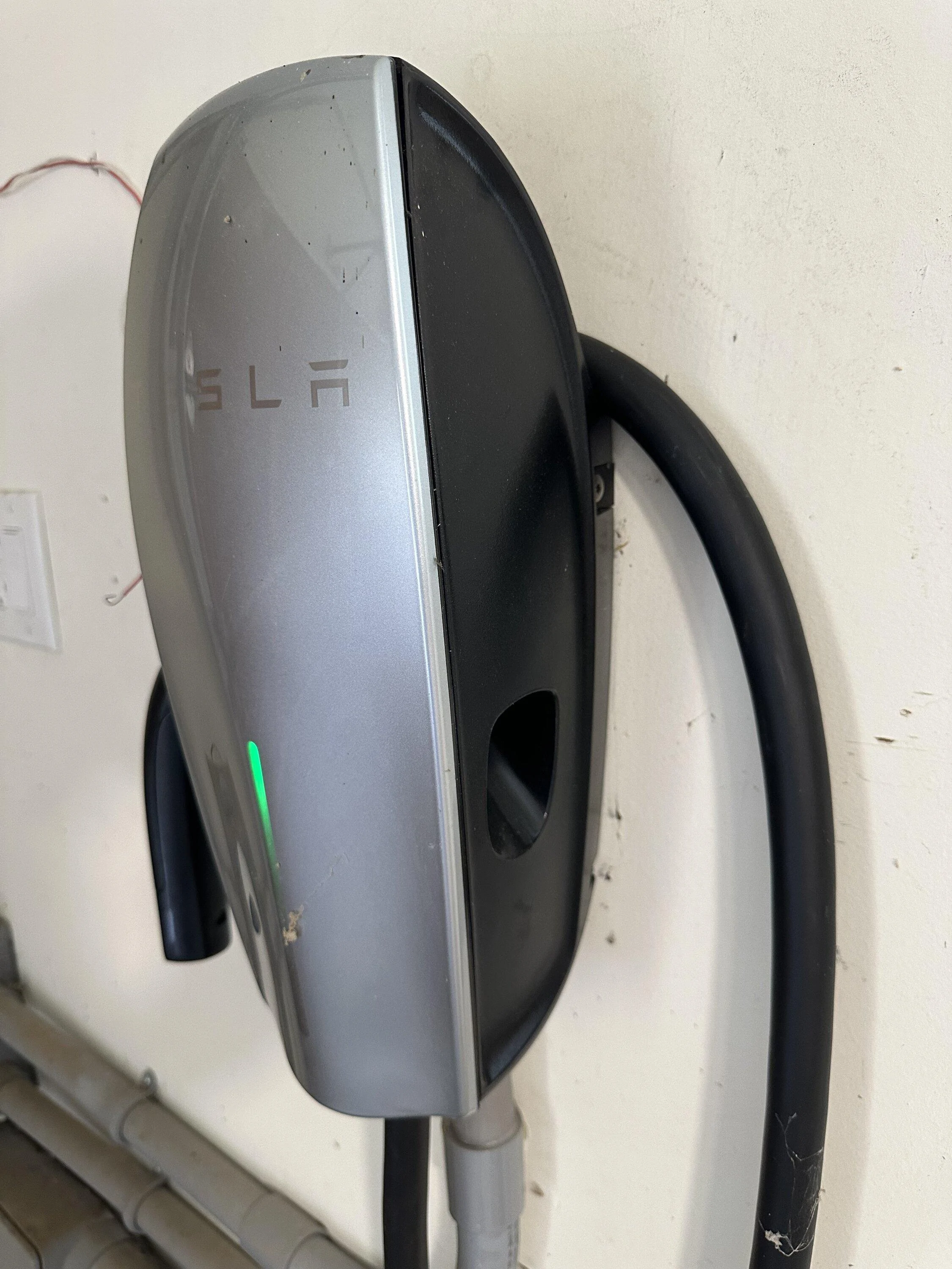

Here’s some pictures of my equipment:
Ford F-150 Lightning I have a Tesla wall charger with adapter 80 amp how can I check to see what it is delivering? IMG_4384
Ford F-150 Lightning I have a Tesla wall charger with adapter 80 amp how can I check to see what it is delivering? IMG_4383
To note, I did not start off with a Teslatap. I started off with a Lectron which worked…but even at 48A tripped my charger heat sensor several times.

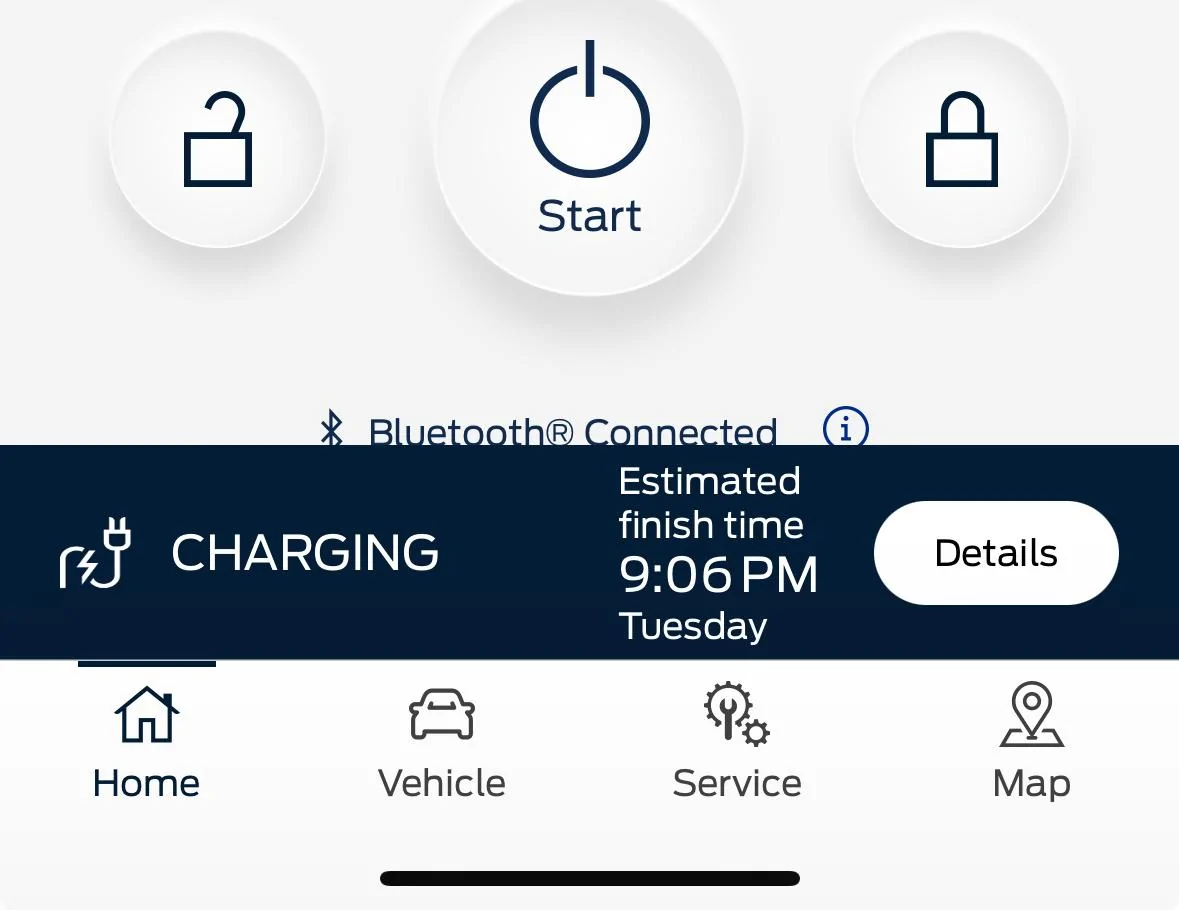

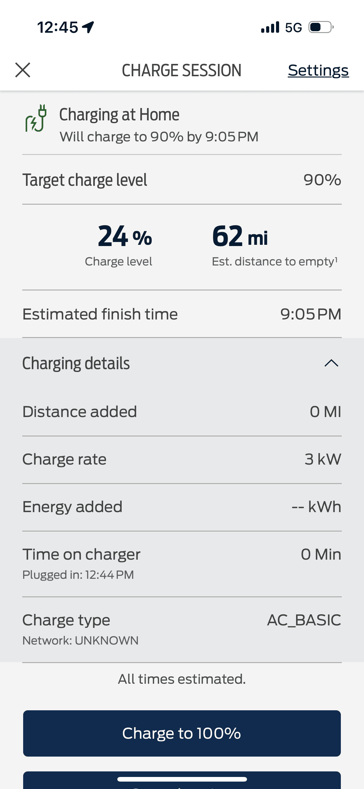

Here’s my app immediately upon plug in showing 3KW.
Ford F-150 Lightning I have a Tesla wall charger with adapter 80 amp how can I check to see what it is delivering? IMG_4385
It ramped to 6KW within 30 seconds and -4KW within one minute - temps were favorable. It’s taken as much as 10 minutes to ramp before.

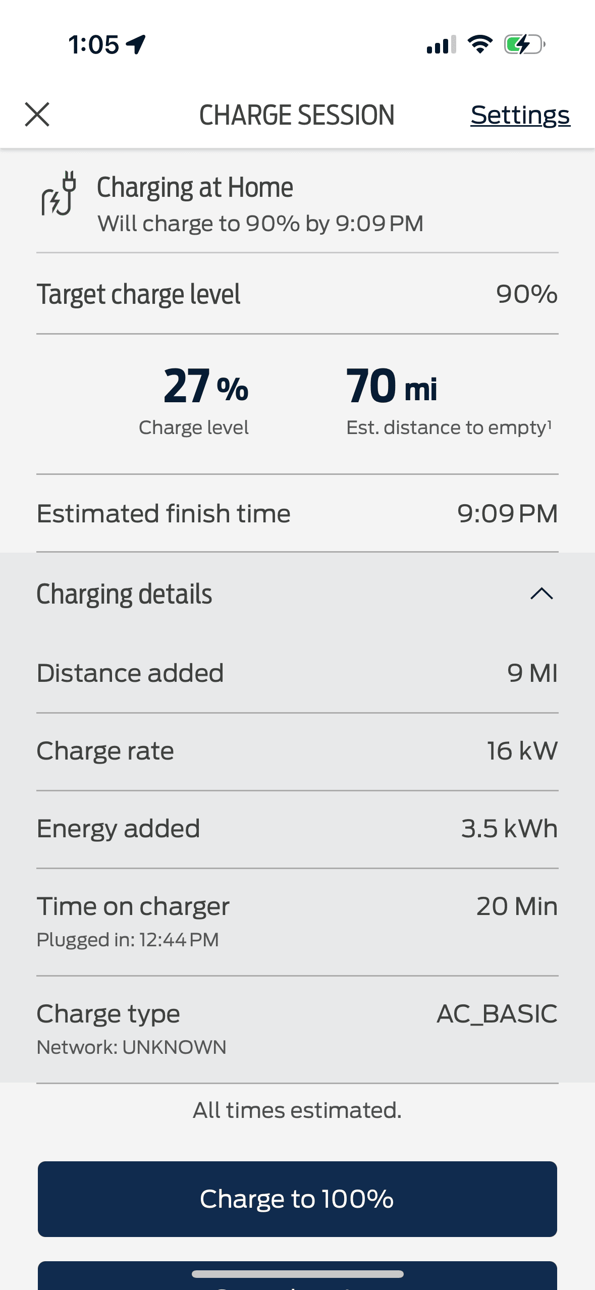

The truck paused to do an update before eventually hitting the 16KW I’ve been accustomed to seeing.
Ford F-150 Lightning I have a Tesla wall charger with adapter 80 amp how can I check to see what it is delivering? IMG_4387
Idk about android. But on an iPhone you can get there by clicking the details button
Ford F-150 Lightning I have a Tesla wall charger with adapter 80 amp how can I check to see what it is delivering? IMG_4388

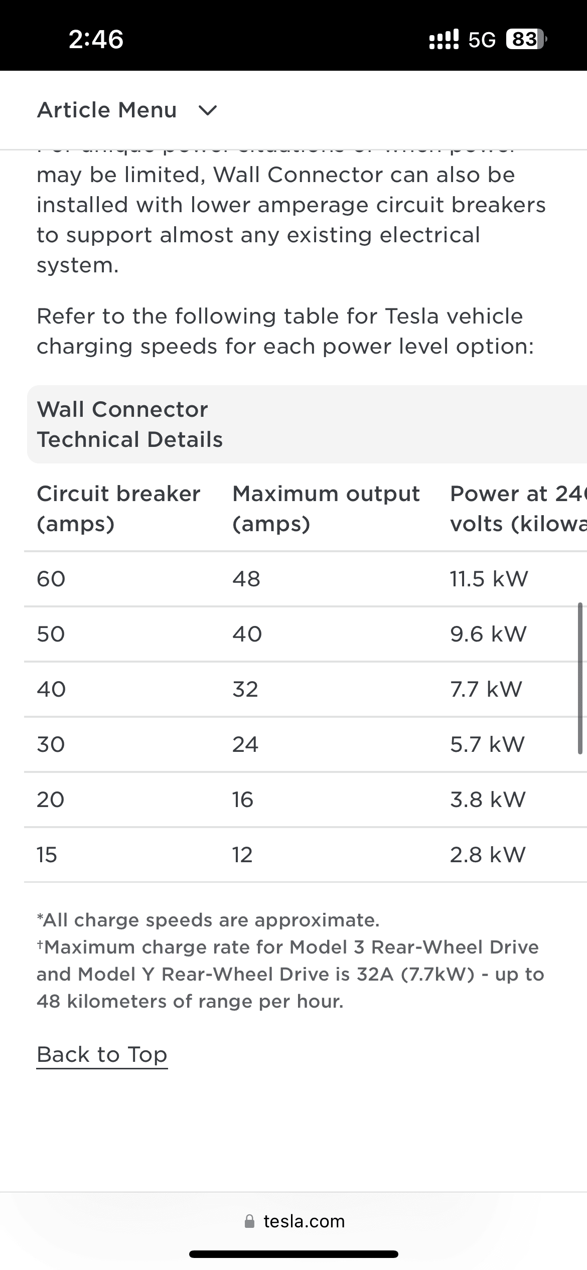

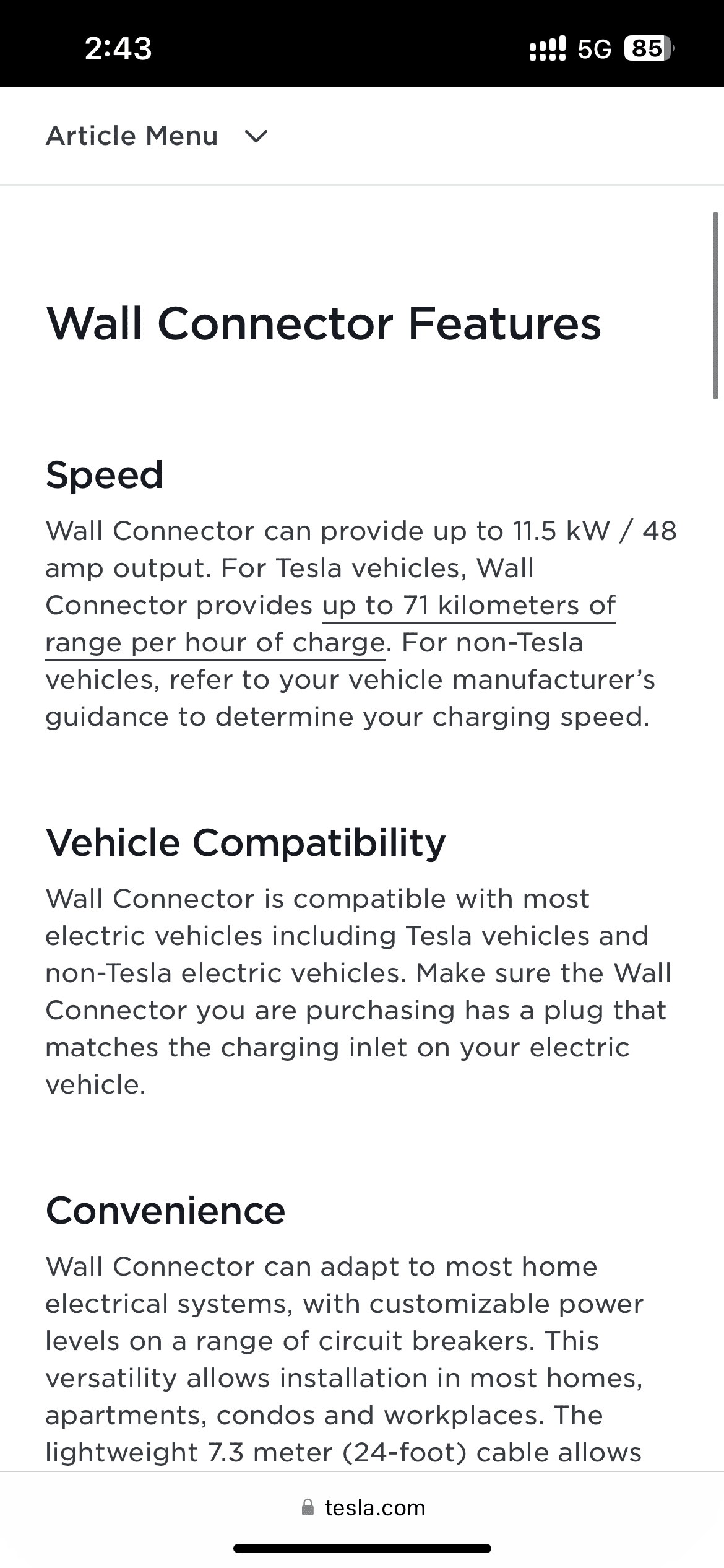

Ok, didn’t know the CCS pins scenario. But this is right from Teslas website…
Ford F-150 Lightning I have a Tesla wall charger with adapter 80 amp how can I check to see what it is delivering? IMG_6297
also here,
everything seems on the up and up. Lastly to anyone that does not know, in the wall connector software you also have to set the amperage of the circuit. But looks like it’s set correctly for 60 which is max.

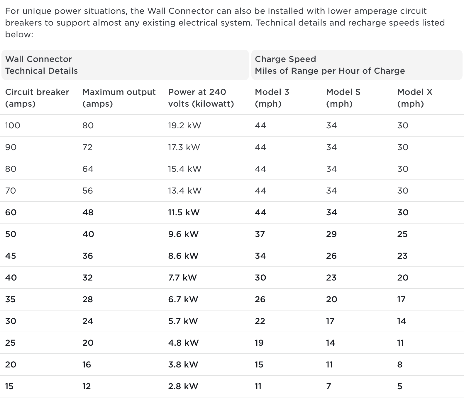

also here,
You just keep doubling down huh?
You're quoting Tesla's website..but you're late to the Tesla party. By the time you got in, Tesla nerfed the chargers and the cars. As an OG Tesla owner, let me link you to the Gen 2 details here:
https://www.tesla.com/support/charging/gen-2-wall-connector
Ford F-150 Lightning I have a Tesla wall charger with adapter 80 amp how can I check to see what it is delivering? 1695687681760
If you're still skeptical, feel free to refer to post #32 where I posted a picture of my 80A enabled Lightning using a 80A TeslaTap Adapter, on my 80A Gen2 load sharing Tesla Wall Connector.
Also...wireless/app capability only started on Gen3. Not available on the Gen1 and 2. We poor unfortunate souls had to open up the wall connector to manually set the dial. You can find the instructions here, as well as see that the "D" setting is for 80A output: https://www.tesla.com/sites/default...tor_installation_manual_80A_en_US.pdf#page=23
And since OP said he installed the wall connector in 2016, it would either be a Gen1 v2, or a Gen 2 wall connector. Both of which are 80A capable.
