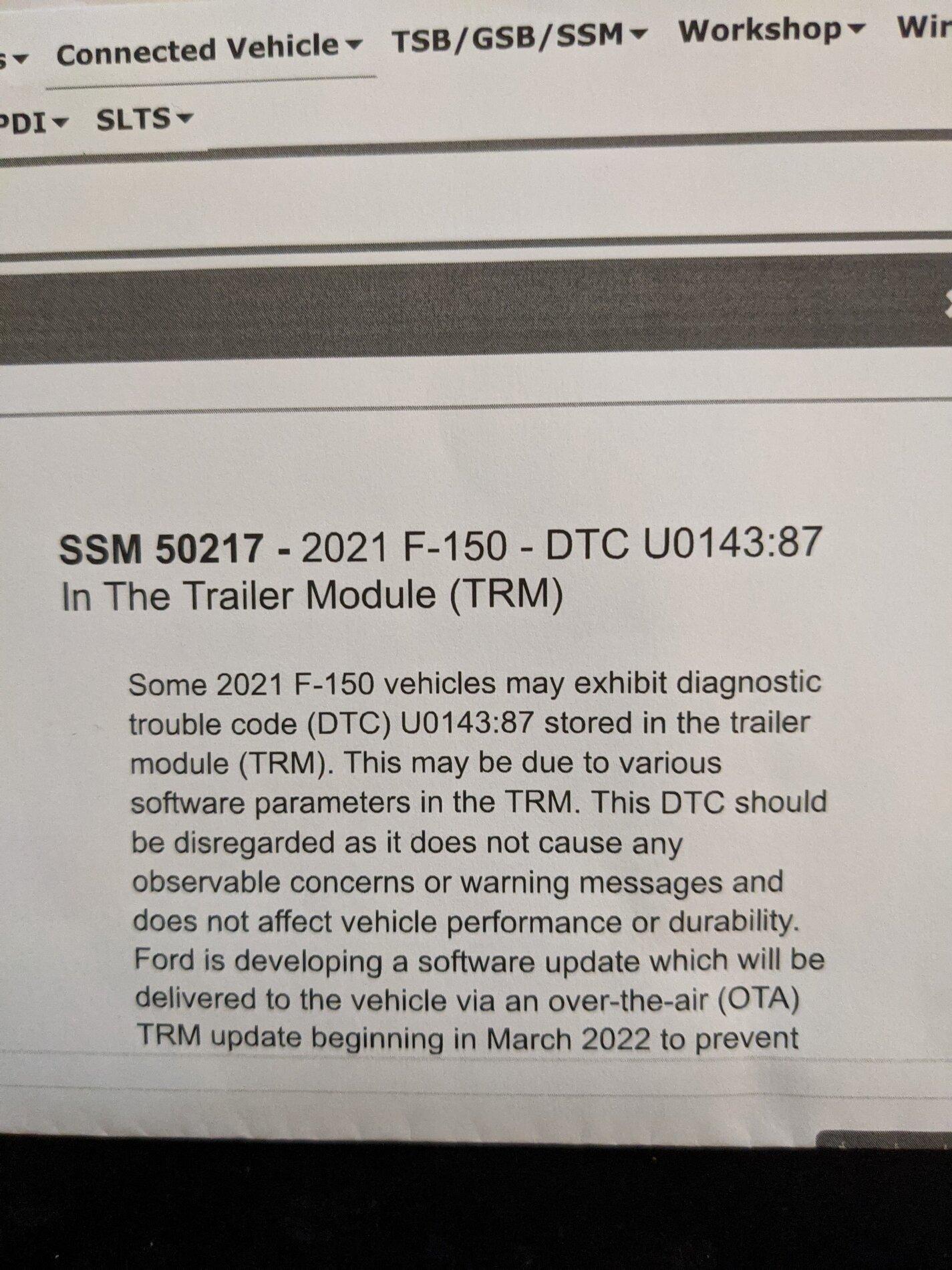

We'll some news. I took the truck in today for the diagnostic as directed by Ford (as per my interactions with the social media agent on this site). The service advisor told me that Ford has issued an SSM (see below)… and that I should wait until March. My concern is that the SSM states that the DTC "does not affect vehicle performance" so not too hopeful.
Ford F-150 Lightning Trailer brake not working PXL_20211026_164207767
Wait FIVE months ? wow
