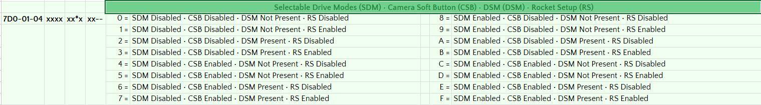

Check this setting:
Ford F-150 Lightning Turn Signal on Camera while towing - Drive modes gone 1736206260361-u9

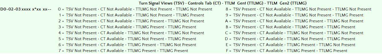

For 7D0-02-03, based on Livinup's spreadsheet, you want to add 8 to the previous value to enable TSV. What value did you have there before?
Looking at Lightning As-Builts, Pro XLT had 0 while Lariat have 4. So you would want a "C".
Edit: If you changed it from a 4 to an 8 you would have disabled Controls Tab.
Ford F-150 Lightning Turn Signal on Camera while towing - Drive modes gone 1736207206090-vu
