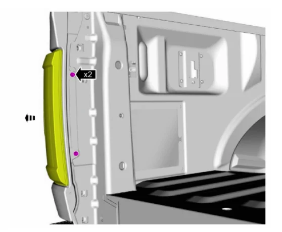

Great info, I will look into this. How do I remove the tail light assembly?
3,128
4,491
Super simple. Open tailgate and you'll see 2 bolts heading to the tail lamp (8mm I believe). Remove those and then pull the taillight straight back. There are some clips that have to come loose. So the first time may be a little struggle.

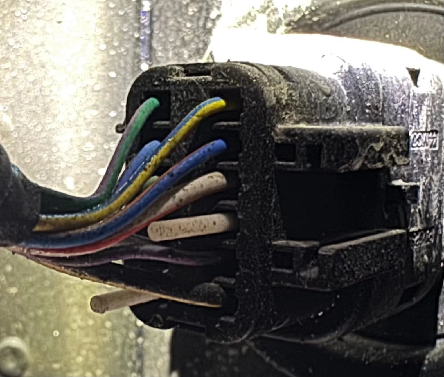

According to the diagrams there should be a (GN-OG) 18 ECU - TURN LAMP RIGHT REAR, that is missing here (lower left). The (BU-OG) 22 LAMP - TURN REAR RIGHT # SIGNAL OUT is present.
Ford F-150 Lightning How to adjust rear turn signal tempImageiMqyA2
3,128
4,491
Sorry I confused you. The first diagram I sent you in post 15 was for the Lightning (BEV). It does not have that circuit. Then in post 16, I attached an example of a truck that does have that circuit (CLS27 GN-OG wire). My point was that some F150's have it and was hoping maybe it was present on the Lightning but not used. Looks like it doesn't.
And the SIGNAL OUT circuit CLS54 (BU-OG) just tells the truck that a bulb is burned out. You can't use it for turn signal activation.

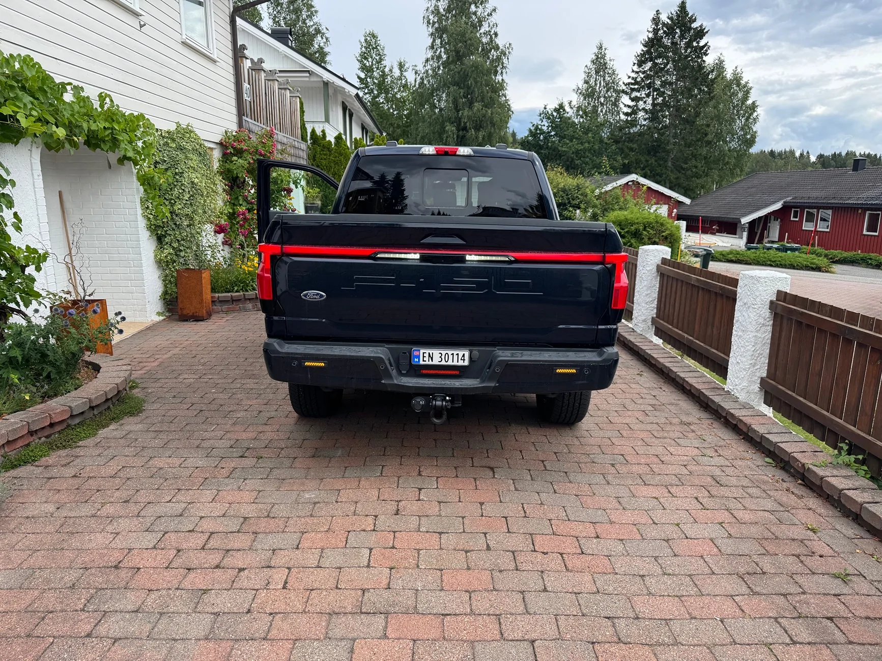

How is the blinker wired? Is it the DRLs that blink, or the brake lights?
I would like to enable the red DRLs in daytime with Auto selected at the light switch. And then blinking when I am turning (either the drls or the brake lights).
3,128
4,491
Over here the DRLs turn amber up-front. And the brake light blinks. Also for your trim, there is a light in the mirrors - maybe tie into the mirror?

In the front it always a light on. So I just want to enable the tail-lights to always be on in auto.
I found this in ForScan, mine was set to 1, tried 4, but no change. Maybe there is another setting that should be enabled at the same time?

Added "Daytime Running Lamps Control Function" and "Tail Light" in APIM, in the "NOT built-as".
That added a "Daytime Lights" in my lights control on the center display, and toggling that gives me red tail lights at daytime in Auto. Success.
