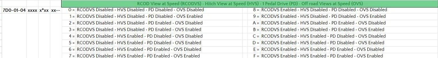

@Gerstein1989 - note that Lightnings will have a "A" or "E" in that position. 22-23 Pros have an "A" - I guess they don't have a hitch camera. All other have an E.
This APIM setting can also disable the One-Pedal option in Sync. Bottom line - if you have an "E", make it an "F".
22-23 Pros with an "A" would change to a "B".
I’ll give it a try and see
