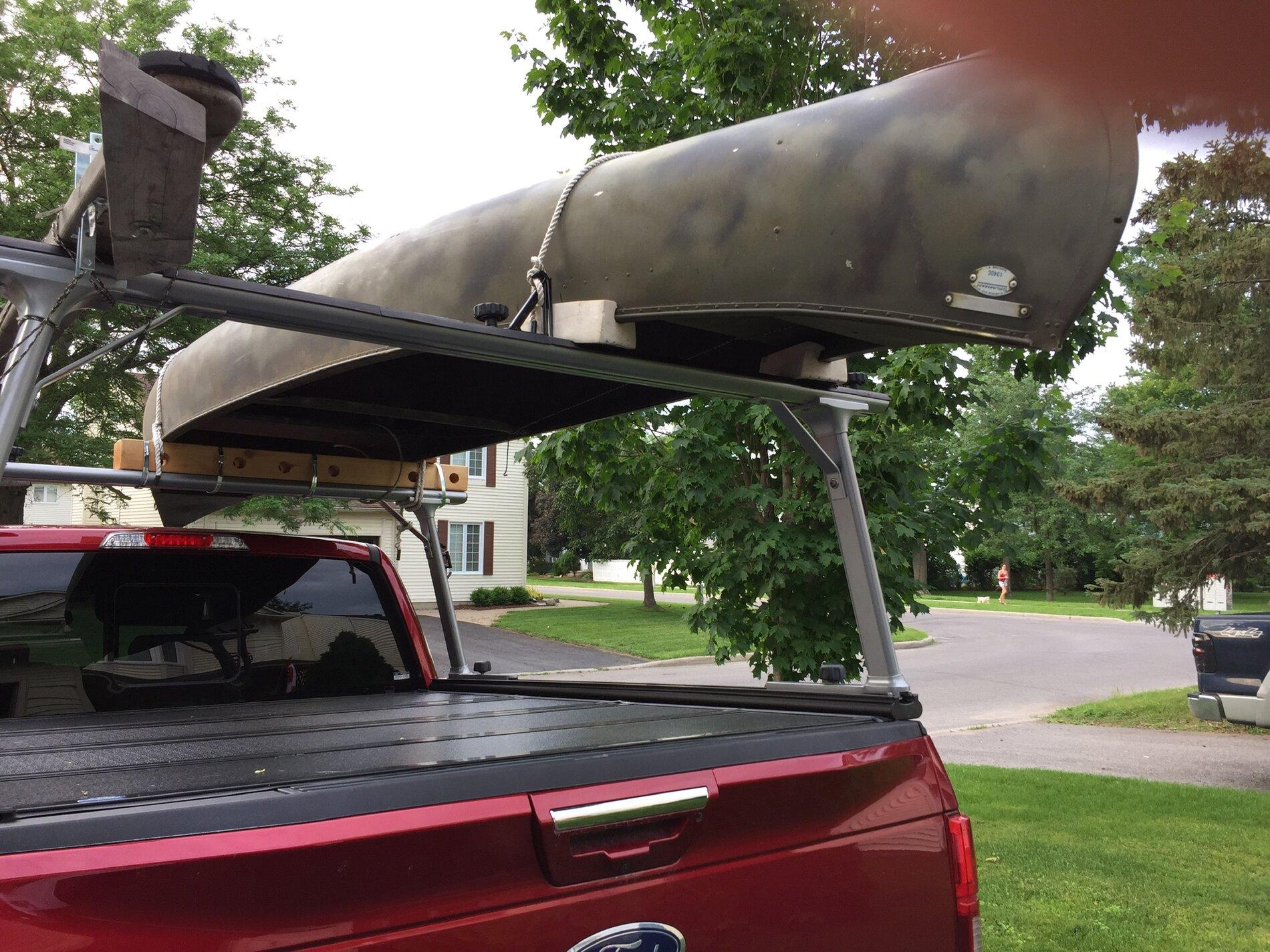

This is with a Ford quad fold cover from the factory, with a Thule rack. If this is the type you are looking for. The only issue here, the folding panels close to the cab are larger than the the other two, which prevents them from folding up flat to the window without the rack. A different cover mat solve this issue. Otherwise it allows access to the box.

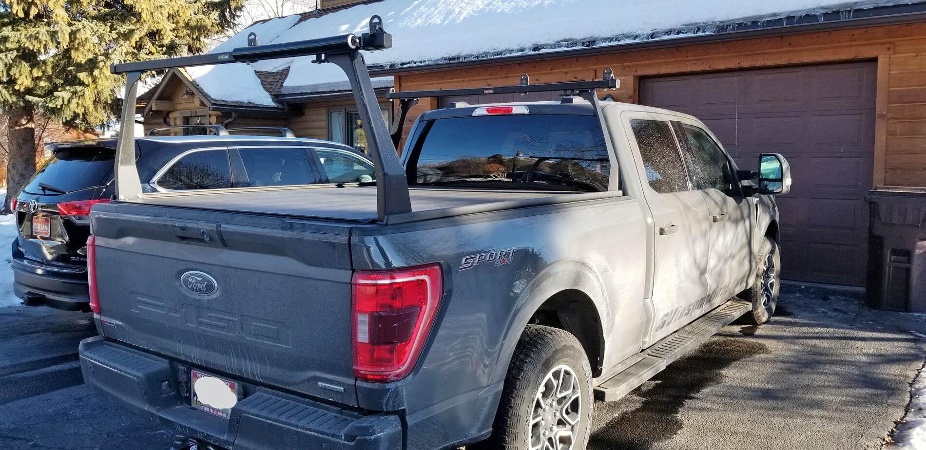

Ryan, I am also in Idaho snow-country and so far have had no issues with this setup
Adarac Controur rack with the Gator HR1 "hard rolling" cover.

Thanks Aaron. That’s actually the exact rack I was looking at. Looks like a really useful setup, supposedly easy to put on and off, and pretty affordable compared to other racks. That cover looks great too. Appreciate the feedback of it working well in snow country.
Looks like you have a long bed. I wonder if a family’s bevy of mountain bikes would still fit in the bed with the wheels over the tailgate with this tonneau cover in a short bed, or if the canister that the cover rolls into takes up too much room. I really like how this looks.

Oops, my bad. I mistook this cover for the retractable one, not the roll up one. So no canister...

I decided against the canister style covers since I also want to be able to load bikes, dirtbikes and other items straight against the front of the bed. That is a lot of lost space with the canister style.

Which Thule rack is this?

The Thule TracRac SR is a stake pocket rail system that works with existing tonneau covers (ex: BAK Revolution) - it's another option to consider. Compared to the ADARAC, it's very expensive. I have many Thule products - you certainly get what you pay for; unfortunately, after reviewing the Thule website, there are limited TracRac accessories available. The vertical uprights are not adjustable and only come in one size. I would appear upon first glance that the ADARAC is a better value.

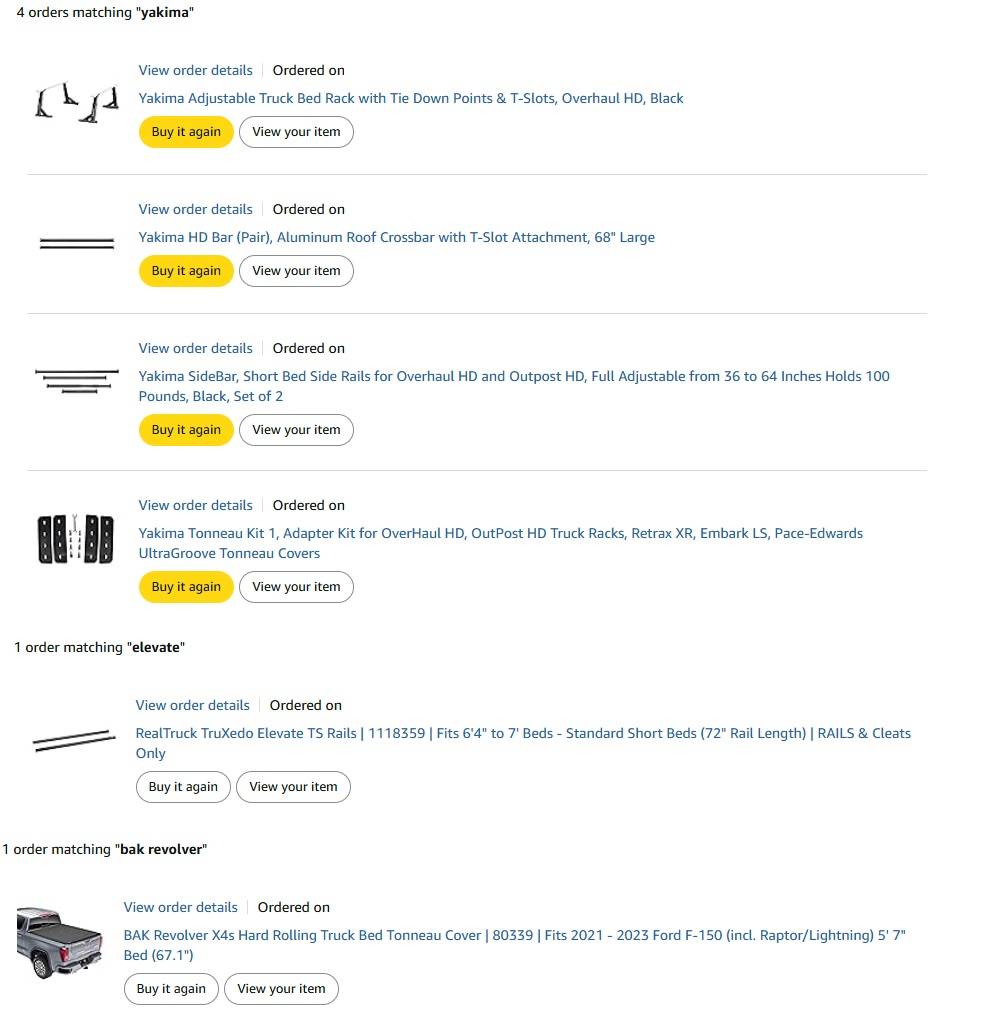

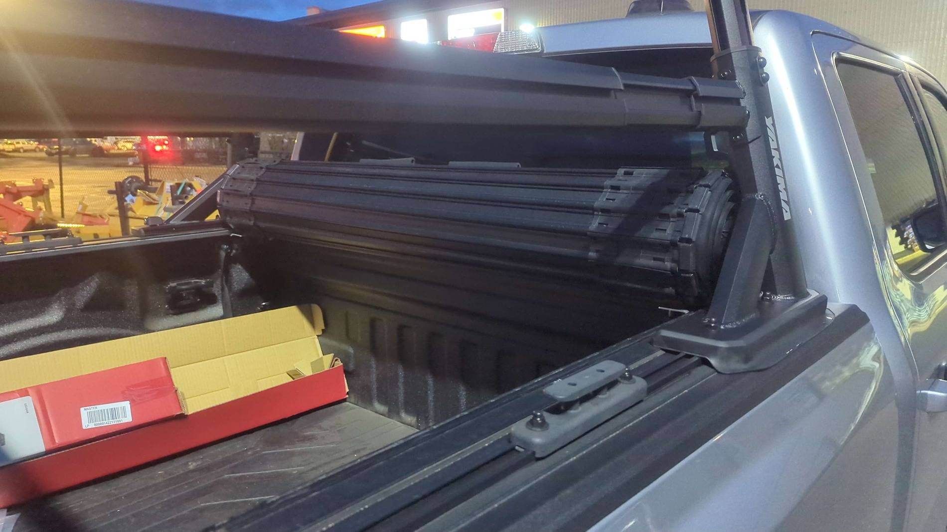

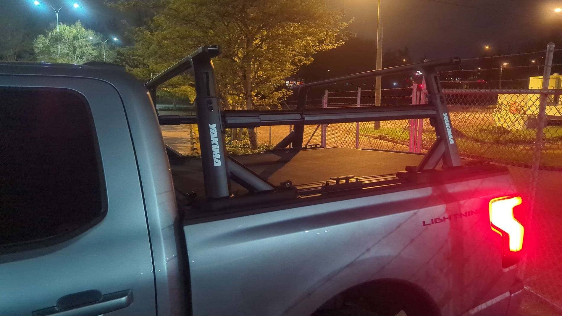

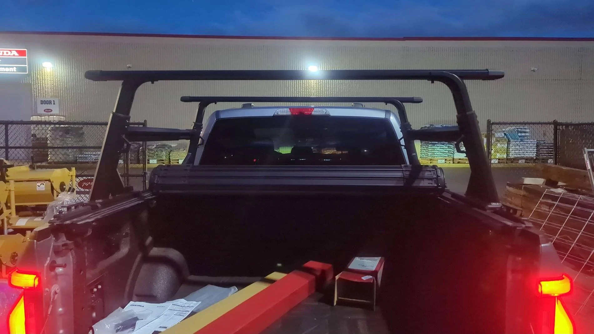

Im dropping this into a few threads that I found during my research but never able to actually see confirmed pictures for.
I have the BAK Revolver rolling tonneau, with Elevate TS rails (I got longer ones and cut them to size), with the Yakima HD rack. Exact orders detailed below.
Everything does indeed fit together. The rolling cover does barely interfere with the Yakima rack, but there is enough wiggle room to spread out the uprights to be able to roll the tonneau up all the way.
I got the short Yakima Sidebars, glad I did.
I also got the 68" Yakima upper crossbars, glad I did. 8" shorter is cutting it too close.
Have not noticed any range loss, but its only been a few days. Id estimate 0.1 miles/kwH gone. Tires should have more impact. I actually got a boost with just the Tonneau over stock so back to even.
