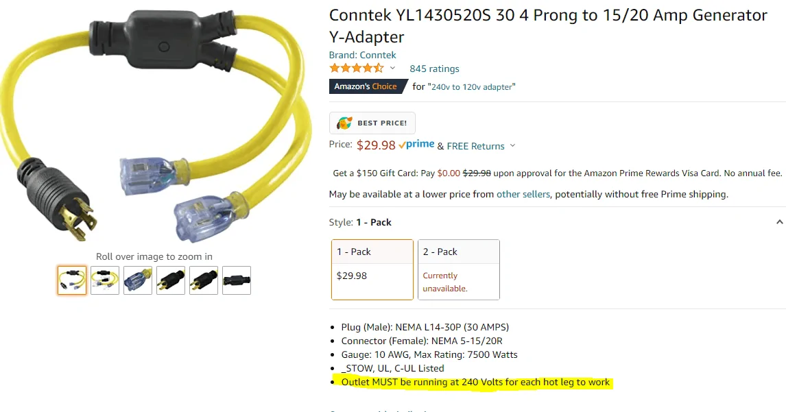

2 seconds with a meter or trouble light will confirm split.

So, going with something like this would basically give me 6 standard plugs off the truck, yes?

That adapter is an interesting candidate because it’s rated for 7200 watts. When you read the fine print for adapters similar to this one they frequently are rated only for 3750 watts—basically splitters. This one might actually tap both circuits. Good find.
Hopefully it has a built in circuit breaker so it is not a fire hazard. To get the full 7.2 KW you will need to balance your loads on each side.
What appliances are you trying to run? You would be surprised how much stuff you can turn on with 2000 watts. (Excluding driers, washing machines, dishwashers, and vacuum cleaners.)
I'm just seeing if a way to take full advantage and have the 7.2kw available. The way I understand it, you get 3,000 watts each or 6,000 watts total with the "standard" outlets. To get the full 7,200 watts, you need to be using the 240v plug which pulls from both. I'm sure the 6,000 would be fine in an outage. Now, I've read 3,000 each somewhere, but on the switch it says 2.4kw max. So IDK?

It is 2400W max for standard home receptacles (20A x 120V = 2400 W). You shouldn't exceed this even if the breaker/circuit can supply more because the wiring and connectors are not sufficiently sized for the increased amperage draw. If you do pull 30A from the 20A plug/cord, you are likely getting ready to set fire to one or more things in the circuit.
There are 30A, 120V (3600W) receptacles and plugs, but you probably aren't going to have them in your house since they're mainly on RVs. You can get pre-made cords to get 4800W from the 240V receptacle in the bed as mentioned, as it splits off the two hot legs into separate circuits. I have one in my truck made by Firman that I ordered from Costco, but there are several out there.
