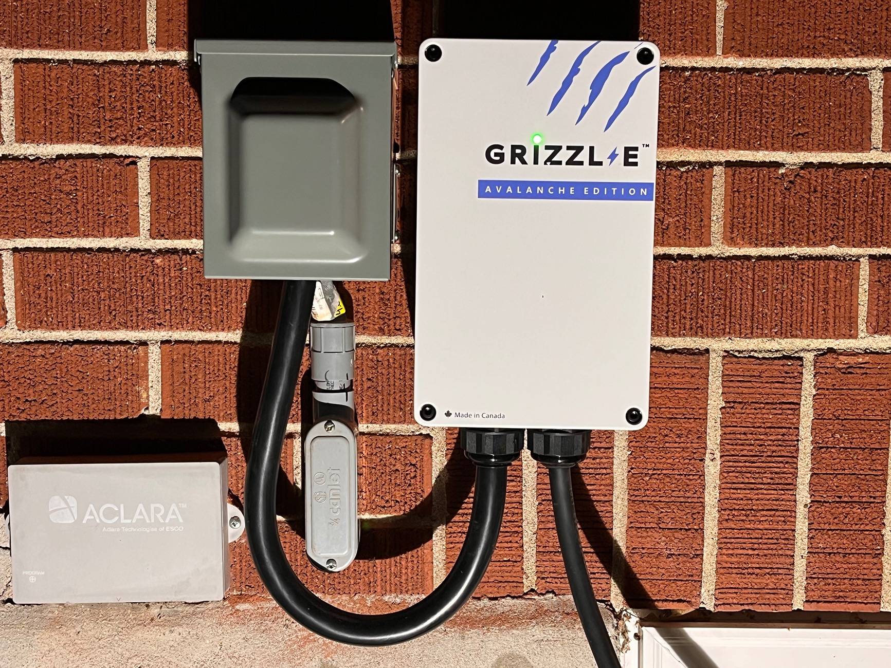

Decided on a new “Canadian” made (or assembled) Grizzl-e 40 amp dumb charger for $499.99 cdn on Amazon.

Ford F-150 Lightning Used Level 2 Chargers - Would you do it? IMG_2663
Ford F-150 Lightning Used Level 2 Chargers - Would you do it? IMG_2673
