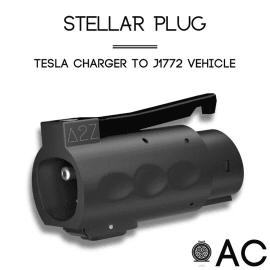

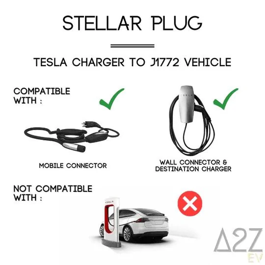

Lots of folks use a NACS Level 2 charger / Tesla destination chargers and pair it with an adapter to use it on their vehicle with J-1772 plug.
I would recommend the A2Z Stellar NACS to J-1772 adapter which is available for $88, compact build, has a built in lock, good customer service / warranty and overbuilt for futureproofing.
Discount promo code “FORD” is still working and free shipping is also available.
A2ZEV NACS To J1772 adapter (Hotel Destination Charger for Hotels / Shopping centers) | Up to 80A | 20kW | 12 Months Warranty

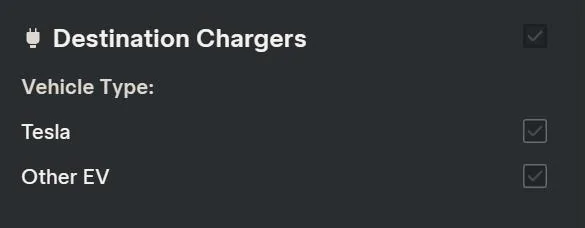

You can use the same Tesla Find Us link to locate Tesla Level 2 destination chargers.
Ford F-150 Lightning Tesla destination chargers level 2? 1742960470000-hf-jpg
Tesla Find Us Superchargers available with adapter / Magicdock location Chargers

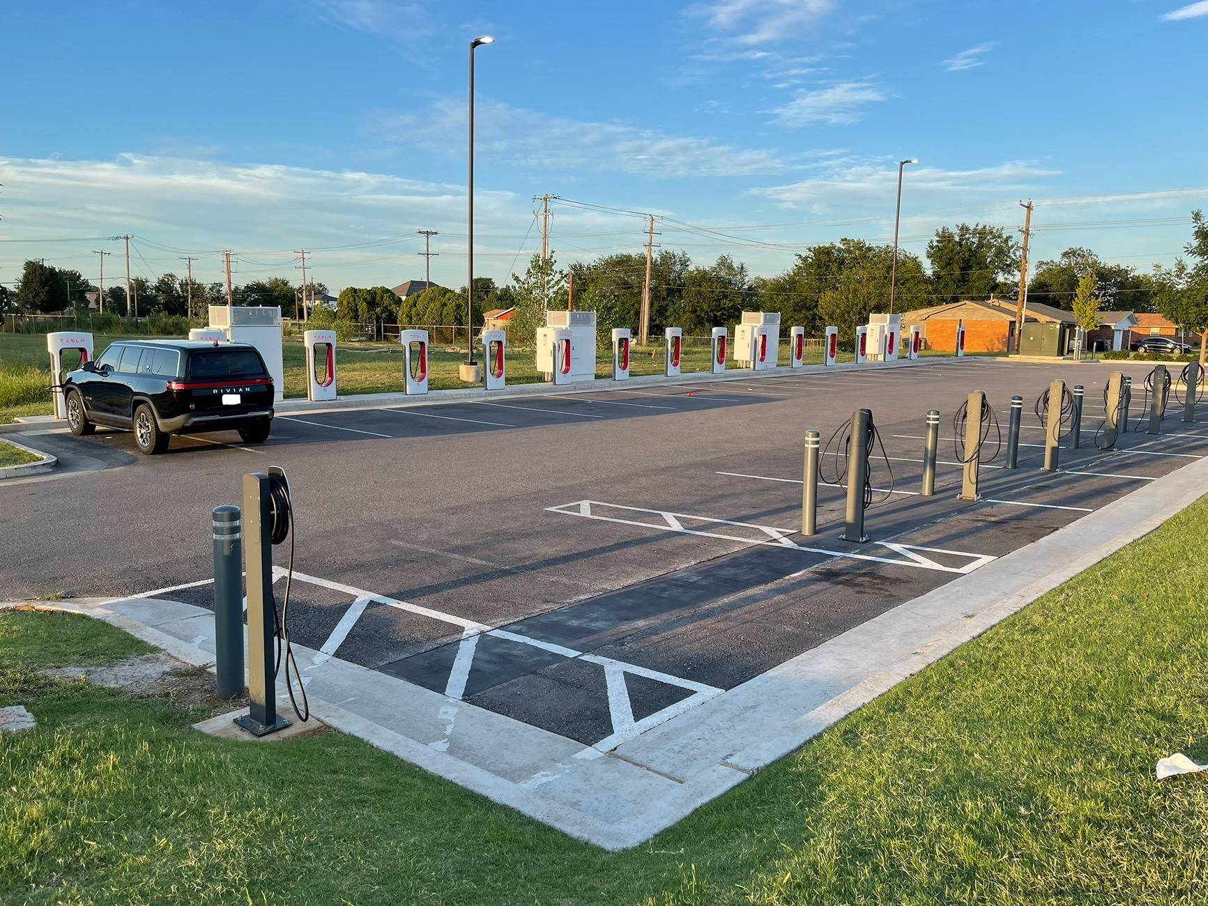

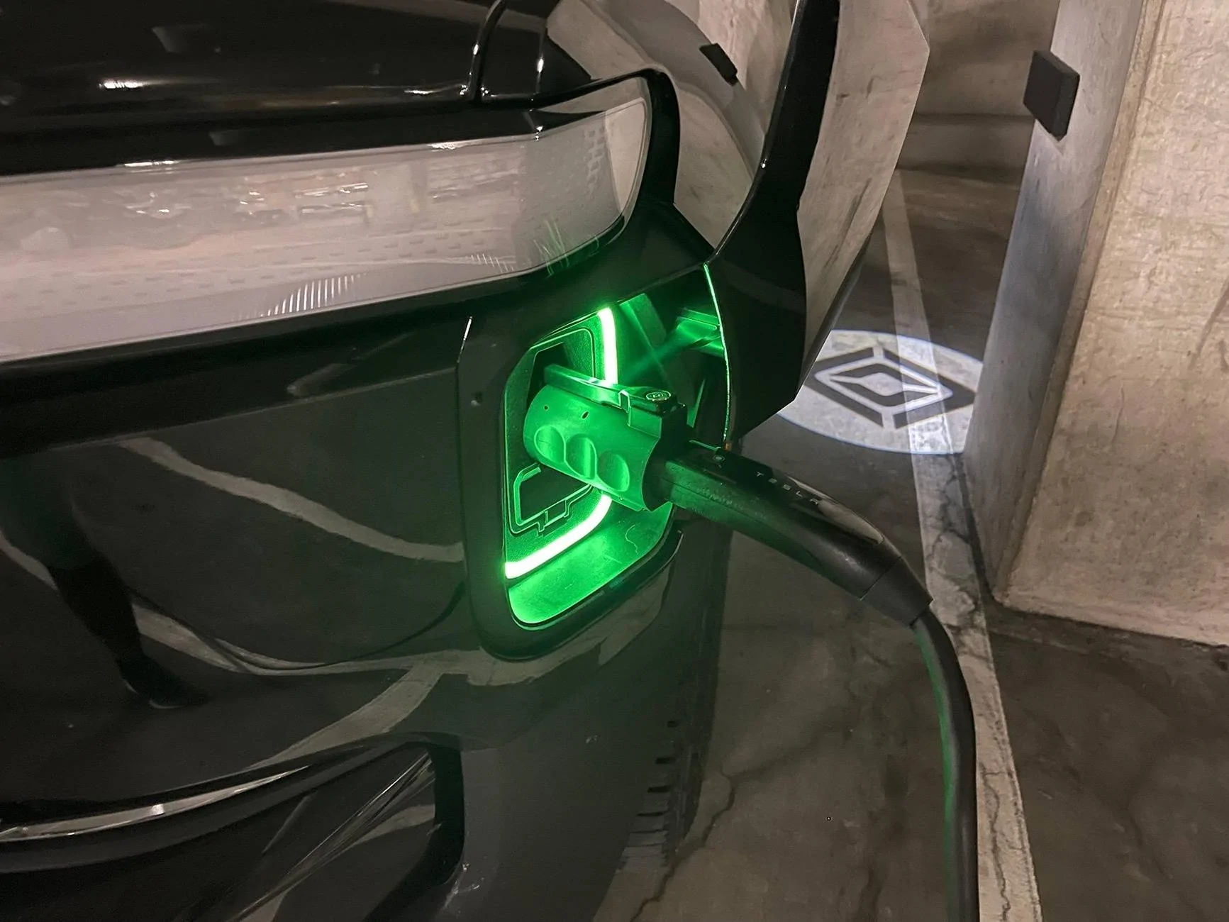

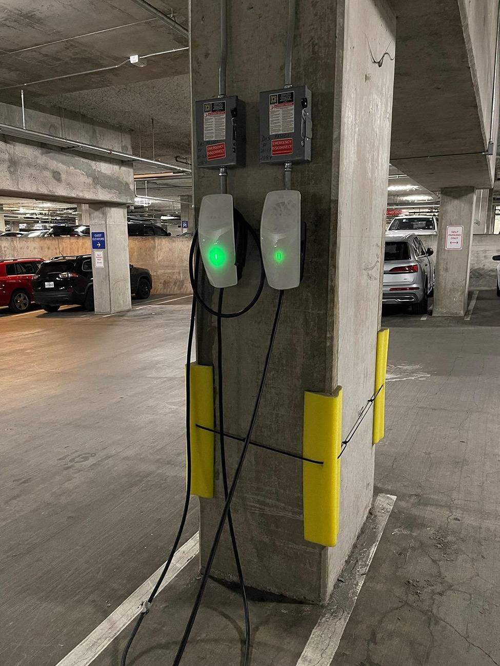

Here is a good example of 10+ free level 2 AC Tesla destination chargers 8 kW - 16kW charging available at a grocery store only if you have an adapter. This is commonly found at malls, shopping center, movie theaters, etc.
The Rivian you see is using DCFC level 3 with an adapter
