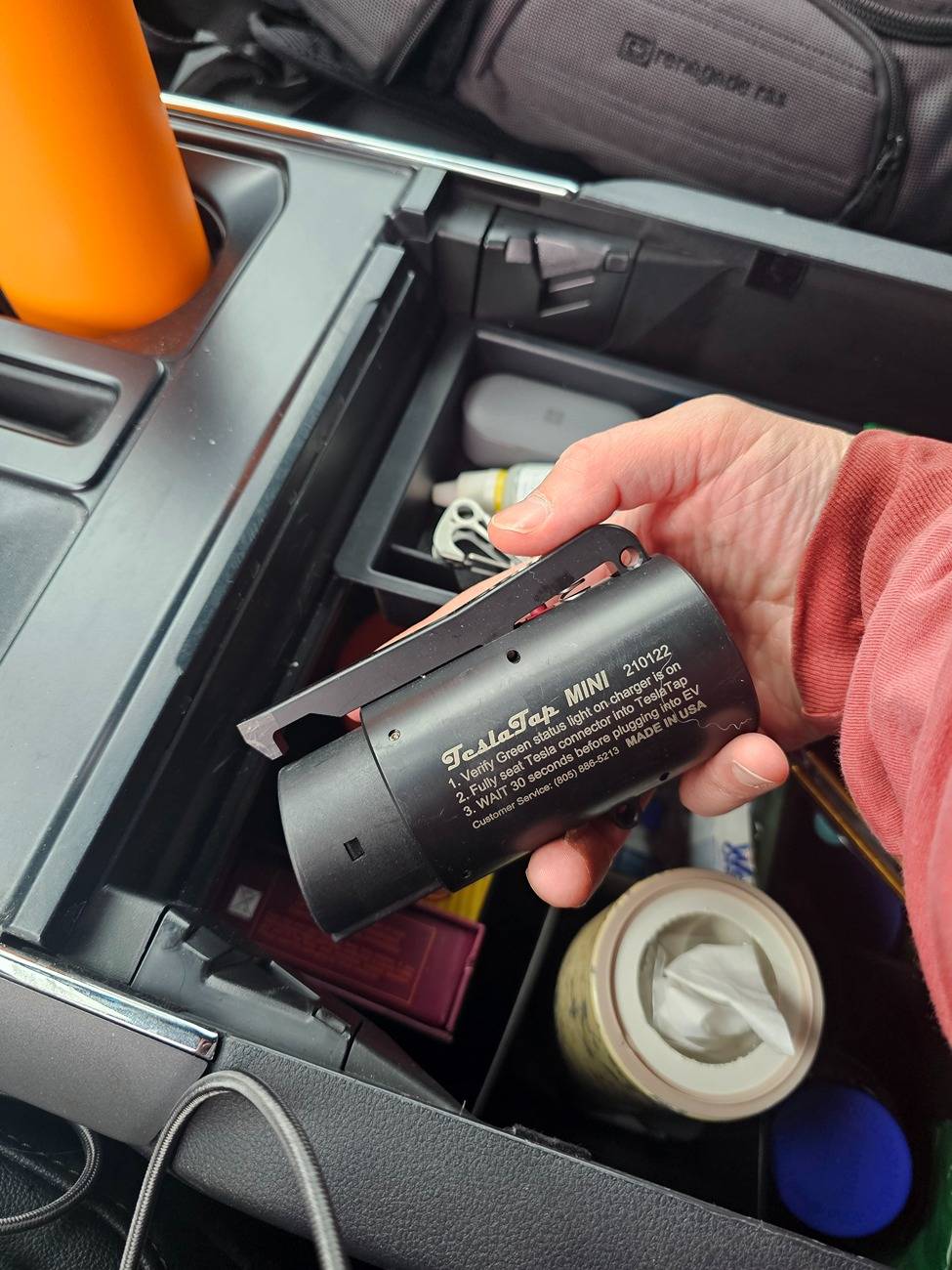

The Tesla Tap Mini is the way to go. I have kept one in my Mach-E for the last four years and my Lightning the last 2.5 years. They come in super handy. https://a.co/d/4fRuGtZ
