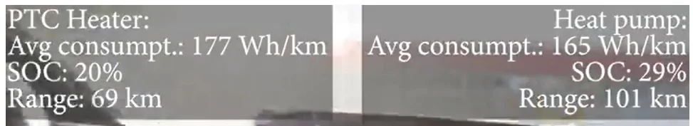

Just a thought:
Ford added heated seats to the Pro just to claim 10 extra miles (4.2%) on all SR trims in 2023. If the heat pump makes a difference of 4.2% or more, wouldn't they adjust their range estimates? They were desperate enough to add heated seats to a trim.

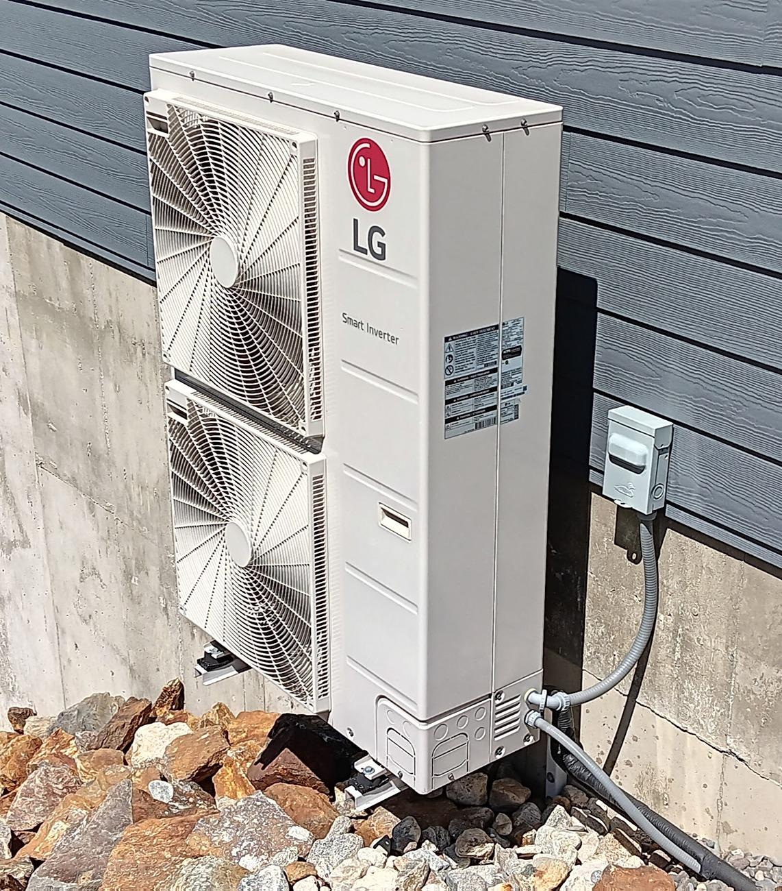

That’s going to be a pretty big unit. It’ll need to be 4x the capacity of just an air conditioner.
Why would that be? I don't know how to calculate heat loss for a moving vehicle, but for residential applications, cold-climate or "hyper heat" vapor injection heat pumps have about 1.3X the max (not "rated") heating vs cooling output compared to cooling-only models. In my climate, with a cooling design day around 90F, you're right that's still more cooling than is needed, but it's not 4X as much, and there are a lot of places in North America where it's much hotter than here.
