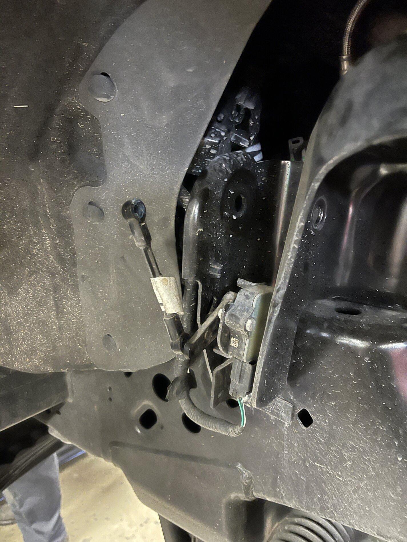

There is a sensor on the front driver side as well. I’m told the sensors are for ABS
Maybe something to do with the Roll Stability Control?

Those height sensors are only for the headlights on trucks without dynamic suspension. They are only on the driver side front and rear.
Trucks that are 21.5 and have the onboard scales and VDM they are at each corner and built into rear shocks. Then they are for the scales and the headlamps but their signal feeds to the vdm and the vdm sends the height info to the hcm.
Not for ABS at all - for headlight leveling
