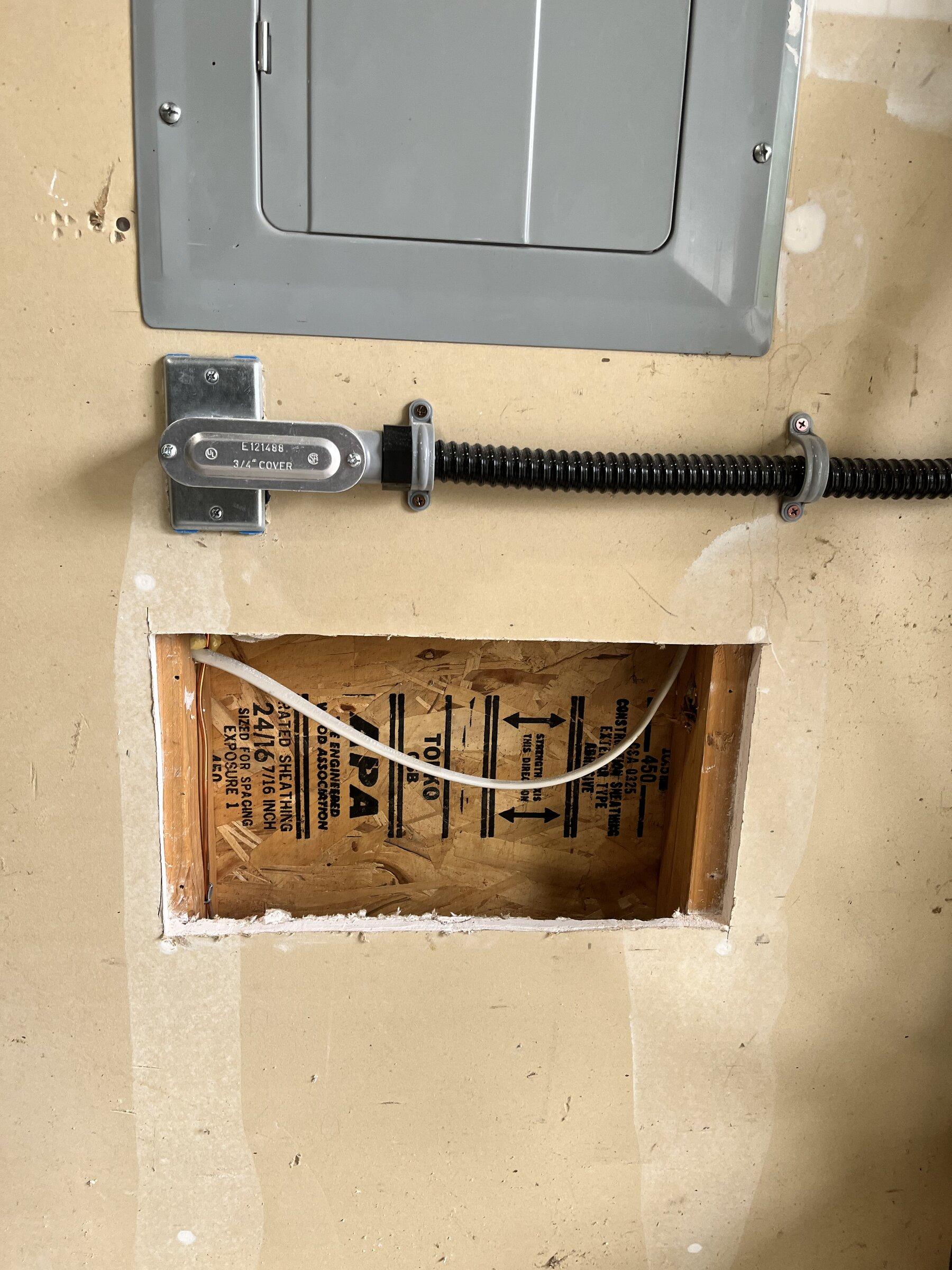

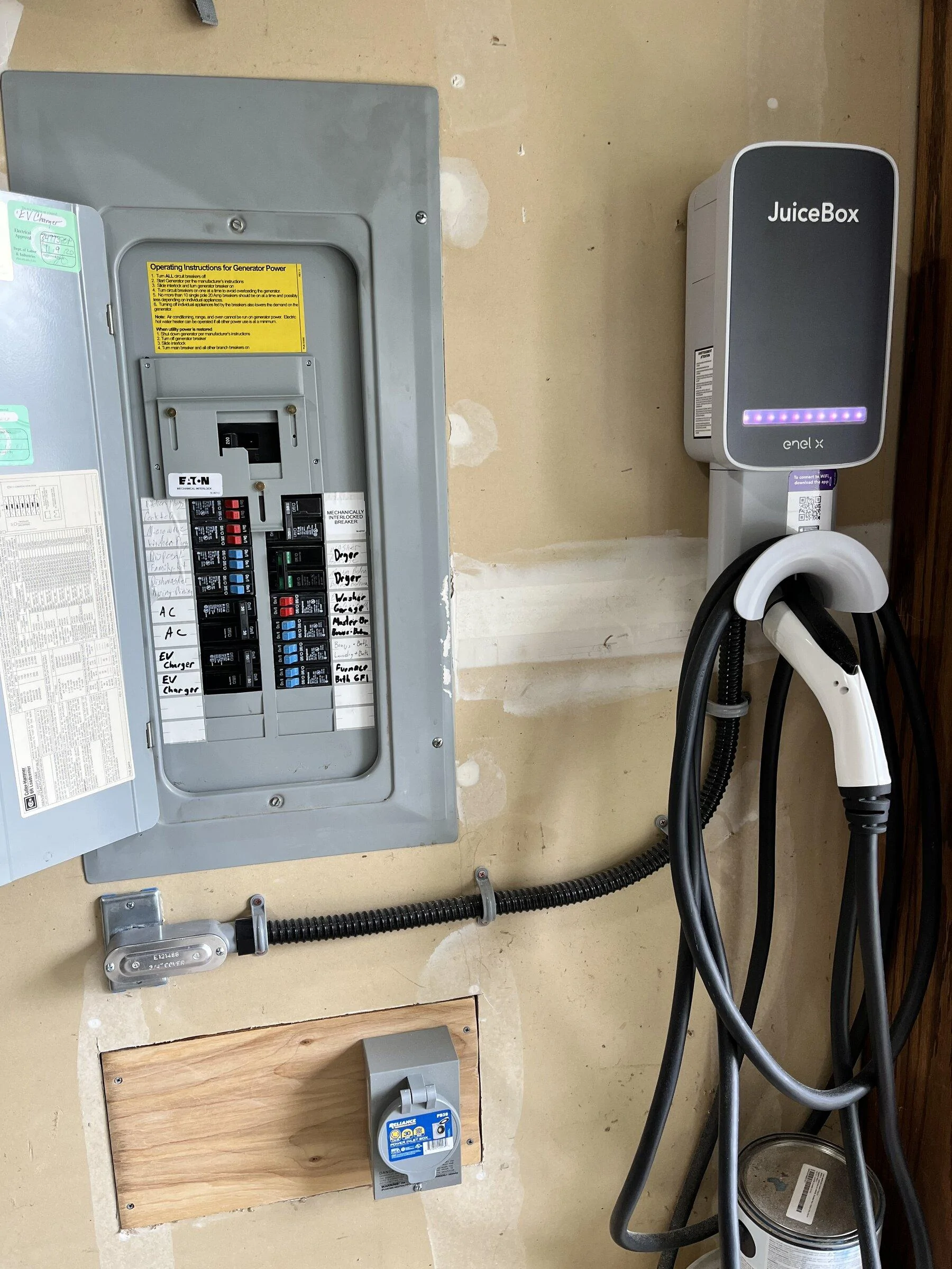

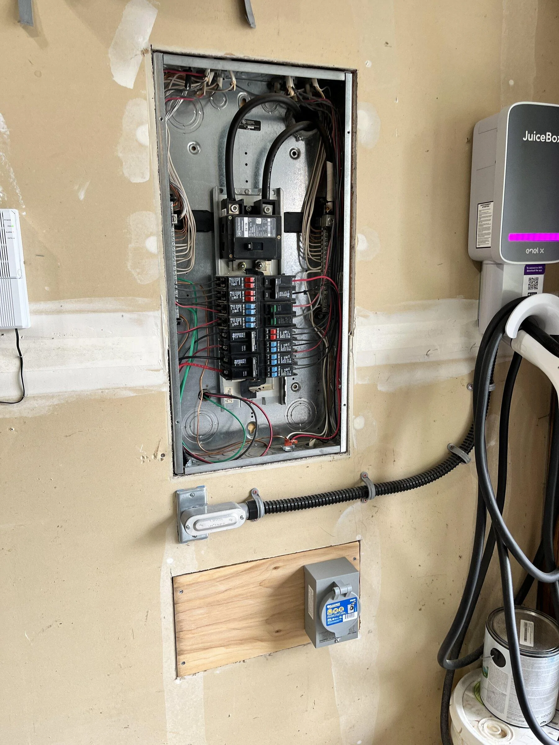

It’s happening, the Lightning is real so have to prepare. 5/16 blend date. Today installed an interlock kit (inlet, breaker, panel interlock). About $200 in parts. Installed the EVSE for the Mach E a year and a half ago.

And lots of people had problems with ground faults with their hybrid F-150s until they got a bonded neutral added to the interlock.

Yeah no... that's not going to work man :( Tons of threads already on this, you need something to lift the neutral like a Generac 6852 or 6854.

This video shows why a interlock will not work. I should note the follow up video TFL truck did to get the interlock to work is highly advised against. The same issue encountered with the powerboost will be encounter with the Lightning.
https://tfltruck.com/2021/08/video-...se-with-a-pickup-truck-maybe-its-complicated/
It does work at protecting linemen (linepeople?) From getting a shock, just not at allowing the Lightning to feed power in (without lifting N-G bond at least).

Generac homelink is the cheapest option I’ve found. Like others have said, panel neutral needs to be unbonded from earth ground for the lightning to work on your house. No interlock.
