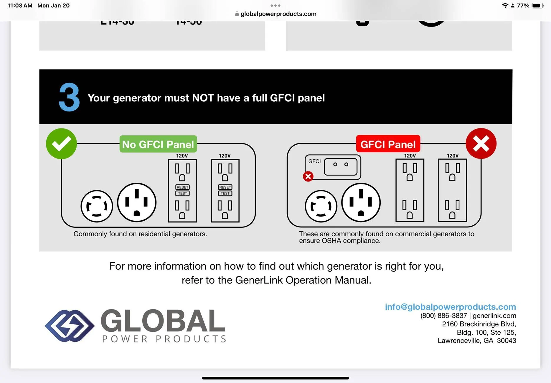

As many others have eluded, you would need to leave the ground from the truck disconnected from the house panel to mitigate the truck's GFCI tripping. I recommend a dedicated "generator cable" with the ground disconnected on the house end of the cable and marked clearly as such. That way the truck's ground protects the cable (for example if someone runs it over with a lawn mower or water gets in it). And the house panel and protections will all continue to work safely as designed. There will be NO loss of any existing protections (overload, GFCI, AFCI, etc) on the house panel.
That is the solution that works with my installed interlock bypass kit. https://interlockkit.com/
