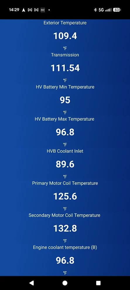

Looking at the Temperatures page on CarScanner, two questions.
First, what is "Transmission" measuring?
Second, can anyone confirm my assumption about Min and Max HV battery temperatures. I assume there are multiple sensors and these two numbers are showing the range of temperatures for those sensors. Is that correct?
Ford F-150 Lightning What are these CarScanner fields measuring? CarScanner temperatures

Transmission measures the transmission temperature. It is a single-speed gearbox attached to the motor that "transmits" the motor's rotational power to the drive shafts through a series of gears. It has a maintenance oil-change frequency of 240,000km (150k mi) and has a filter as well. We have two (one for each motor), so your screenshot is only showing 1 - probably the front.
I believe you are correct on the second point; however, others may have better insight on that.
